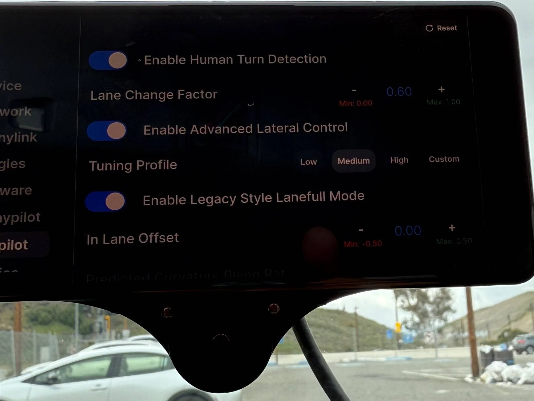

Definitely going to need some help on settings. This thing is making me sick the steering wheel is just going back and forth in the lane.

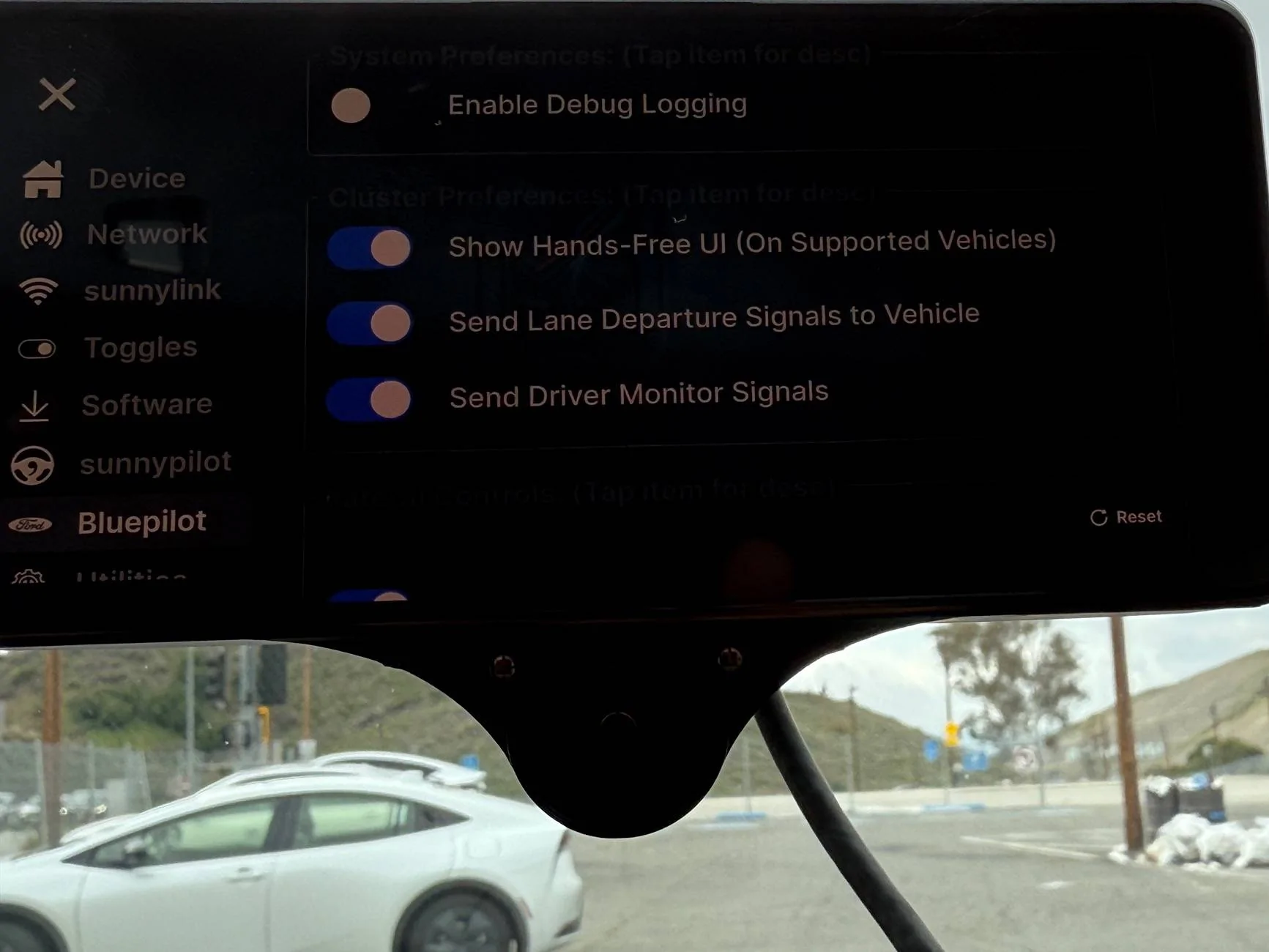

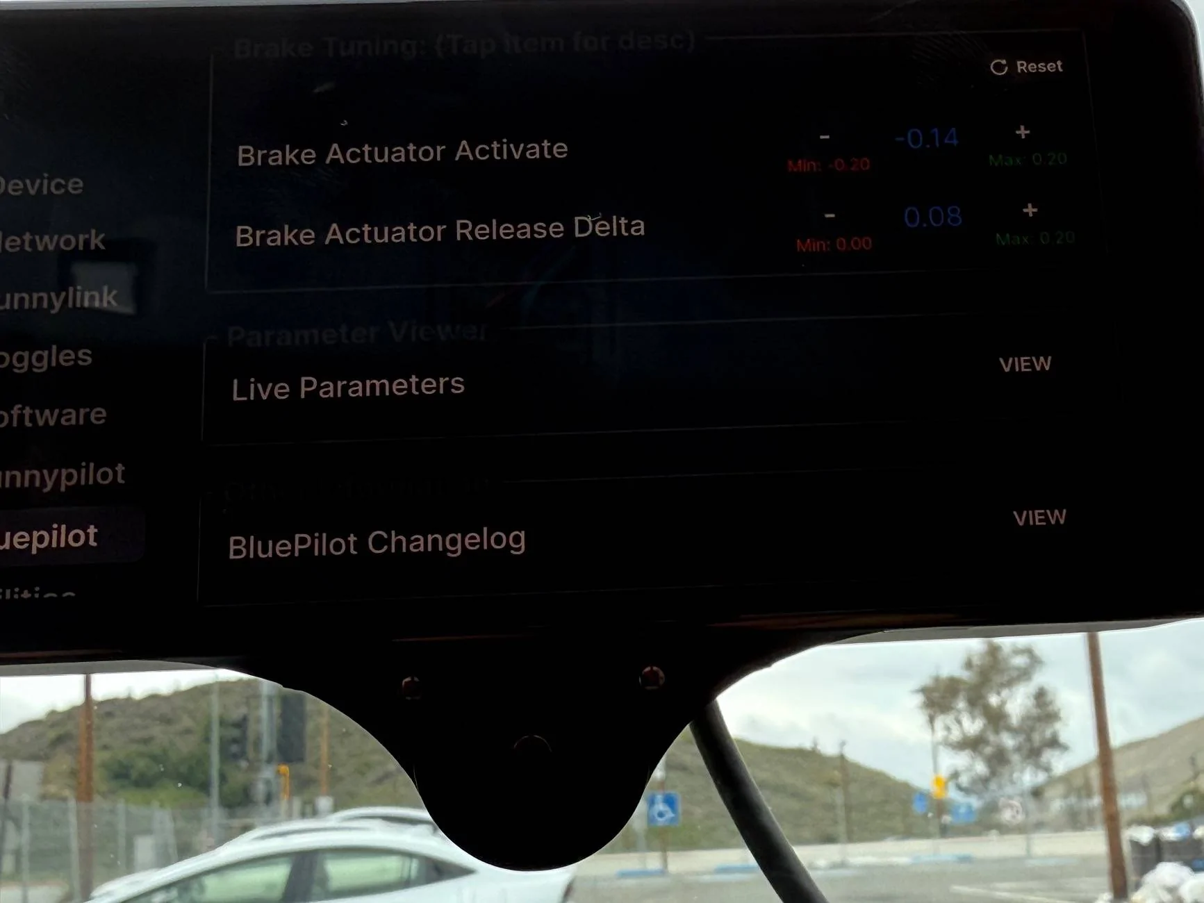

Post pics of all your settings

Ajzride
Alan
Jun 6, 2021
833
944
Houston
Eng
Those are your lateral settings.
change tuning profile to low.
post pictures of the “toggles” page for long tuning.

Ok. Just sat down to have lunch. Then I will send those other pics. Do any of the settings you mentioned have anything to do with the acc braking?

No. The only relevant settings you sent pics of are for steering. The two brake settings you took a picture of do not affect the issue you have. You don't want to change those two unless you know exactly what you are doing. They are only changed if the truck doesn't do what we ask it to do. Your problem is that we are asking the truck to do something too aggressive, which is a different section of settings.
