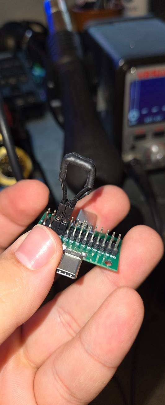

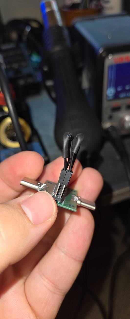

I originally mutilated a thunder bolt 3 cable and added resistors as needed. I went to a funeral over the weekend out of state and the boards were in by the time I made it back, just finished this today.
I shortened my jumpers so I can leave it installed and test it out. I was mostly stuck on the pcb design as I'm not an electrical engineer by any means.

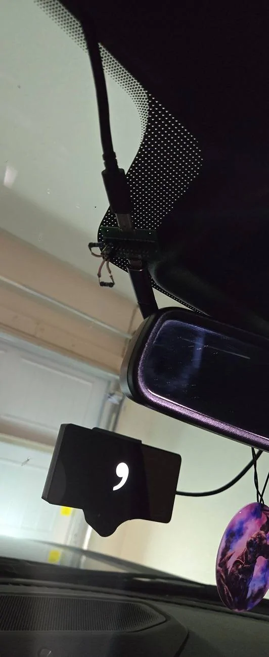

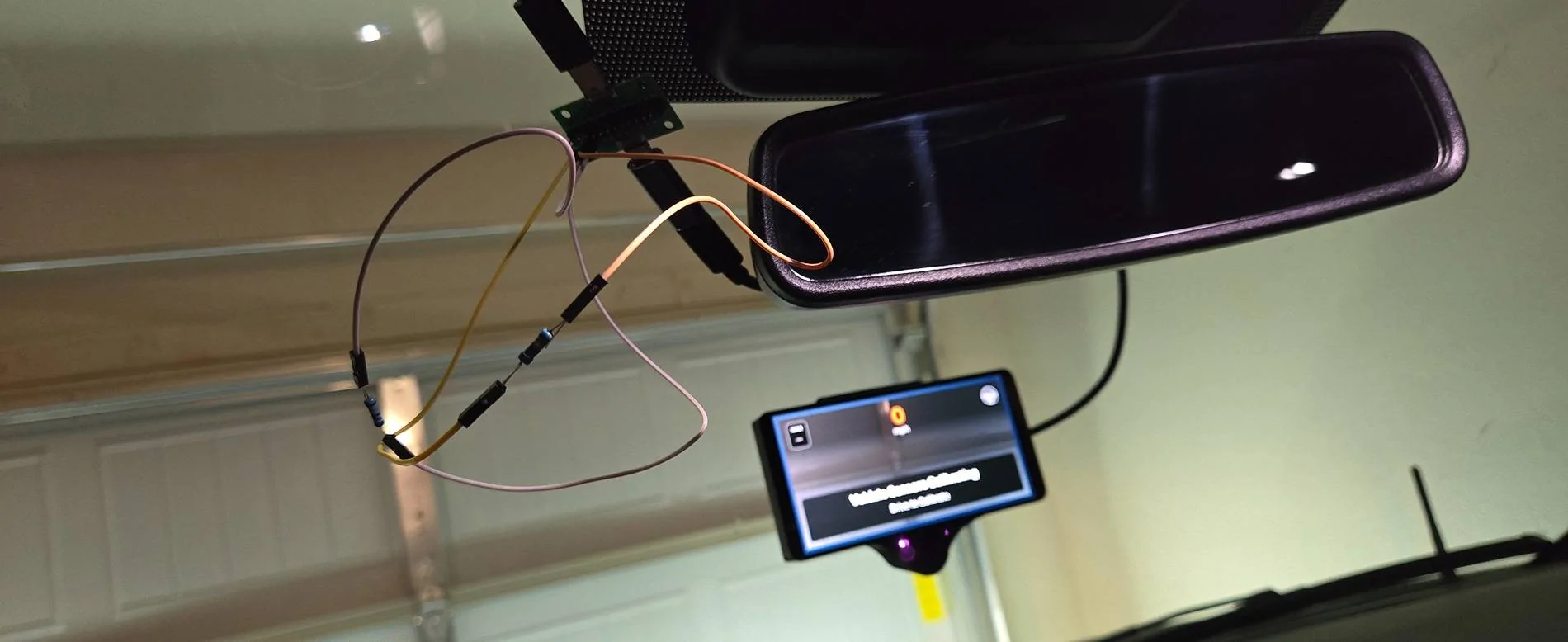

Just adding this in case anyone wants to get rid of the can bus errors and doesn't already have the custom harness. This is to be done at your own risk as I have only tested it for about 50 miles so far.
You just need these breakouts https://a.co/d/hFHdHoM as well as these resistors (as suggested by @Ajzride) https://a.co/d/h7GIwWR.
All you have to do is bridge B2 to B3 and A10 to A11 with the 62 ohm resistor on the breakout board. I would strongly suggest cutting the wire down as much as you can and solder the resistor into the wire. I would also not suggest you use this as a long term solution, but could save you from spending more or modifying your existing harness while the PCB gets worked out.
Everything you need outside of the resistors and what you need to solder is included in the kit.
