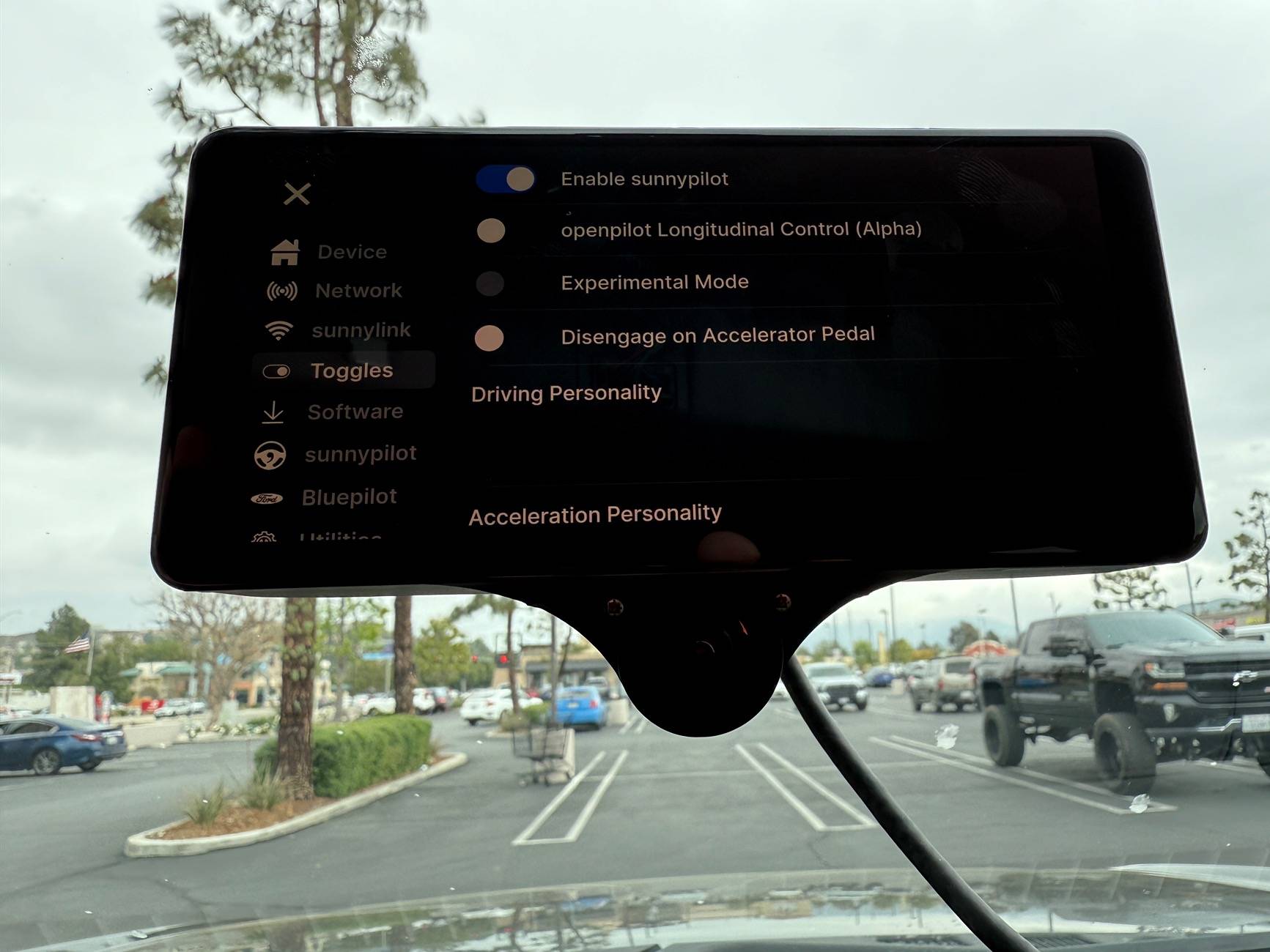

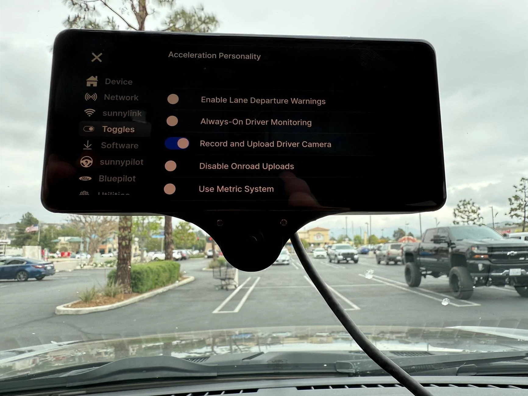

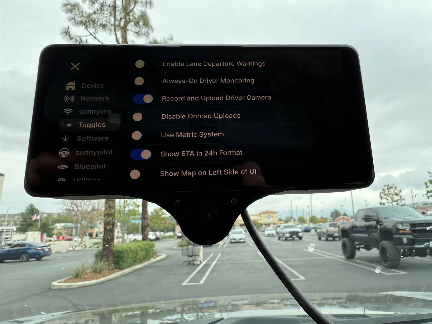

Those are your lateral settings.
change tuning profile to low.
post pictures of the “toggles” page for long tuning.
Here is the toggles.
Ford F-150 Lightning Comma AI self driver assistant IMG_1035
Ford F-150 Lightning Comma AI self driver assistant IMG_1033
Ford F-150 Lightning Comma AI self driver assistant IMG_1034
Ajzride
Alan
Jun 6, 2021
760
766
Houston
Eng
you Are still using ford ACC. Toggle on “enable openpilot longitudinal control”
set your driving personality to “relaxed”

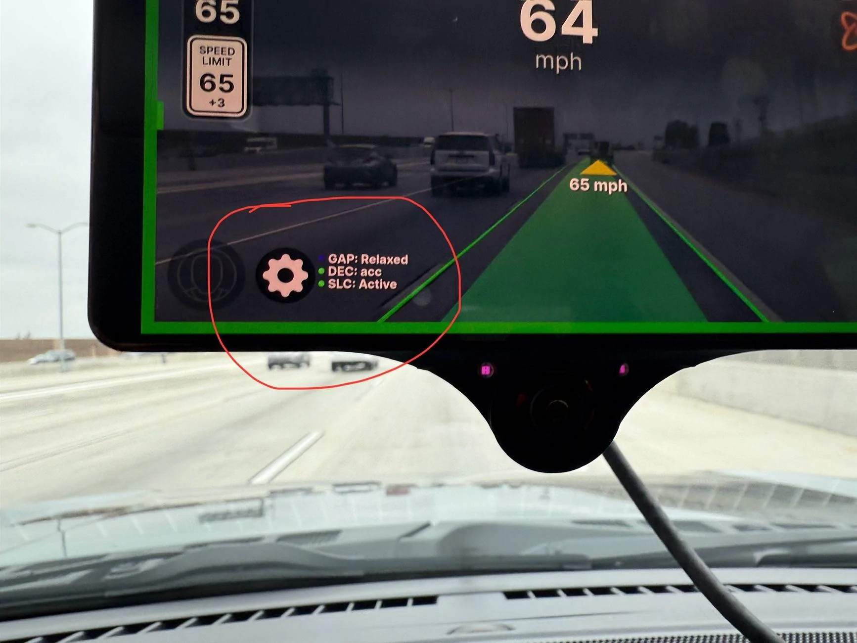

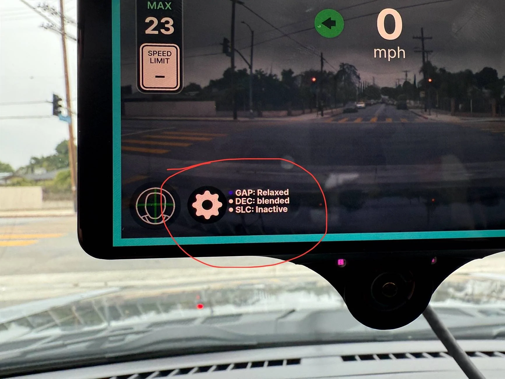

So wonder what this means? When cruise is on but cancelled it says blended. When cruise is on it says acc. Does that mean the when on cruise it’s not using both camera and radar or is that something else?
Ford F-150 Lightning Comma AI self driver assistant IMG_1041
Ford F-150 Lightning Comma AI self driver assistant IMG_1040
Ajzride
Alan
Jun 6, 2021
760
766
Houston
Eng
DEC blends ACC and experimental mode. It has nothing to do with radar / vision.
DEC exists because experimental mode likes to drive 10mph under the speed limit.
