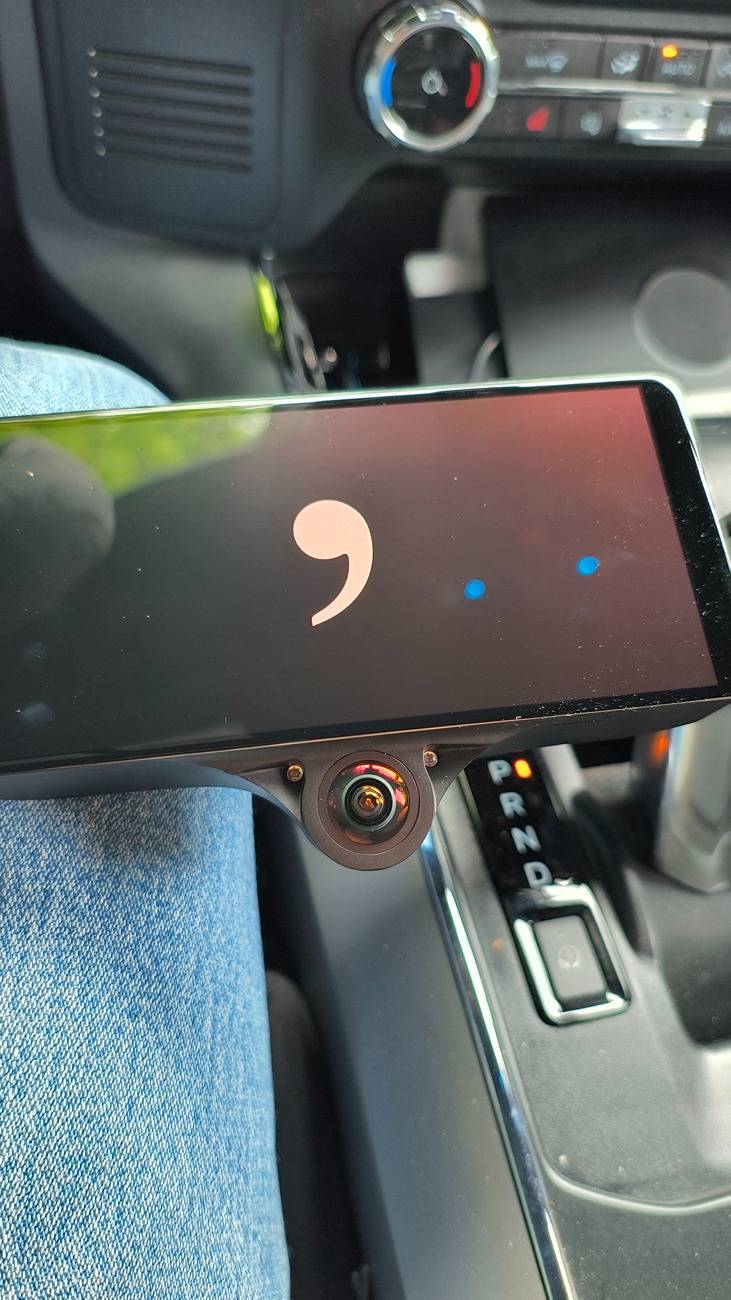

My comma3x is stuck on the large comma boot up screen. I uninstalled blue pilot 2.1, then installed 3.0. After 3.0 finished, it said it needed to update. I clicked the proceed and that seemed to successfully go through its process too. On the reboot, it just sticks on the comma screen. The 3x does not seem to have any physical buttons on it, is there any way to force a reboot? I've tried unplugging for about 5 minutes and plugging it back in but it's still sticks on the comma screen. Google searches have come up empty.
There is something wierd goign on with the 3.0 update. Everyone seems to have to do it twice. I think it has to do with order of operations in the OS update.
Unplug it, wait 30 seconds, plug it back in and tap the screen while it is booting, that will trigger a factory reset
Thank you! That worked. I was tapping during the wrong time apparently.....
Back to 2.1 it is....

no, install 3.0 it will work the second time

Well whaddya know.... 2nd time's a charm. Thank you for all of the hand holding.
The problem is that the OS must be installed before the fork. When you install it using the URL, it installs the fork, sees you need an OS upgrade, and then applies that. So then it is stuck. Installing a second time installs the fork, and the OS is already installed, so you are good.

Uninstall from the "software menu"
when it reboots, use the custom URL:
installer.comma.ai/BluePilotDev/staging-3.0
If it hangs at the boot logo, then power cycle and tap the screen during boot up until it asks if you want to factory reset. Choose yes and repeat the install.
