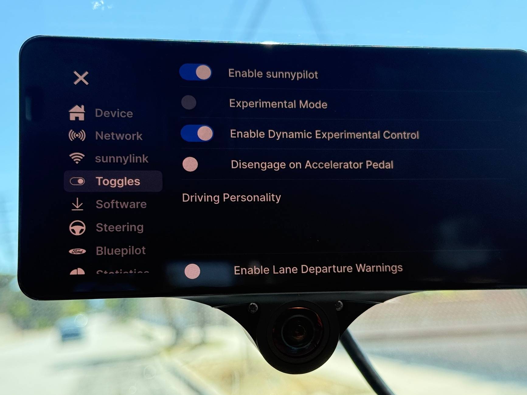

Did the update. Had to do it twice as you said. Tried to turn on experimental mode but it’s greyed out.
Developer Menu —> enable SunnyPilot longitudinal control

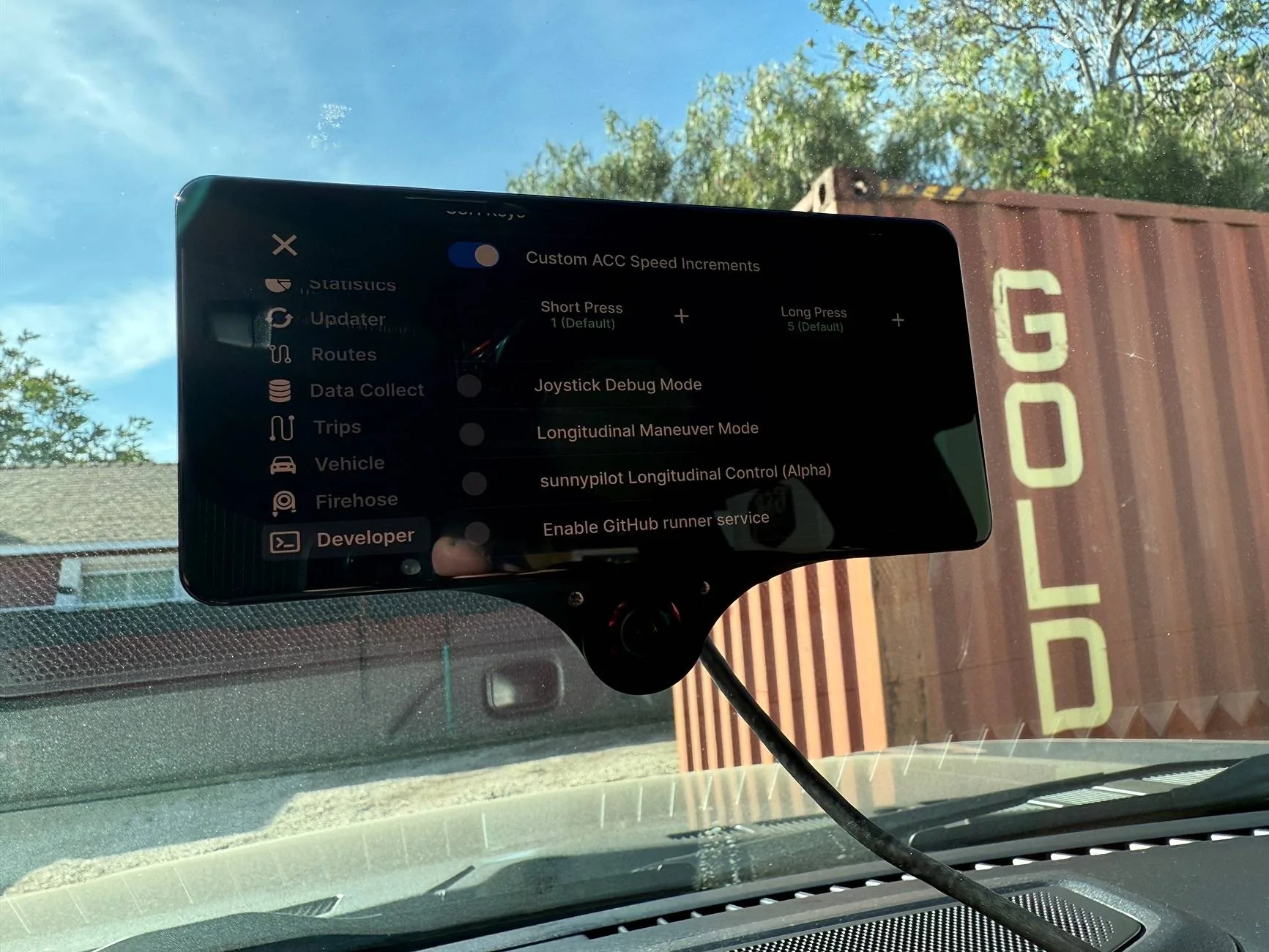

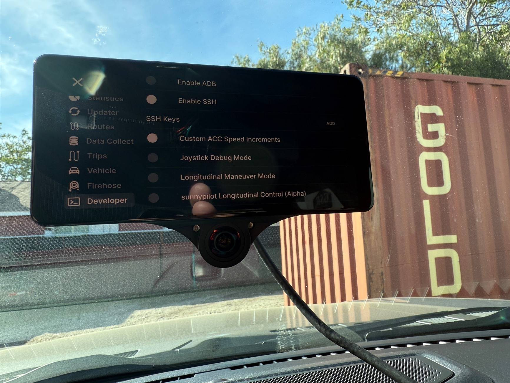

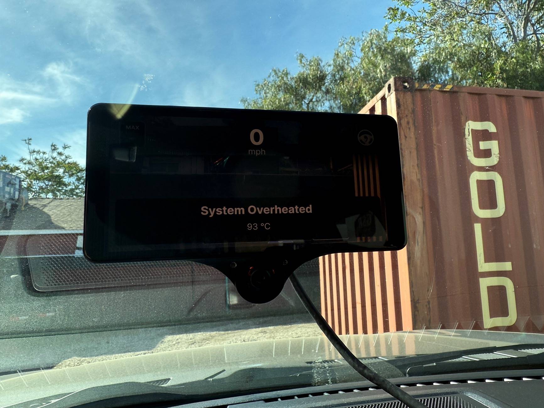

No joy. It’s greyed out. Also is this thing just not going to work in the summer? It’s 100 today in LA but it’s o. The windshield. So it’s always going to be really hot.
Lots and lots of guys having issues with overheating lately. I wonder if Comma got a bad batch of fans or something. You're the 4th one this week having issues. It should work fine, I use it in the Houston summers where the ambient gets over 102 for weeks at a time.
The vehicle has to be powered down to toggle sunnypilot longitudinal control
I've heard rumors the overheating might be software related, I'm going to go do some research.

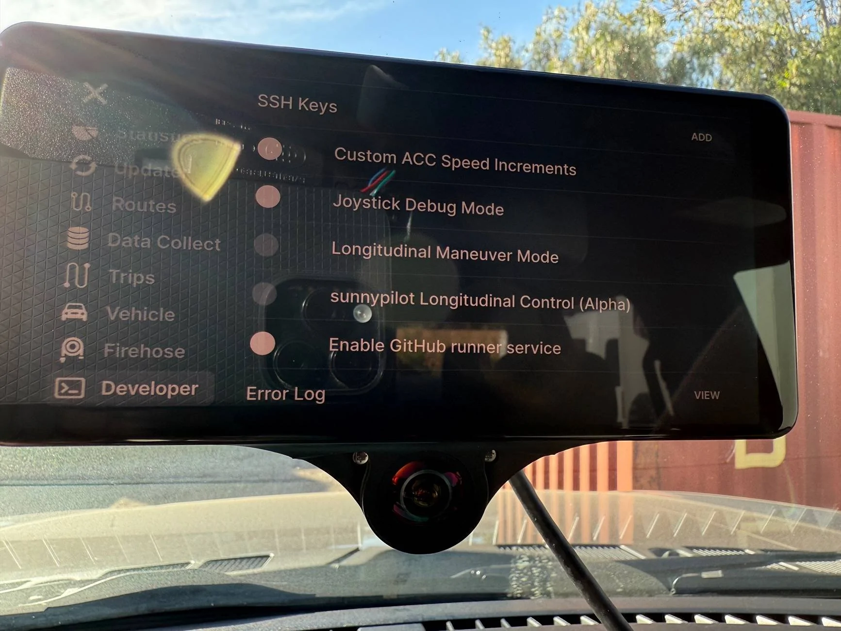

Mine did come back on. I did not know it had a fan. I hung a microfiber over it to keep the sun off it. Can you link the easy removable mount for it you talked about in the video. I need something like that. Also even with truck off I can’t turn on that setting. It’s still greyed out.

I chose 2022-23 f150 lightning
Hmm, that should let you toggle long control On. The truck has to be completely off, not in accessory mode.
? I turned truck off but the RAP was still on since I had not opened the door. Maybe that was the issue?
Very likely could be. Comma uses the power to the rear radar modules as the "vehicle is on" signal.
