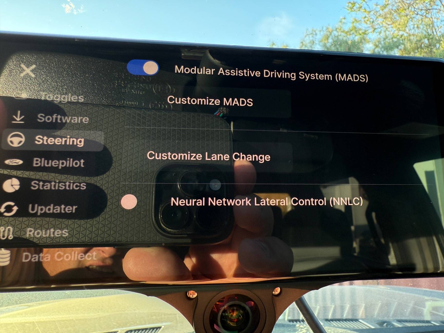

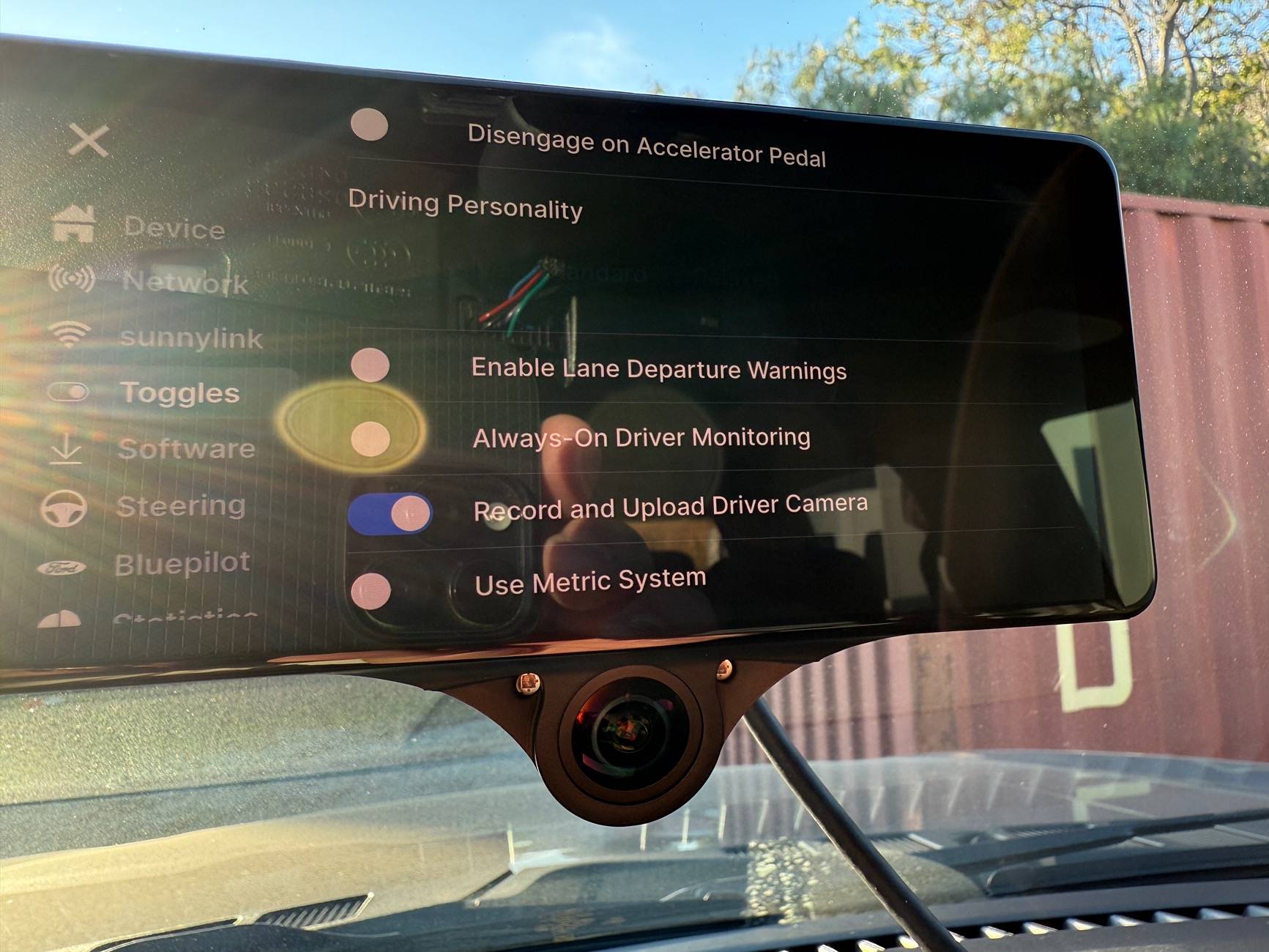

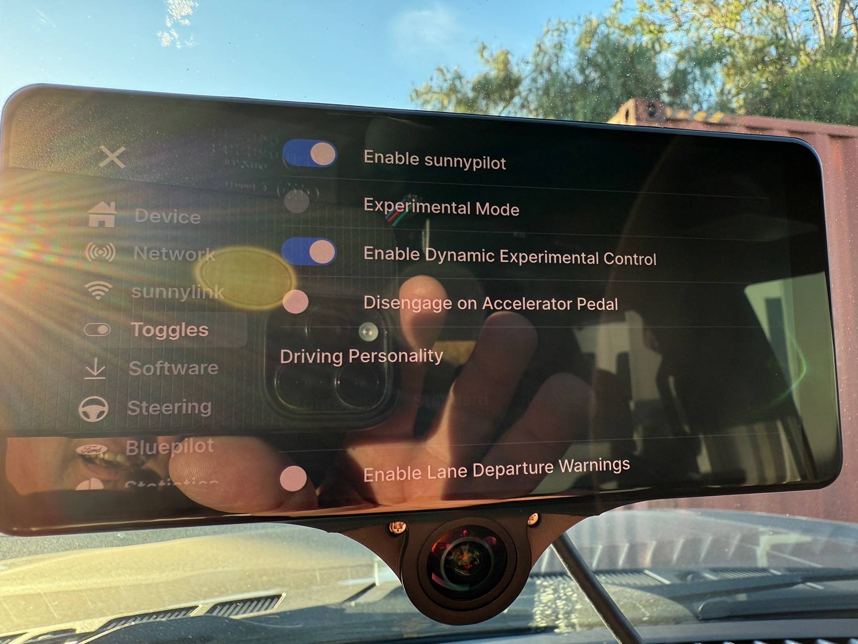

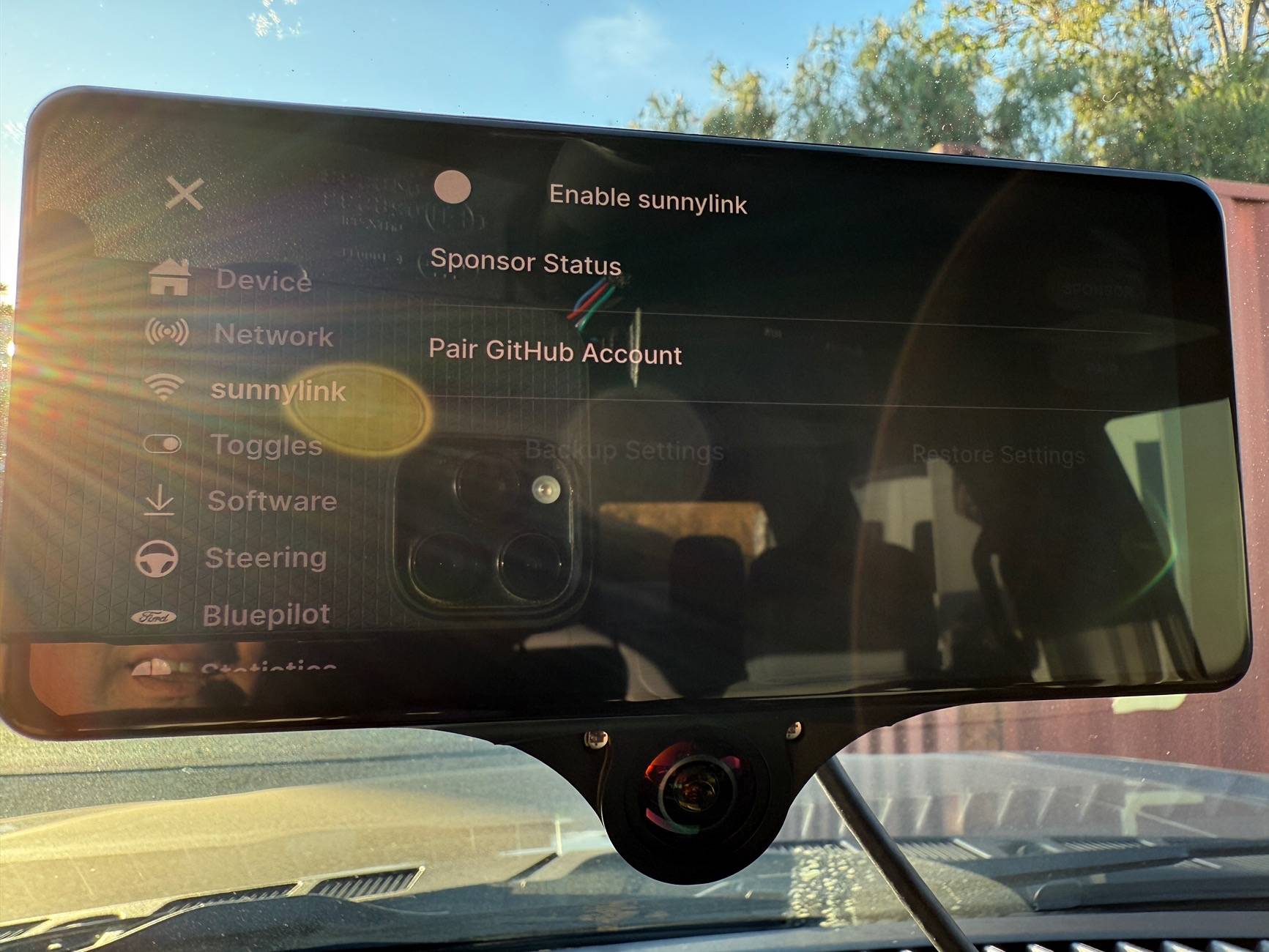

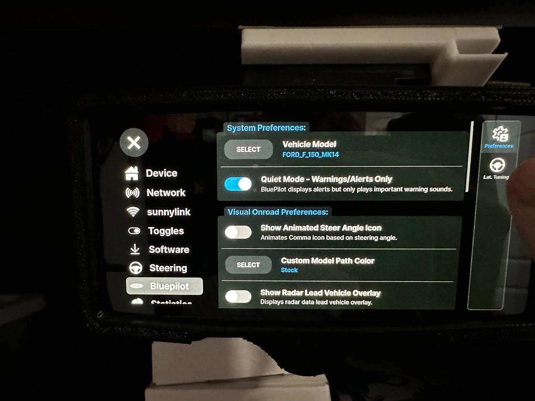

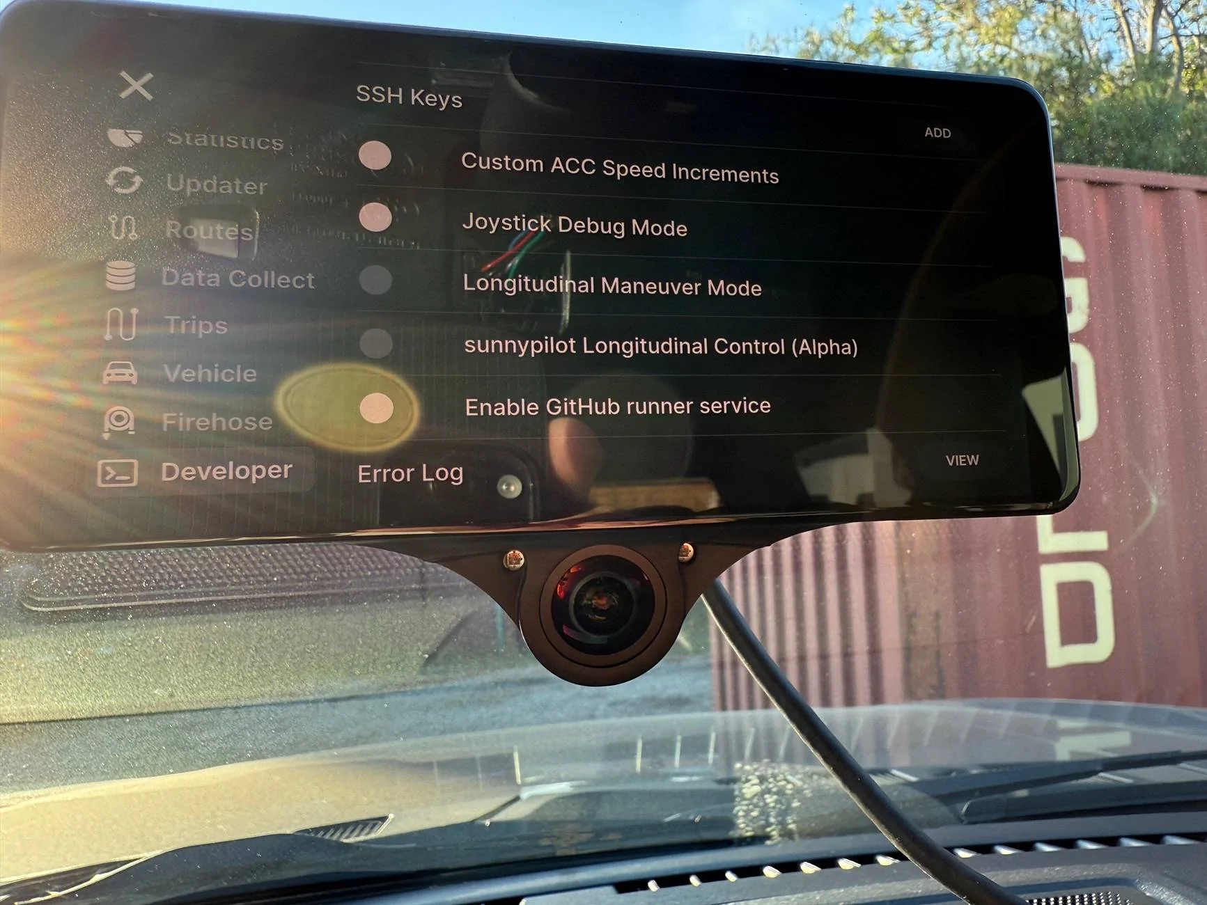

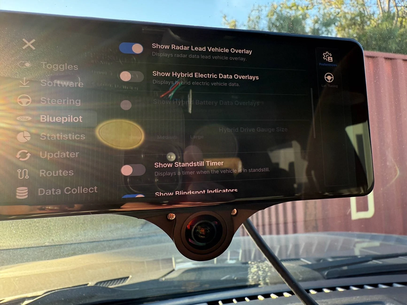

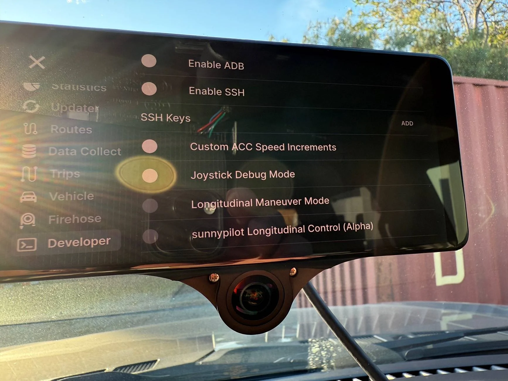

Hope these pics aren’t too shitty for you to see. Let me know if I missed something you need to see.
Ford F-150 Lightning Comma AI self driver assistant IMG_1097
Ford F-150 Lightning Comma AI self driver assistant IMG_1096
Ford F-150 Lightning Comma AI self driver assistant IMG_1095
Ford F-150 Lightning Comma AI self driver assistant IMG_1094
Ford F-150 Lightning Comma AI self driver assistant IMG_1093
Ford F-150 Lightning Comma AI self driver assistant IMG_1092
Ford F-150 Lightning Comma AI self driver assistant IMG_1091
Ford F-150 Lightning Comma AI self driver assistant IMG_1090
Ford F-150 Lightning Comma AI self driver assistant IMG_1089
Ford F-150 Lightning Comma AI self driver assistant IMG_1088

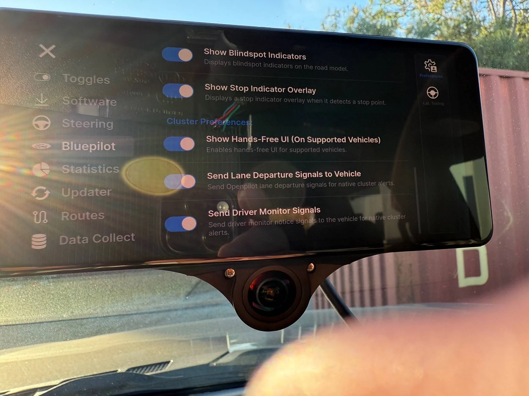

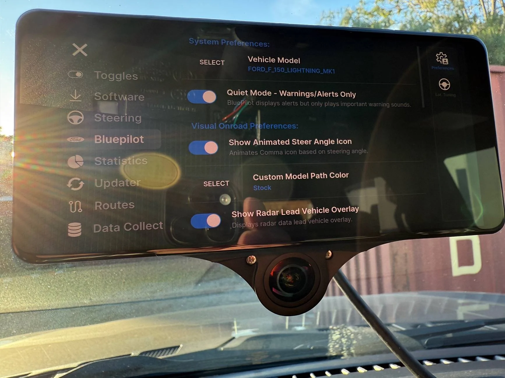

There are two places the vehicle can be specified (I’m going to clean that up). The BlurPilot menu, bc the vehicle menu. Can you check to make sure they agree?

Tuning question for BluePilot 3.0:
I got a lot of lateral ping-pong. I have changed my "Driving Personality" to "relaxed". The neural network NNLC toggle says "unavailable for this platform"
What other settings should I be looking for or adjusting to calm down the ping pong on BP 3.0?
If you have already answered this question in the ICE F-150 forum, let me know and I will check out those threads.
Thanks again for all the help!

Never thought I'd see this in my Pro!

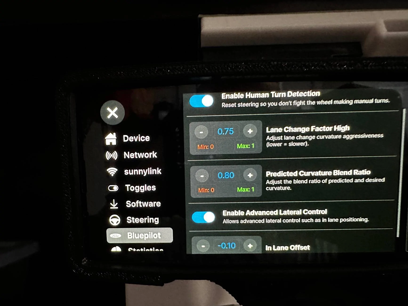

BluePilot Menu —> right side click the lateral tab.
enable advanced lateral control and increase PC Blend Ratio. I’m running 0.75 right now.

Driving personality is about gas/brake, not lateral.
NNLC is for Torque based cars.
I don’t seem to have this setting. ?

I took a long test drive with the PC Blend on 0.75 and then 0.80. Both seem to do a very slow side to side drift. Not nearly as bad as the default setting, but still enough to possibly attract attention from other drivers or LE. Does the Comma "learn" and get better? Are there any other settings that would tighten up the tolerance?

A slow drift means you may have gone to far. Try backing down to 0.6.

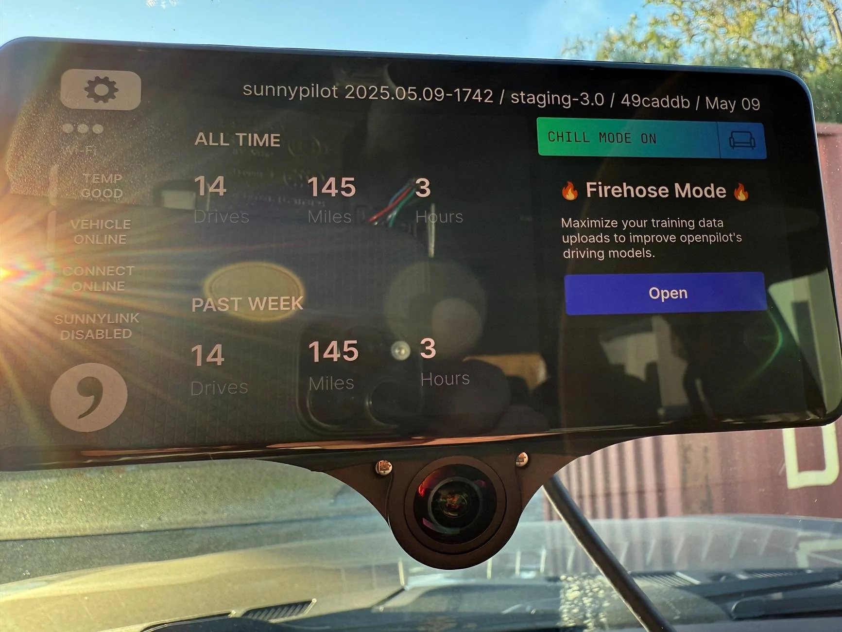

Install. When it reboots and gets stuck on the large white comma logo, unplug the USB and plug back in to power cycle. As soon as it starts up, start tapping the screen until you get an option to erase or something like that - I don't remember exactly what it says, but it will be obvious. Install again using the same link. This time when it reboots, it will boot into BluePilot. I also had to use my phone's hotspot to download as my home wifi caused the Comma to stop at 10% while downloading. I have no idea why this happened or why my hotspot worked, but if you have a similar error, try a different network ?‍♂

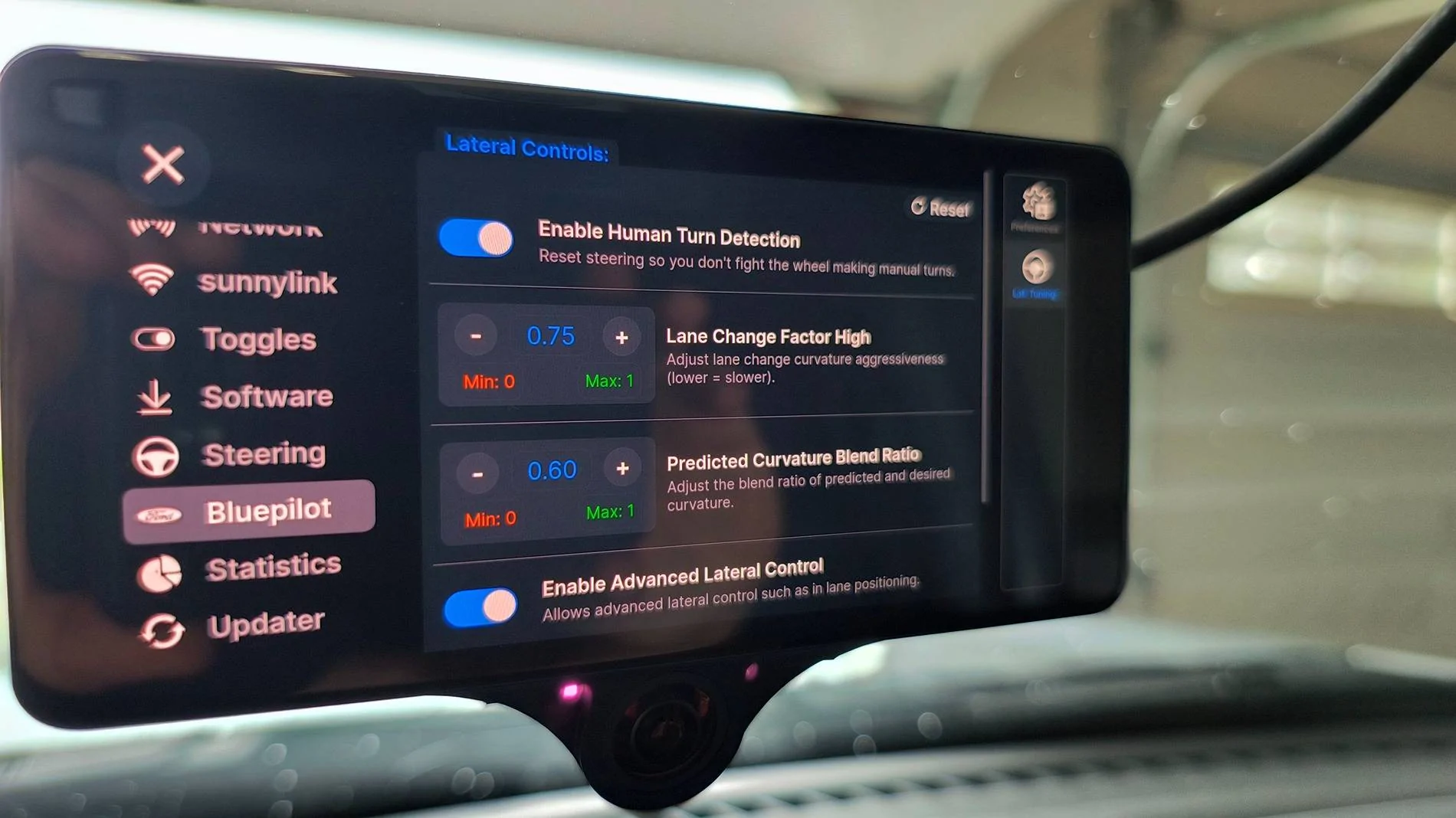

- The pic below shows my settings for Lateral Tuning for what I feel is the best ride with minimal side to side ping ponging.
Settings > Bluepilot > Lat Tuning (right side picture of steering wheel) > Lane Change Factor keep at stock setting of 0.75 and change the Predicted Curvature Blend Ratio to 0.60 (Thanks @Ajzride !)
