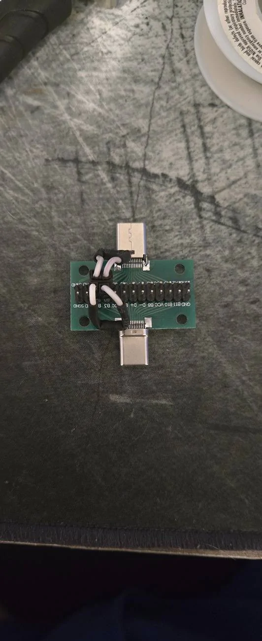

Too easy to bump a cable loose. I'm working on one today that is soldered and sealed for someone who can't wait for the PCBs to be developed.
Ideally, a breakout board without the headers would be a better solution, but I was trying to make something that someone that doesn't know how to solder very well can make on their own while the permanent solution is made. I wouldn't be super worried about securing these any better than they already are. Now that they are heat shrinked, the only concern would be accidentally having them unplugged when you're cleaning your windshield or something.
The thought was to 3D print a project box for it, but it would be too bulky with the headers.
This also allows you to keep spare resistors soldered up and stashed in the truck in case something goes wrong.

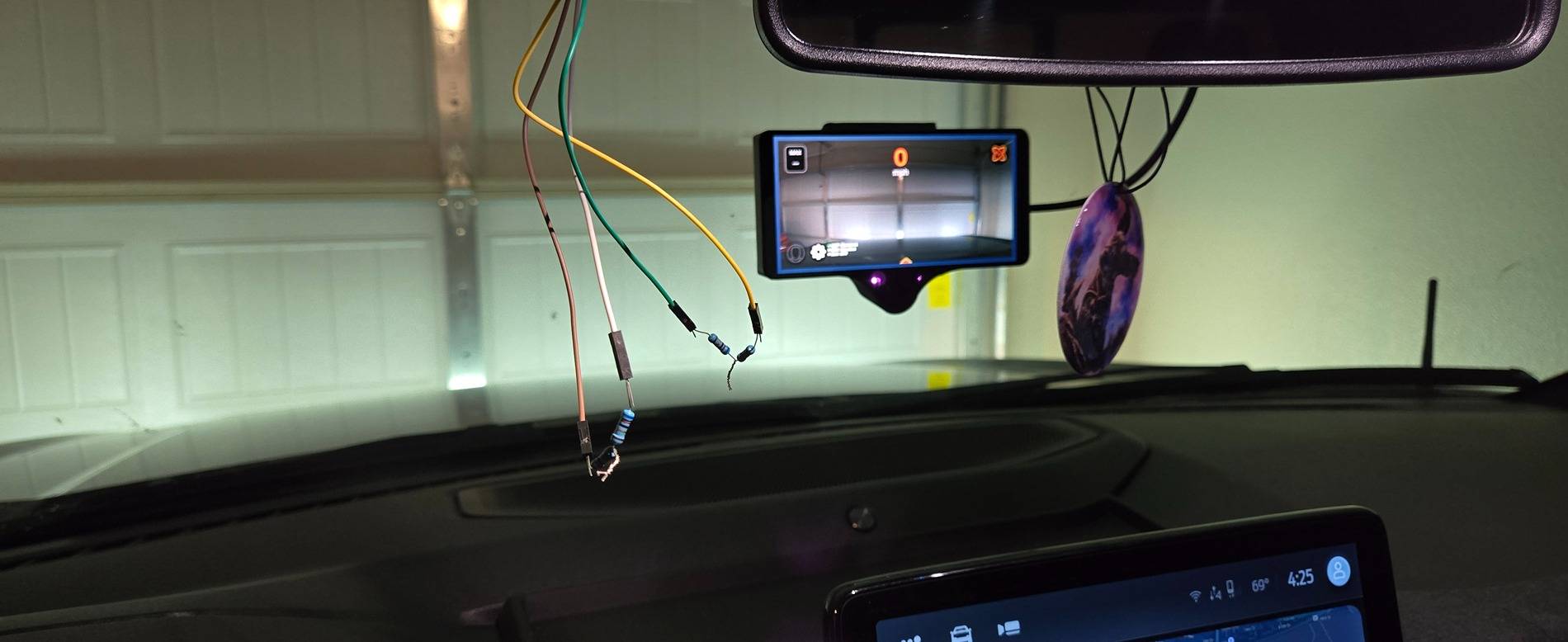

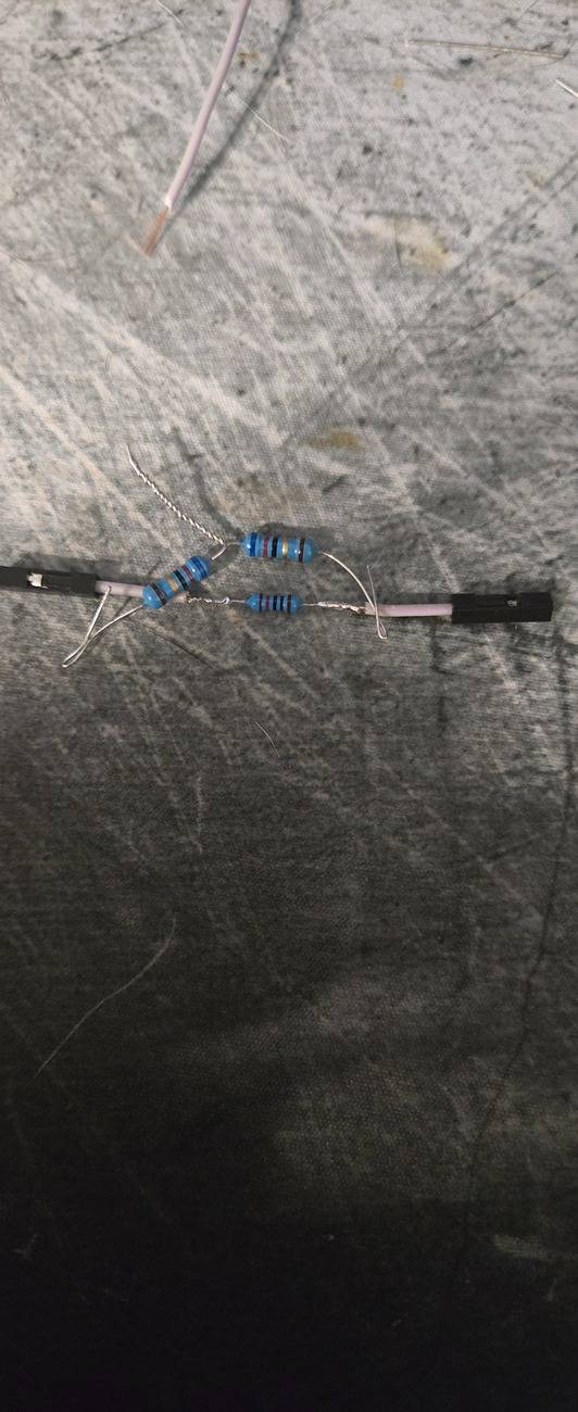

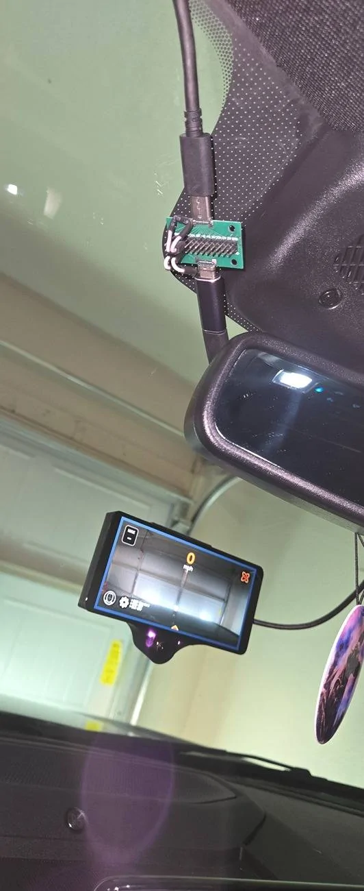

Got the 120 ohm 1/4w resistors in today, soldered them up and installed.
These are definitely smaller compared the the 1/2w 62ohms.
I also added some heat shrink around the top jumper set and it holds all 4 connections in pretty well with tension.
Ford F-150 Lightning Comma AI self driver assistant 20250508_133732
Ford F-150 Lightning Comma AI self driver assistant 20250508_134741
Ford F-150 Lightning Comma AI self driver assistant 20250508_135117
Ford F-150 Lightning Comma AI self driver assistant 20250508_134718
