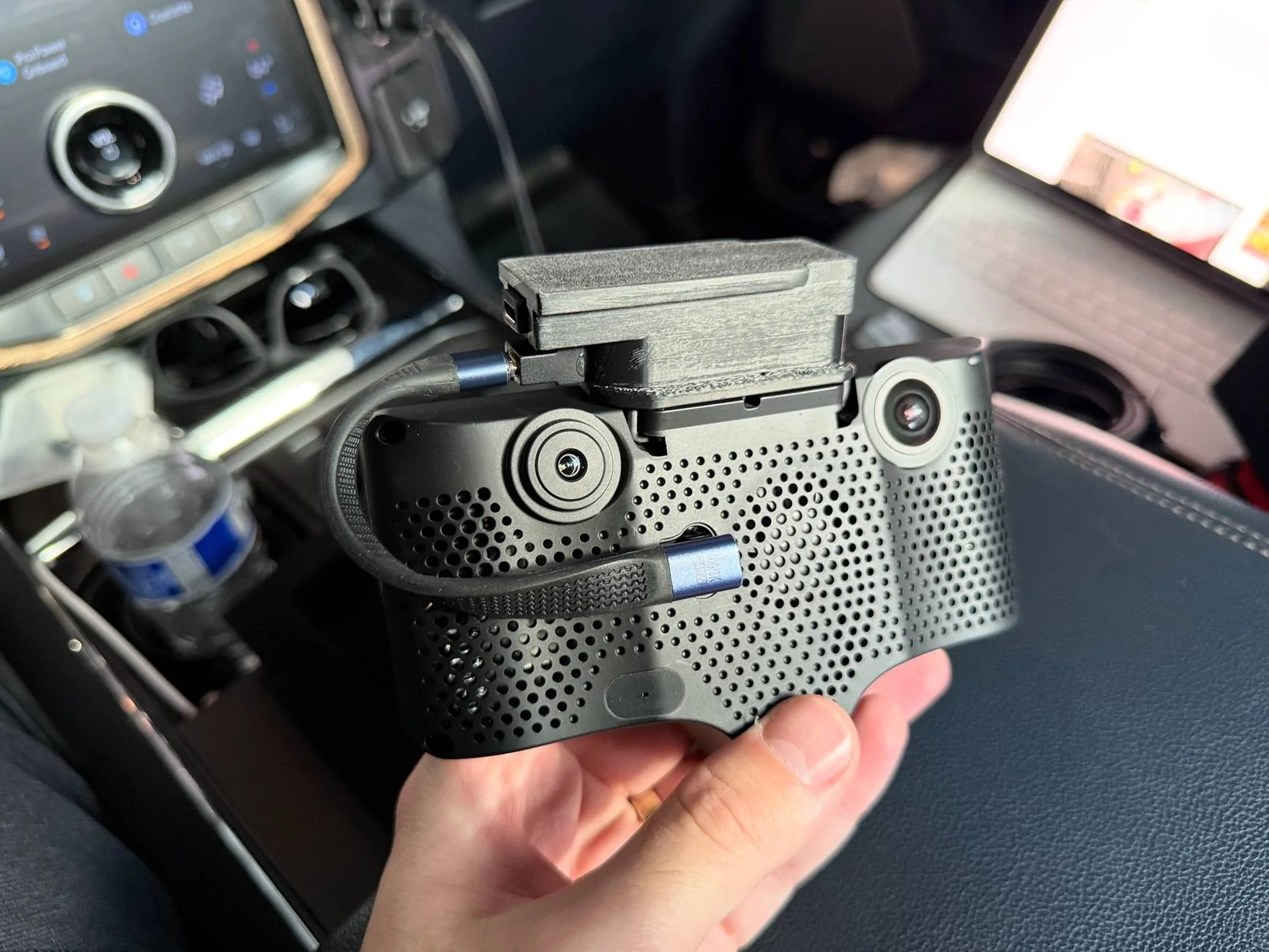

Thats just the normal Q4 harness. The smaller cable is ideal to reduce stress on the comma units USB port against the windshield. But it will work the same with your setup.

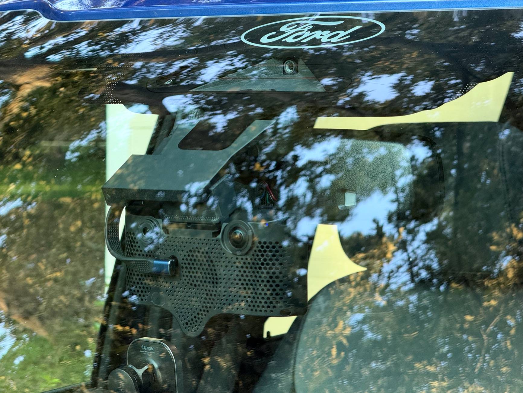

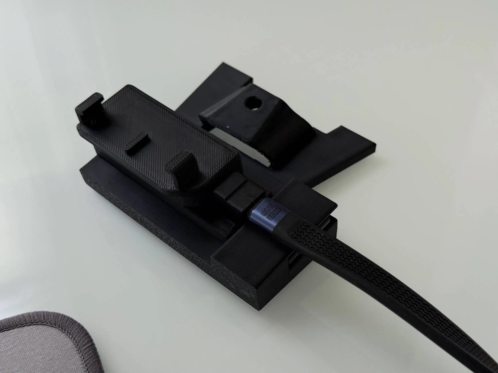

Installed mine today with the mirror bracket mount and loaded BP 3.1. Seems to wander within lanes a bit - any tips for dialing that in?
anyone happen to know exactly the correct screw spec to use with this mount? (I found one at Lowe's so it's secure, but not sure if someone found one better. This mount.)
