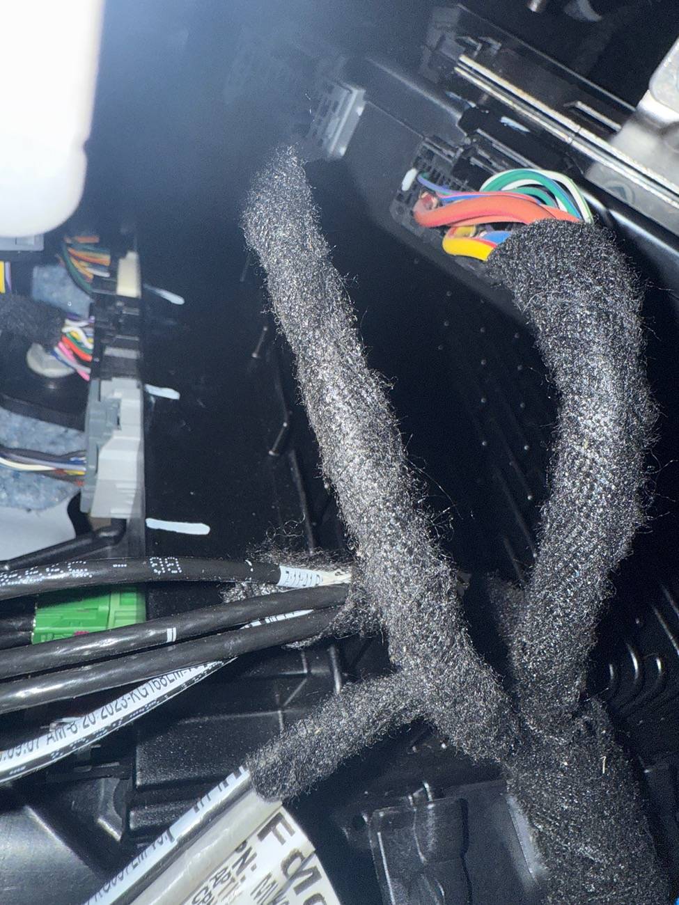

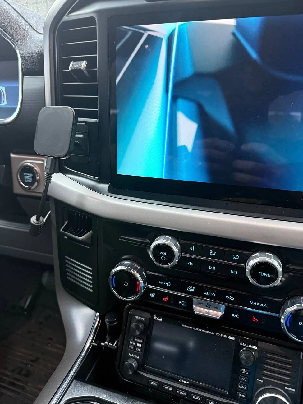

Just watched the video, nice! These are my inputs I.e. I am trying to help if anyone why I don't get errors. I don't use mirror adapter my cable goes directly into comma, I use factory mount, though I did flip mirror to set comma higher. I don't have sunroof, brake controller, trailer package and that knob where I have my charger. I don't have four buttons where my door locks are. Finally I have 9.6K power, small display and I do charge my home during hurricanes I just don't use the Ford station to do it. I will post anything else I think of.

Is your comma continuously powered? And if yes, where are you getting your 12v? If you are powering unit differently maybe That could explain why your not getting errors?
I use the obd2 it came with….I do power my Icom and 24/7 dash cam with a separate bienno battery. Maybe some sort of feedback?

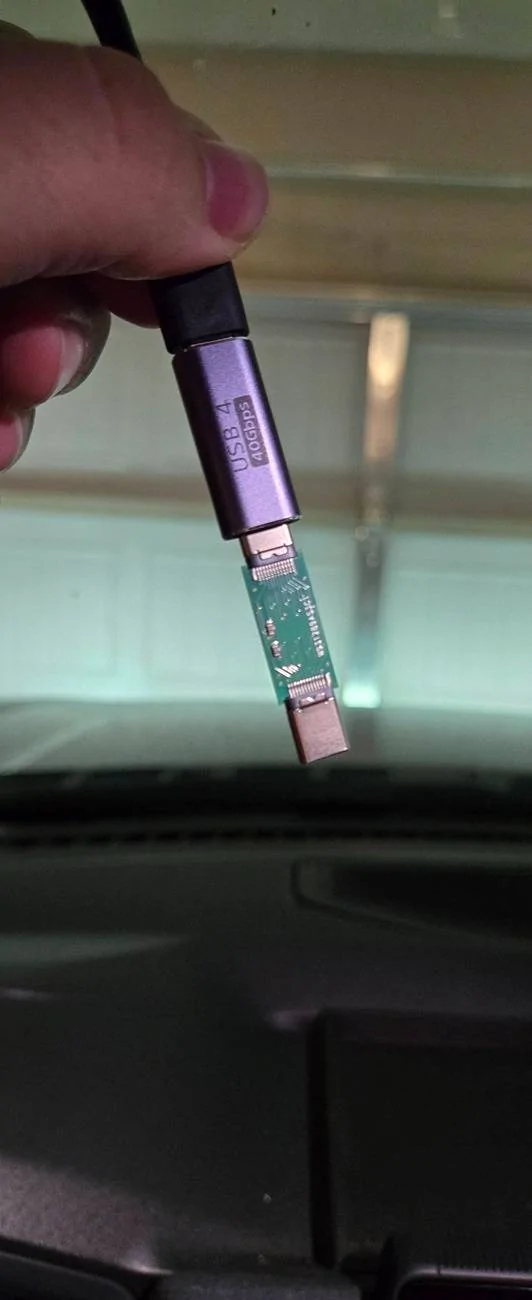

Alright, I figured out what went wrong with the original adapters, the pinout was incorrect for using the same connectors on each side. I have a new schematic to correct the issue and will be sending them off in the next couple of days once I have time to review a couple more times to avoid further waste. Here is an idea of what they will look like once they are completed, the footprint is pretty much the exact same as the stock coupler. I will have to wait for the new version to make a proper shell as I am changing the connectors for the next revision to be female to female as originally intended.
