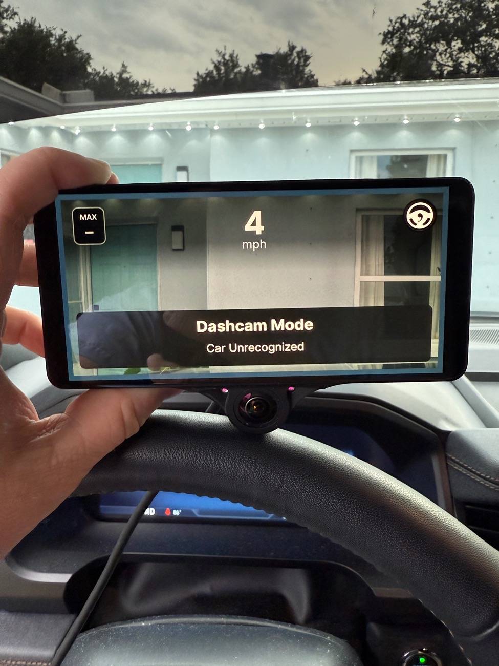

I’m assuming this means my canbus is encrypted. I have an April built 2024. A bunch of errors pop up on the dash steering assist fault, pre collision assist not available, service advanced track. And my Air Conditioning won’t kick in.
No
If you were encrypted you would get a message about SECoC not being supported.
This just means you have a combination of OTAs comma hasn't seen yet.

Disregard. I just had to select f150 lightning 22-23 as the vehicle and everything came to life. Errors went away after it finished booting. I’m so excited to finally have OP back.

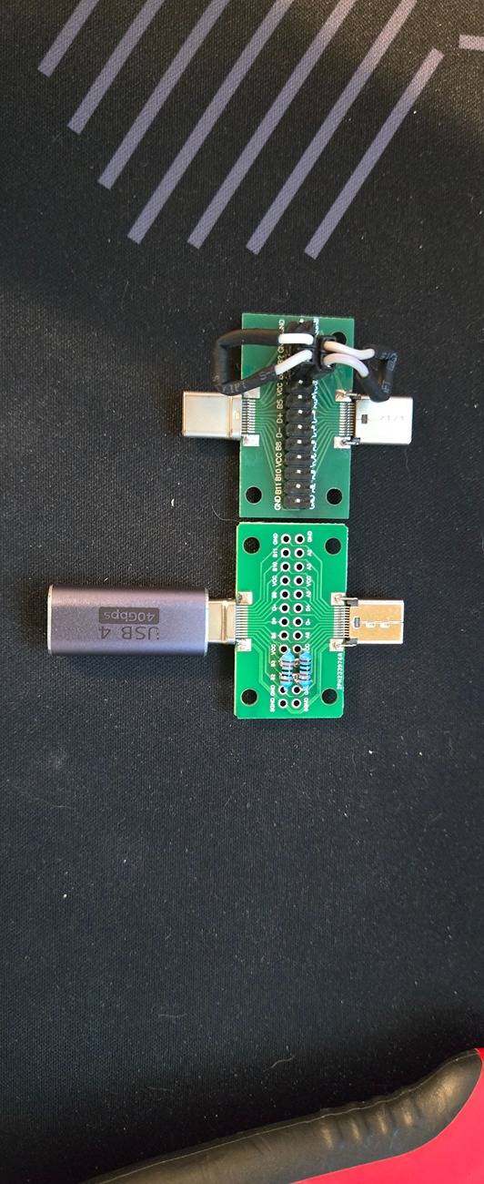

With the finalized adapter possibly 30+ days out - I can make a breakout board with more permanent resistors soldered into the board instead of jumpered so ya'll don't have to wait to get rid of the errors. DM me if you want one, they will be cheap since they are just a stop gap solution.

Posting this more to be transparent in the design process than anything. But here is the refined breakout board.

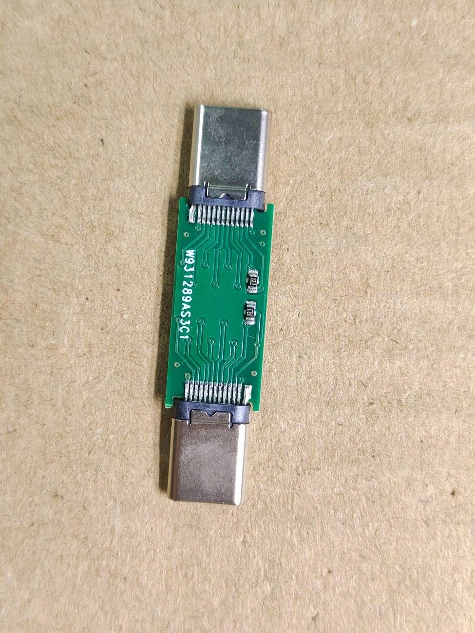

Final version of the PCB boards are on their way! PCBWAY sent the assembly pictures for approval and shipped them out yesterday. I am expected to have them June 26th. Here is a sneak peak for ya'll.
