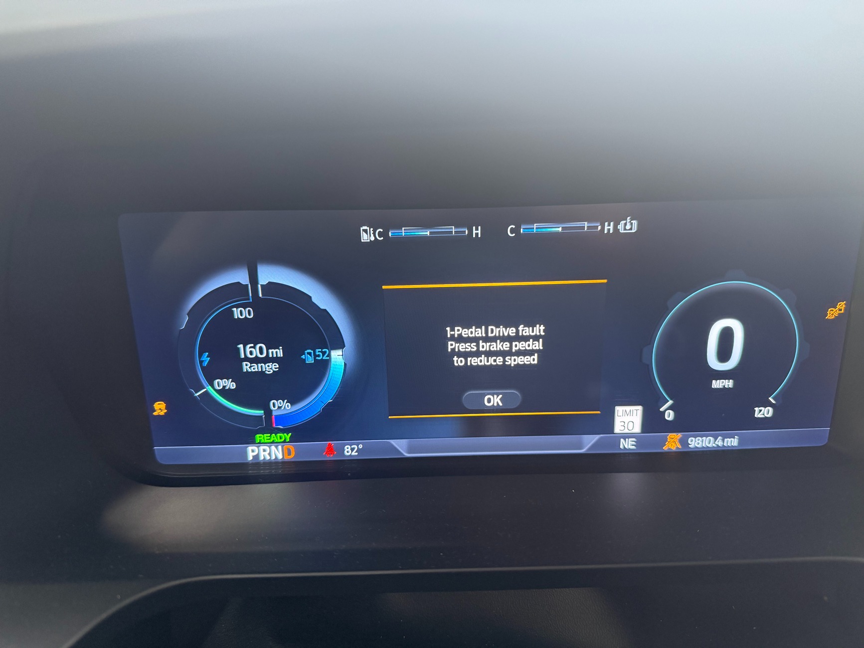

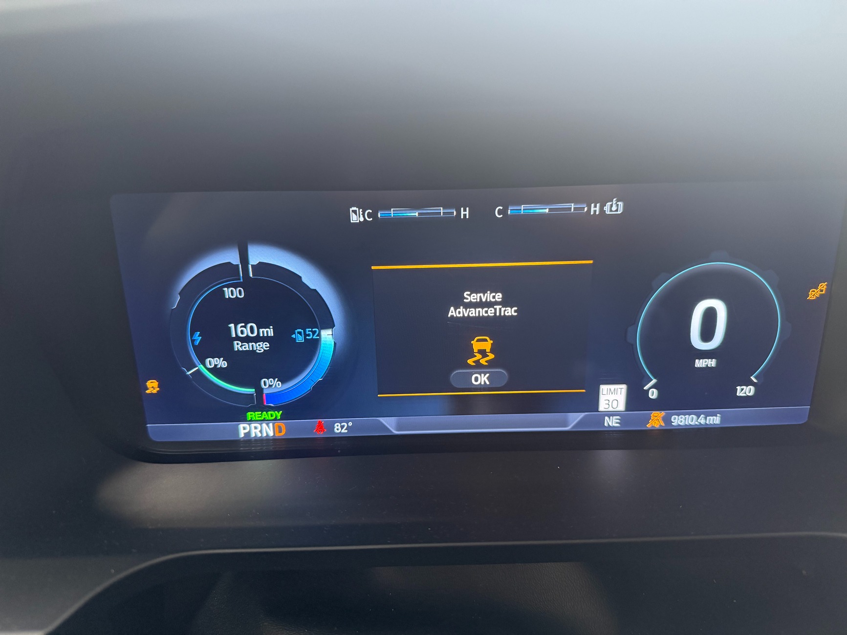

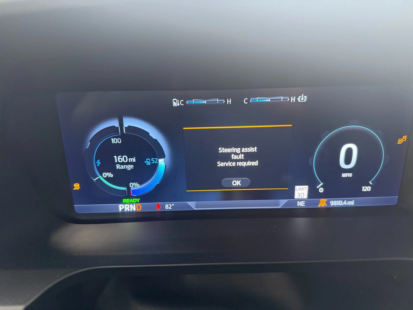

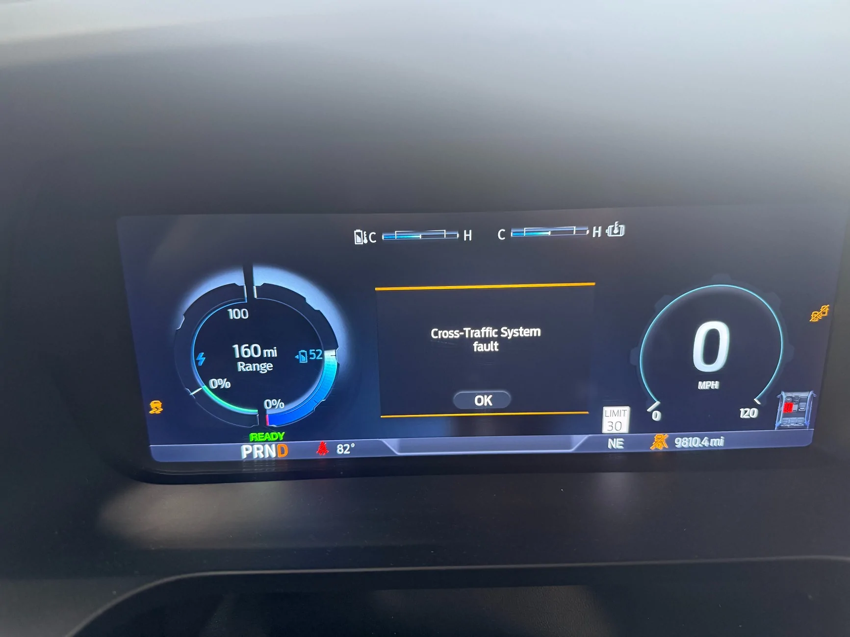

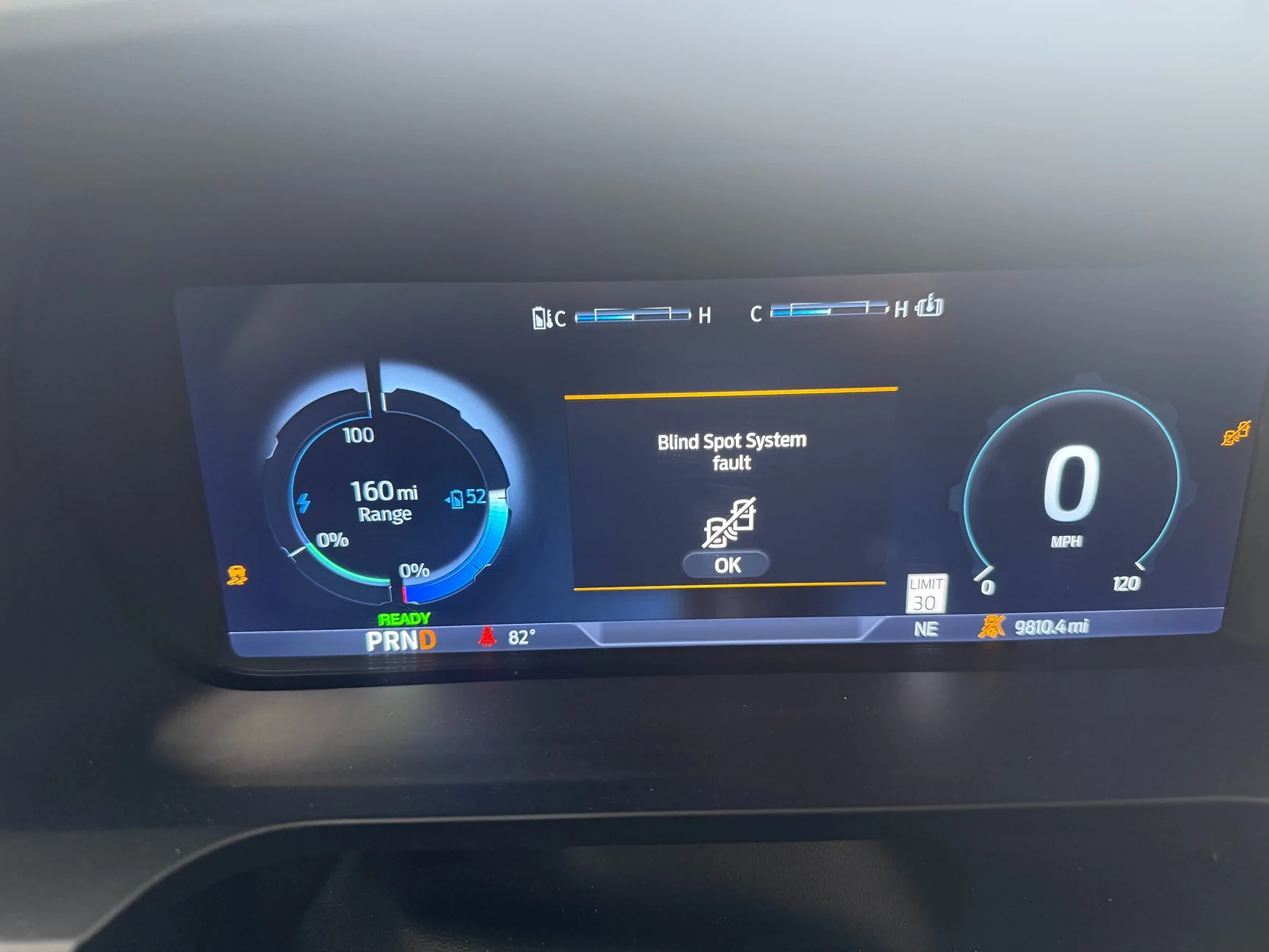

Reseated all the cables and tried both the USB that came with the comma and a different USB (USB C 3.2 Gen 2X2 Video Cable, 20 Gbps Data Transfer, 240 W, 10ft) with the same issue. on start up I get Pre Collision Assist, Service Advance Trac, and steering assist. When I start driving I also get the other codes below. They do not go away until I unplug the USB and restart.
