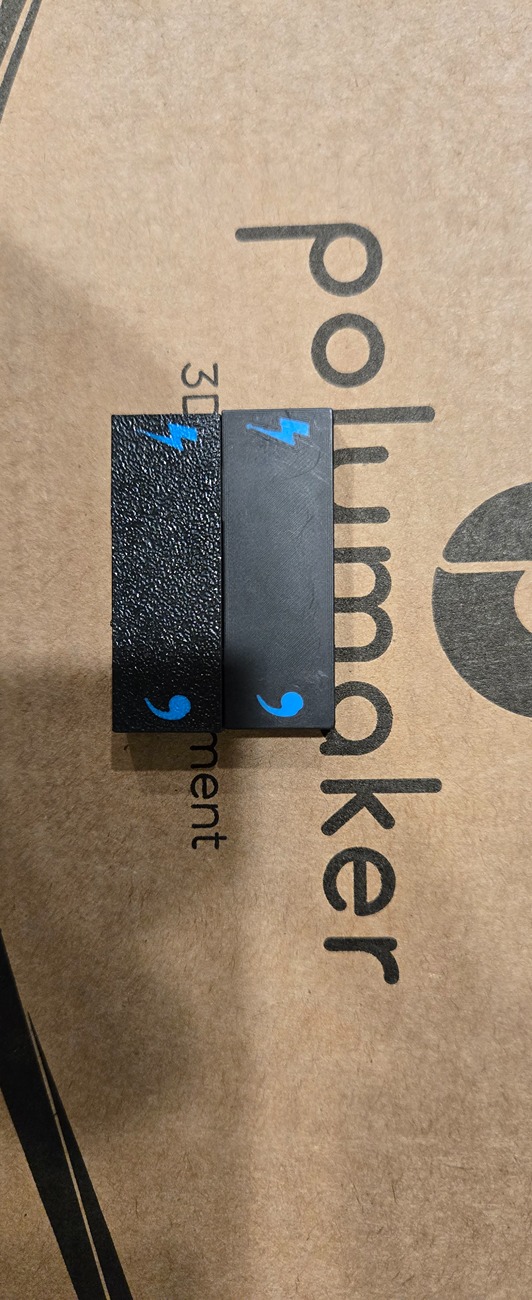

Smooth look better, but I suspect the one made with the textured plate will hide future scratches better.
Have you tried a carbon fiber build plate? I used one for the rotary shifter cover and it came out pretty nice.

I need opinions. All opinions are welcome, even if they are wrong. My plate needs a fresh coat of adhesive, so ignore the marks on the plastic.
I think the carbon fiber would be great. I am limited at the moment due to not having a ton of plates available for the H2D. I may look on amazon and see what I can find.
