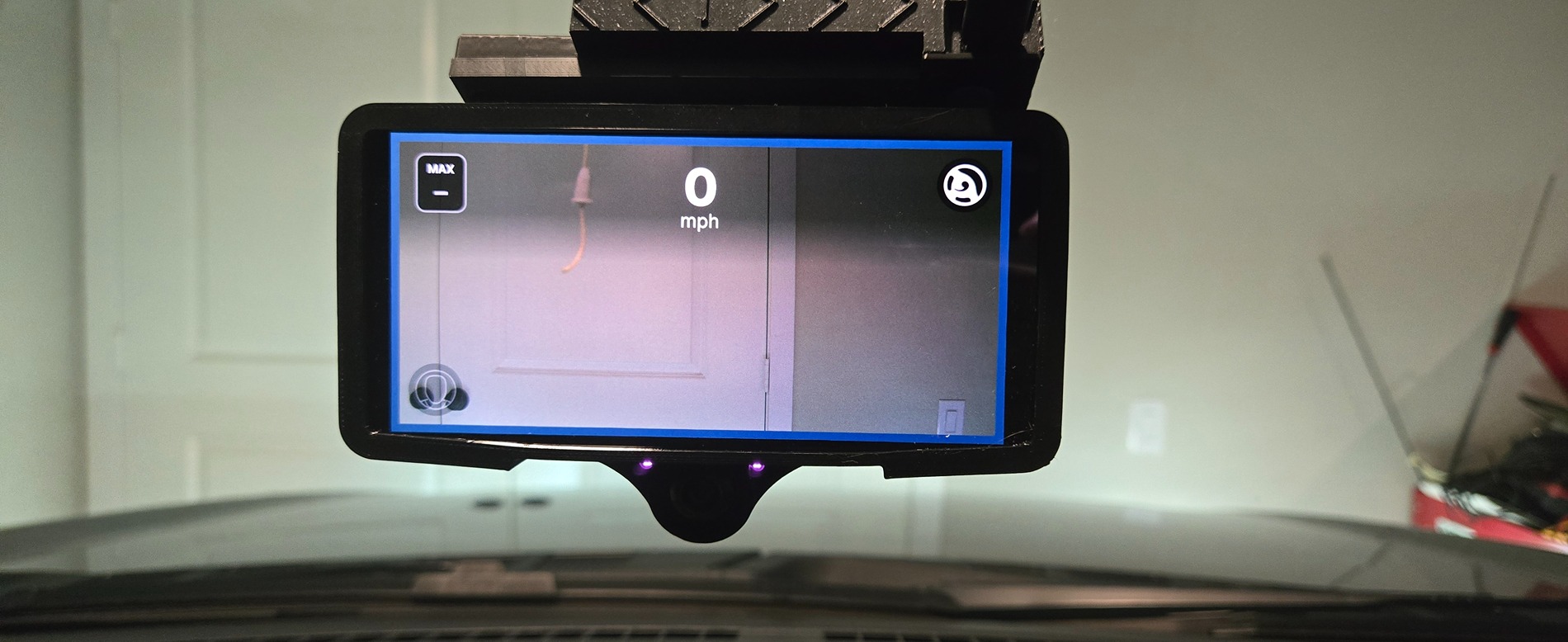

If your comma looks like this and you are still getting errors on the truck is what we are looking for.

Happy to report I have taken my first drive with a fully functional and operational Comma.ai. Thank you both for your assistance. Should I just wait now for the breakout board and just do a start up according to these simple tests till then?
The only thing you should have to do is wait for the software to boot if you were able to get it working. Is your AC working?
Everything is working as it should and no codes.
