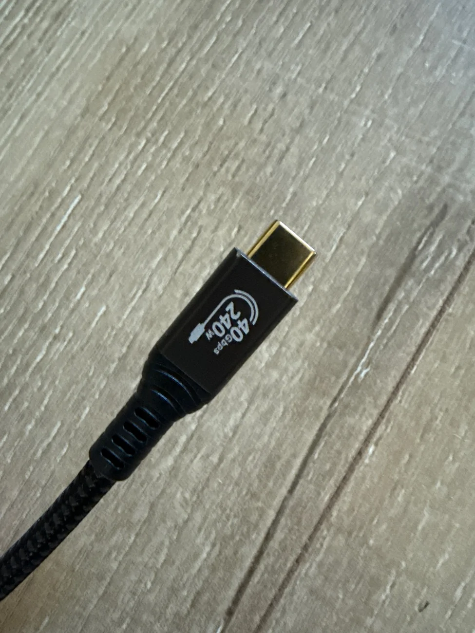

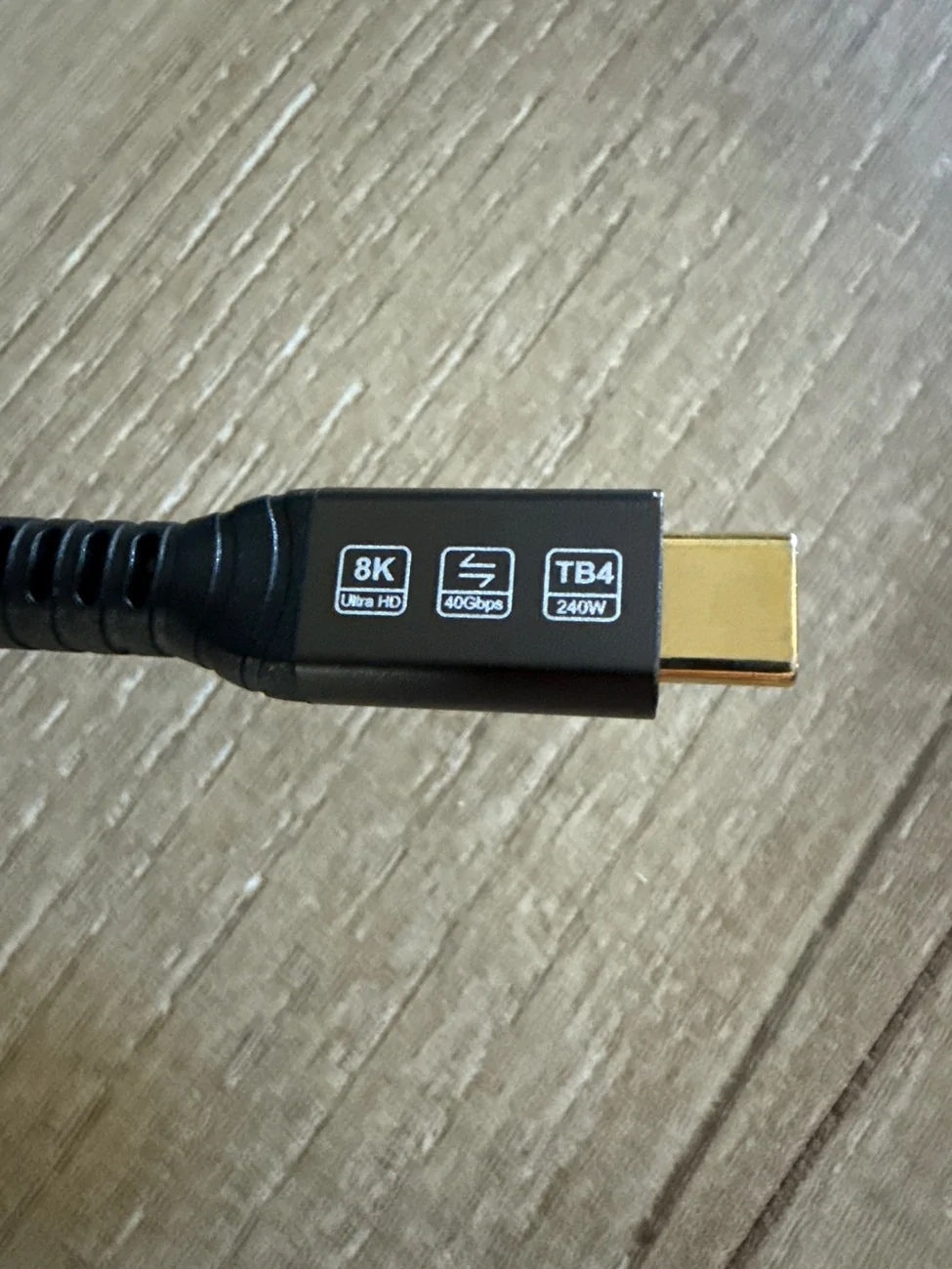

Are you sure your spare cables are USB 3.2 Gen 2x2 ? Do you have a link for them?
