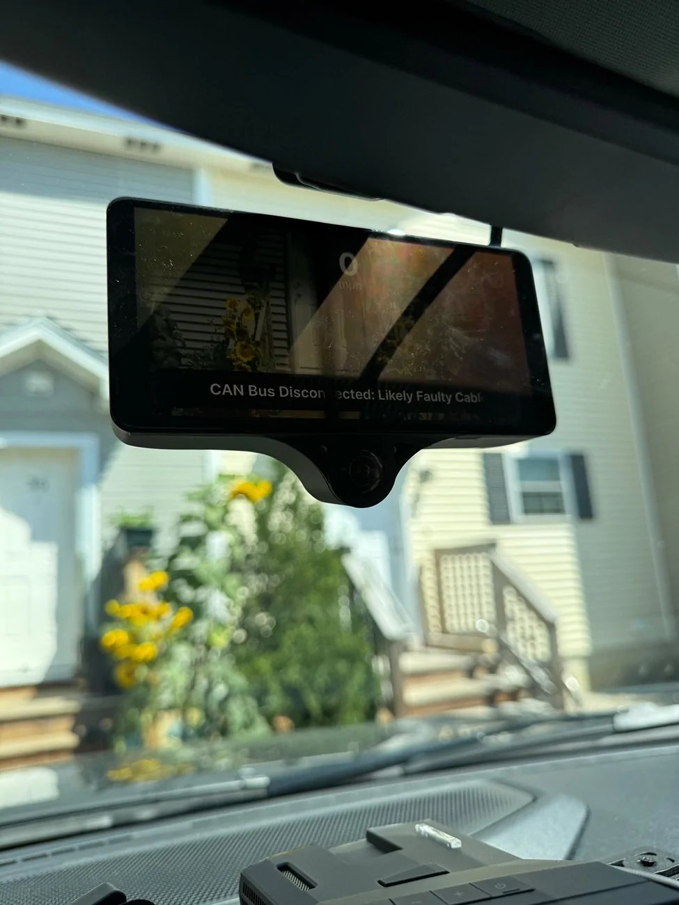

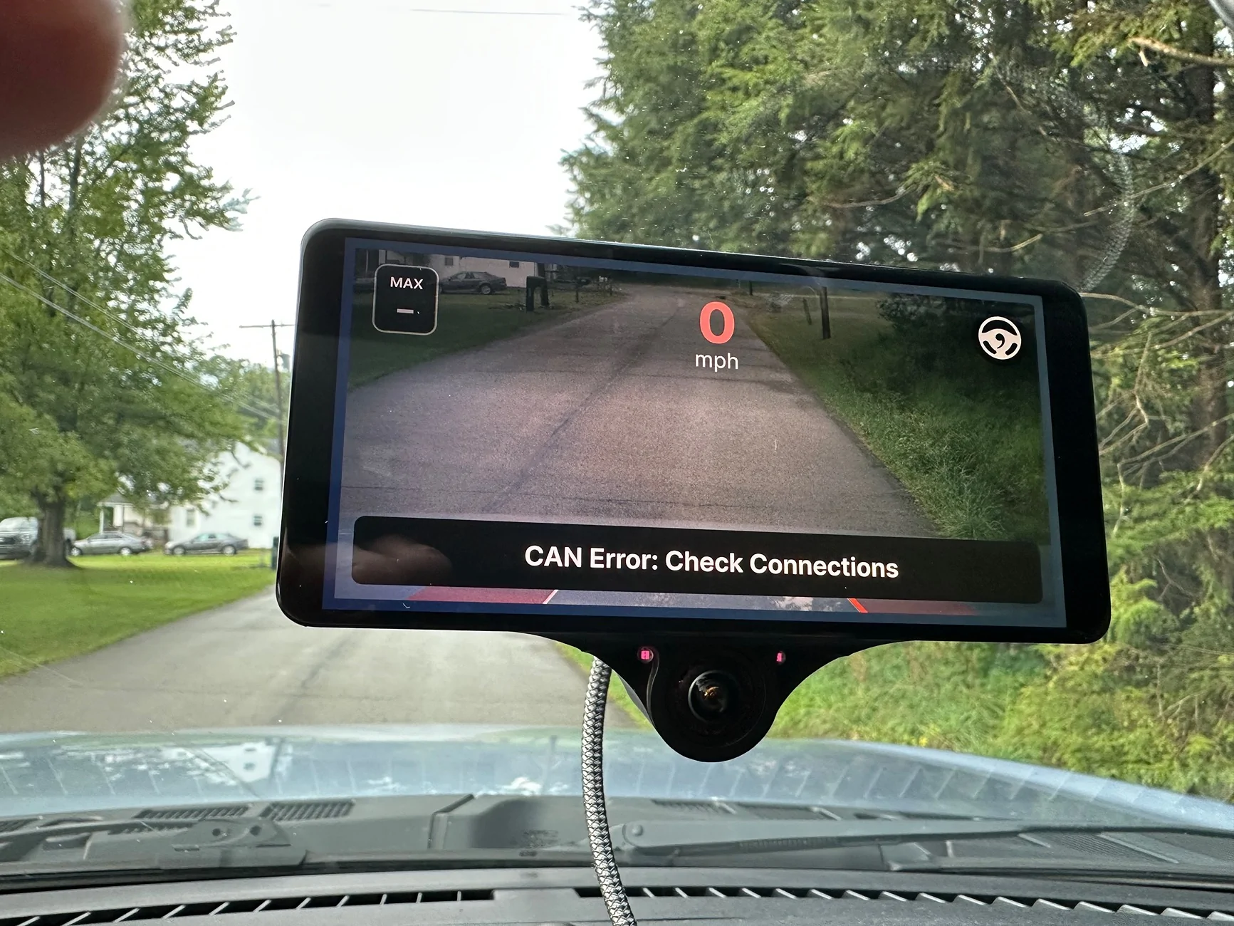

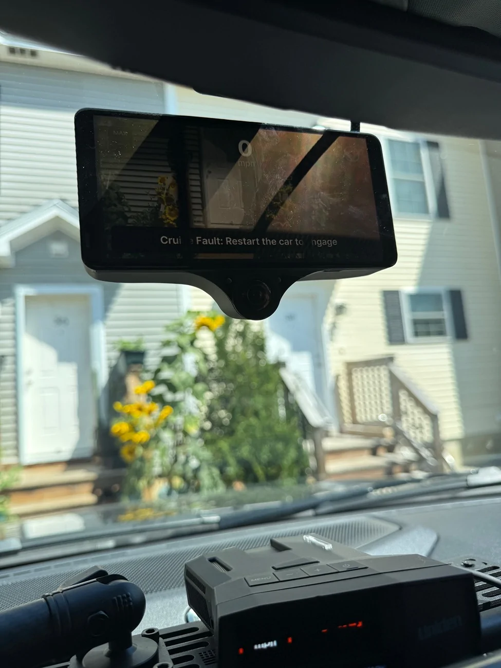

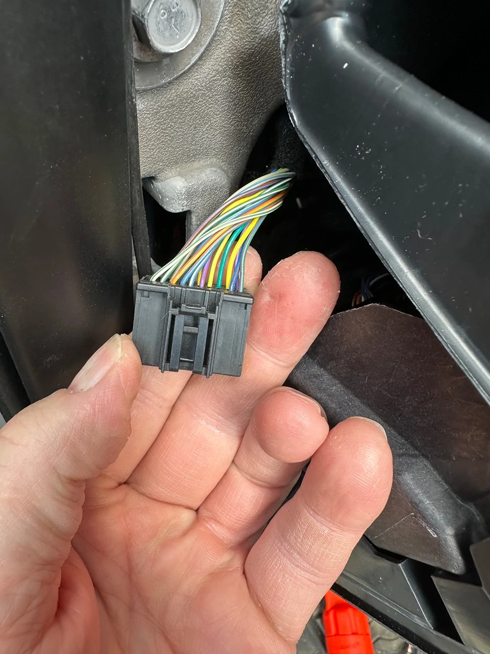

Okay, so I need some help.
I’ve tried to install the comma 3x running blue pilot 4.0 in several ways on my 2024 lightning flash edition. Sometimes it will intermittently work, sometimes I get the immediate CAN Bus disconnected likely faulty cable error.
it will occasionally also flash a different error I have included in the pictures, this is far less common.

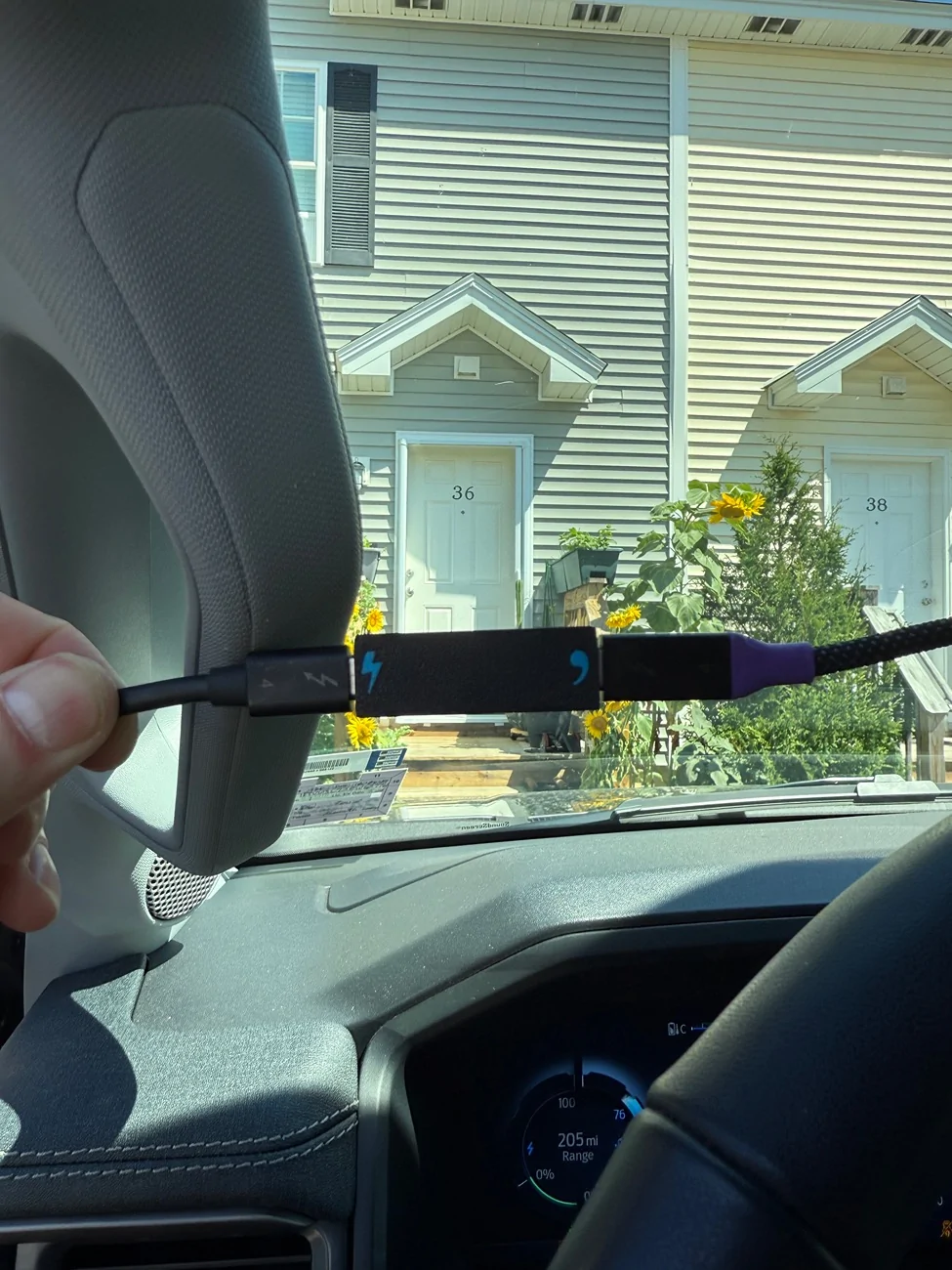

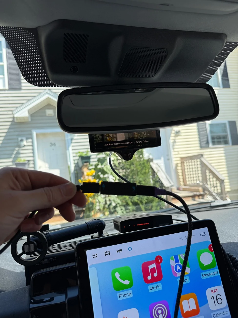

I have put in the lightning adapter with the following configurations.
comma3x harness Q4 ford harness (first one they sent, got lost in mail, let’s call this *1)
harness 1 —> comma long obdc cable —> lightning adapter—> short thunderbolt 4 cable —> comma
harness 2 w/ same setup
Harness 1 w/ Long obdc —> lightning adapter —> long obdc cable 2 —> comma
harness 2 w same set up
harness 1 with usb 4.0 —> lightning —> usb 4.0 comma
what am I doing wrong?
(have pulled fuse 32 several times to reset/make sure)

CAN Bus Disconnected: Likely Faulty Cable means exactly that, we have a problem with the USB cables. Let's look at your configs below:
This should work, so one of these cables or the adapter must be bad.
Harness 2 w same set up
This will not work for sure. Two long ODBC cables is a problem (known from experience)
Cruise Fault: Restart car is a different message, this means the Ford Radar has an error code in it. Usually this happens during hard rain, but it is possible the comma did something to cause it to fault.
I have never heard of USB 4.0, that must be new, and I'm not sure how it will work with comma.
follow this article, start with just the short USBC cable that comma includes (there should be no errors and no need for the coupler when using the short cable). Come back here with any questions.
https://bluepilot.dev/2025/08/15/i-...r-i-get-a-canbus-error-and-alerts-on-my-dash/
