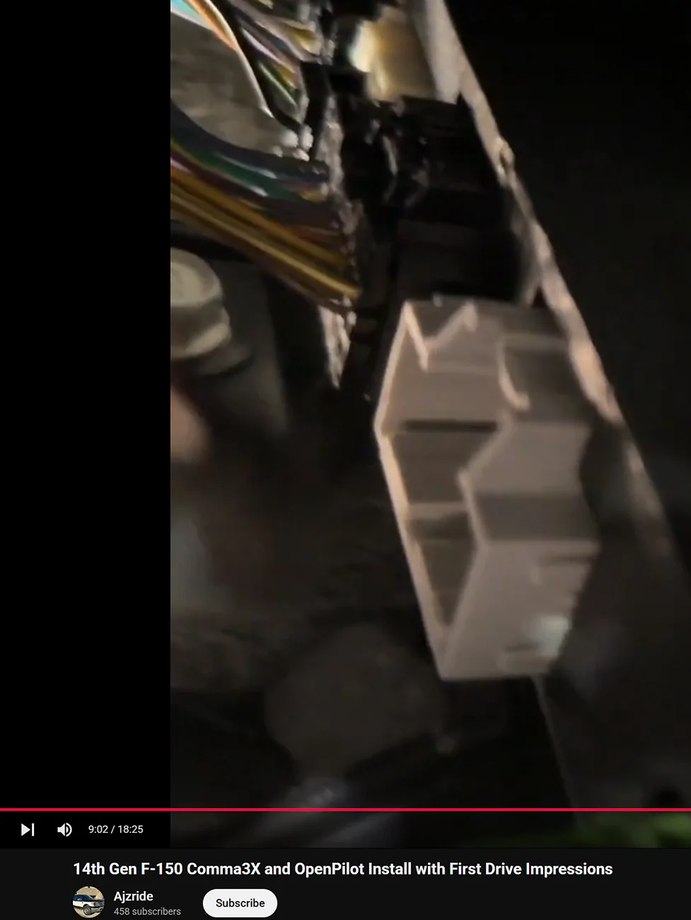

I am very confused, maybe this is the reason for my errors. I followed your video, in the video you mentioned the first plug. the grey one as being the correct plug. So that is the plug mine is plugged into.

Ya,
I wish i would have caught that, i watched it up to that step and then stopped, figured i was done.. weirdly it drove just fine with it plugged into the grey plug, just the comma didn't work.
Now i might be in a pickle. I just went and switched it to the 2nd plug, the black plug and now i get a million boot errors and the truck won't start, stuck in park in the garage. I just disconnected the battery, because right now the truck is stuck in the garage blocking it from closing...

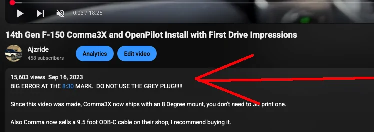

I think you shorted your comma harness box. There were a few MachE users who did the same thing. This is exactly why I made a Q4 specific video:

The second port isn’t on the canbus. So no errors, but the box got Fried. Then when you plugged a fried canbus communicator into a port with canbus…. Errors galore.

Yea, when he plugged into the grey plug, he sent 12+ and 12- through several connectors on the harness box meant for canbus traffic. he also sent ground to a few spots expecting 12+
