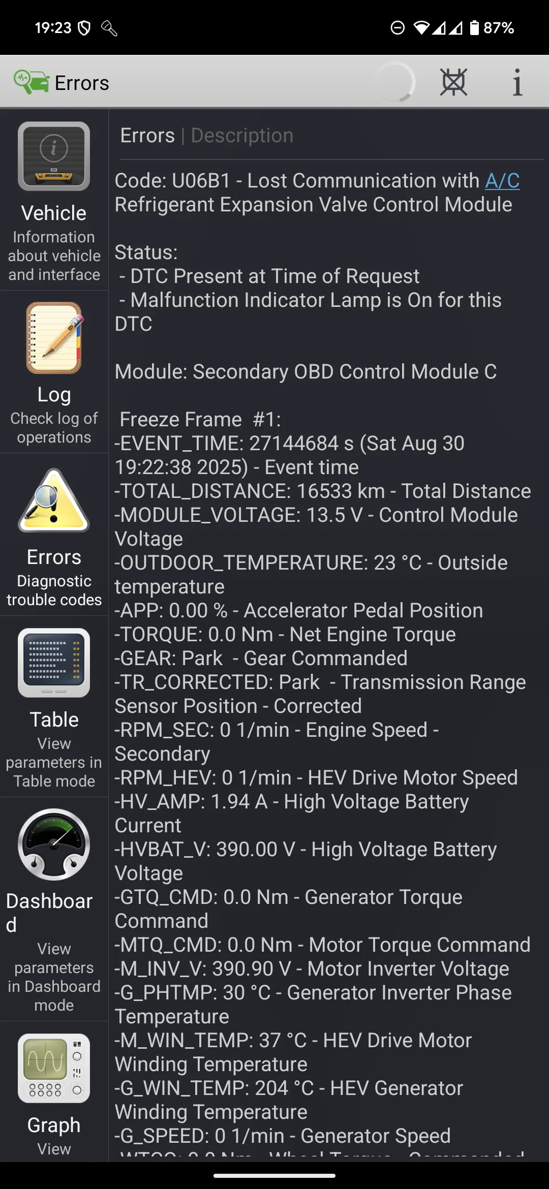

Just installed my C3X with the coupler and it is working splendidly! Loving using it on non-highway roads and not getting nagged to jerk the wheel on straightaways. Took it for a spin, got a car-wash, came home and was sitting in the driveway and got a SVS light. See below:

What's the over/under on the Comma vs. water somewhere it shan't be vs. random issue with outrageous timing?

That is with the coupler installed? The 24’s are known to have weird AC issues with the comma hardware in general.
Are you using the comma power?
Yes with coupler and the comma power connected may be worth noting I installed the coupler under the camera housing if that matters

Location wouldn't matter with the production coupler. I've had a report of AC oddities with the comma power and coupler installed. It only effects the 24 for some reason.
Try unplugging the comma power and see if the issue goes away.
You may have to clear the DTC before it's happy again.
