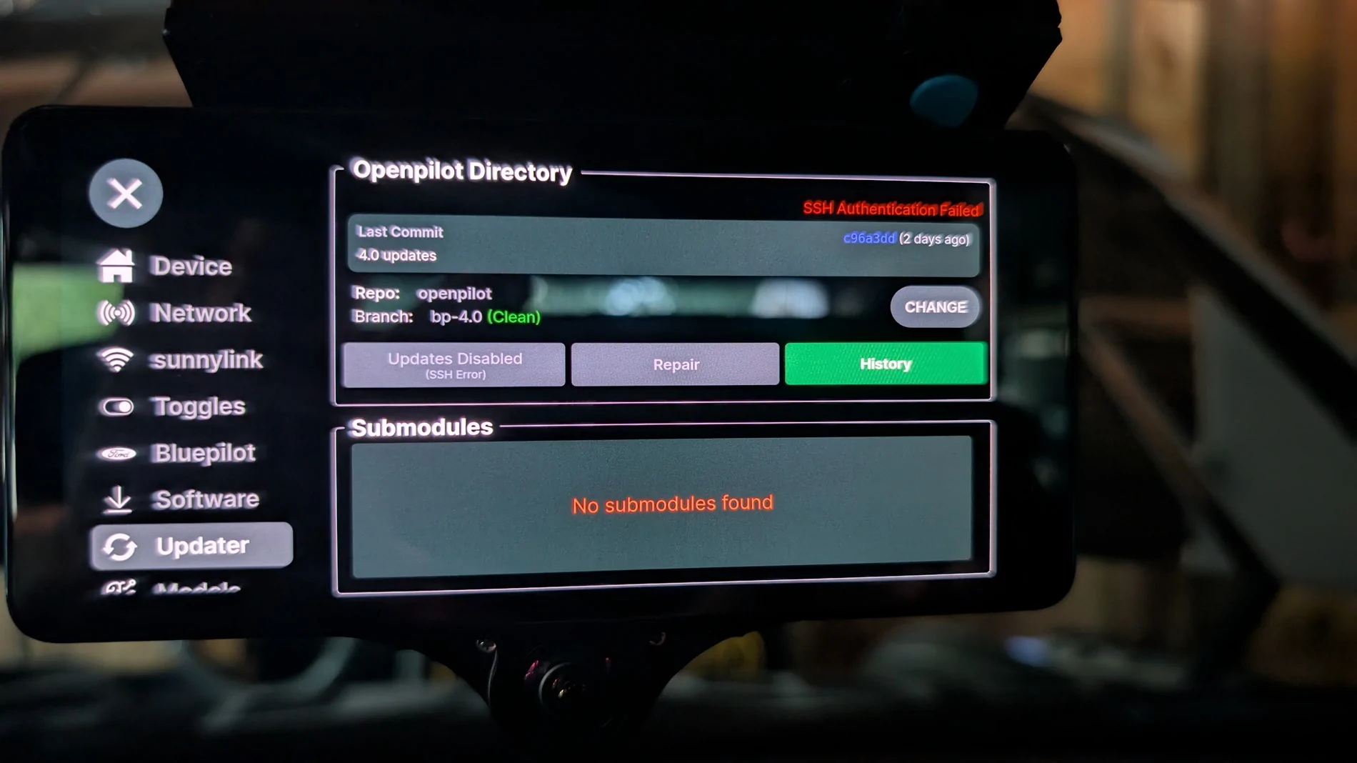

Comma has been working great on bp4.0. The only notification I get is a " Lane-Keeping System OFF" when I first enable the comma. Hit OK once and enjoy the hands free after that.

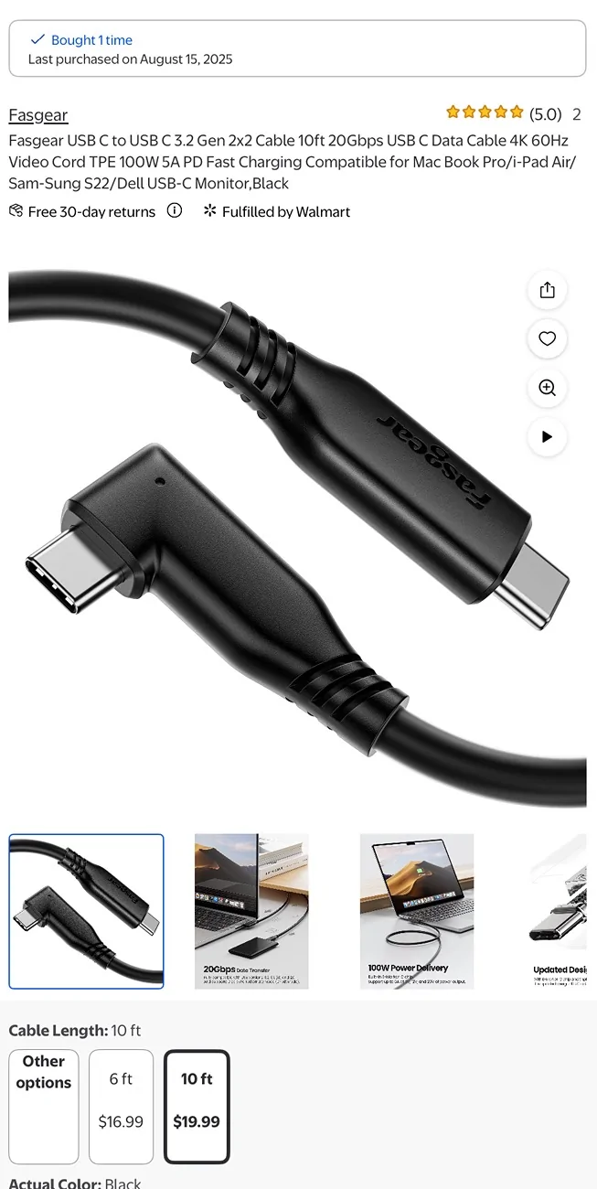

Finally got my Comma with bp4.0 to work in my 2022 lightning Lariat. This is the cable that made it happen!
