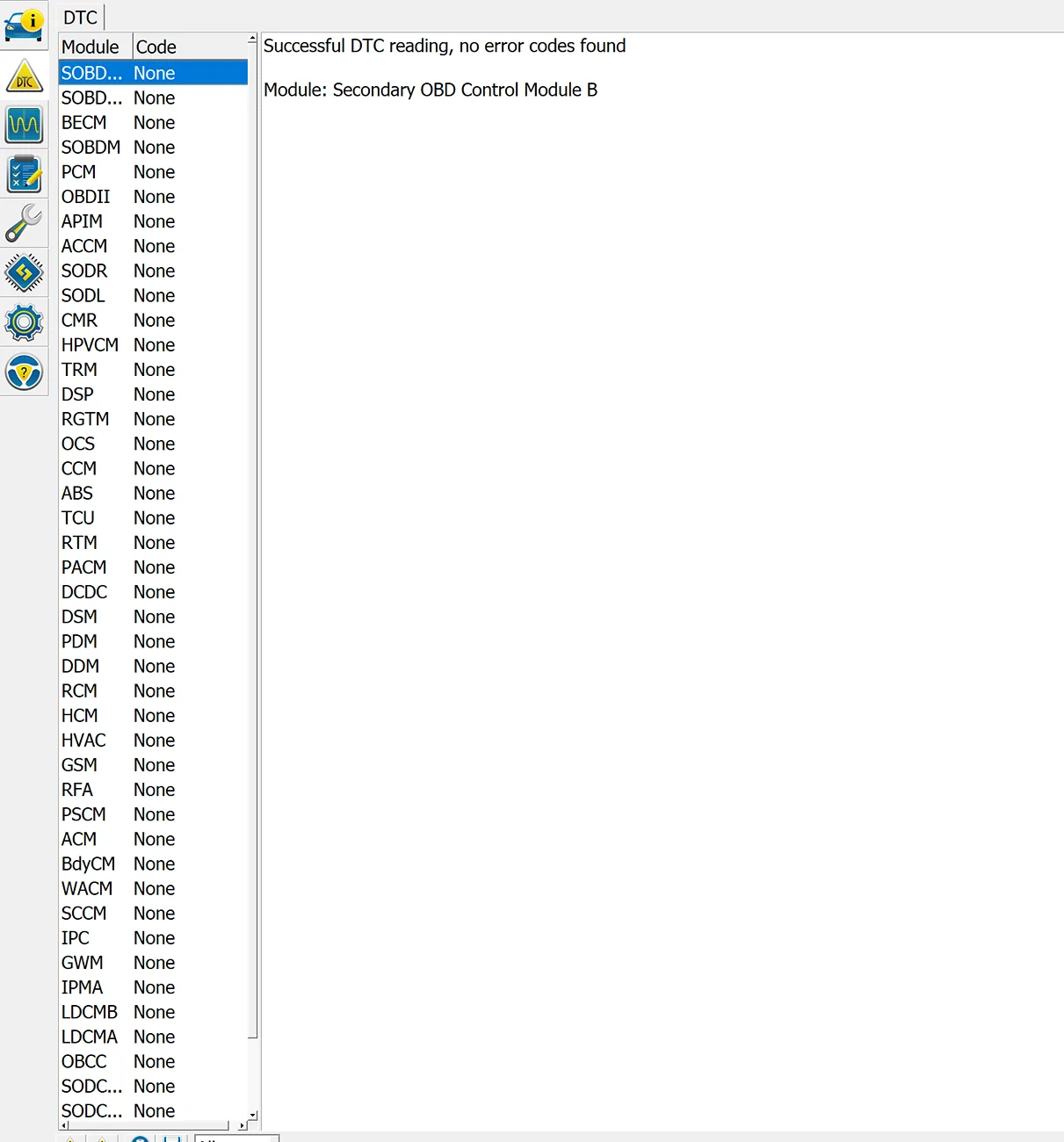

Got my coupler in the mail and installed it. The initial system faults no longer show up, which is great. But I have a lingering "Service Vehicle Soon" warning after the comma starts up. The warning does not show up right at start up, only after the comma is fully powered up. I've checked the DTCs and have cleared all from the previous errors and it's all reading as "None" but I'm still getting the service vehicle soon warning.
In the app, I get Powertrain Malfunction/Reduced Power warning on the service page but I don't have any reduced power and no other issues. Where can I look to reset this code and get the wrench/service vehicle soon off the dashboard?
I would try to remove the 12 volt negative for 20 minutes at this point to see if you can reset whatever module is still holding your SSN warning. It won't hurt anything and might fix it.
it’s only with the Comma installed. If I disconnect the USB C and start the truck, I don’t get the service vehicle soon alert on the dashboard. It’s persistent in the FordPass app though.
Try installing the comma with just the short USB C cable directly to the comma harness and see if the error stays.
