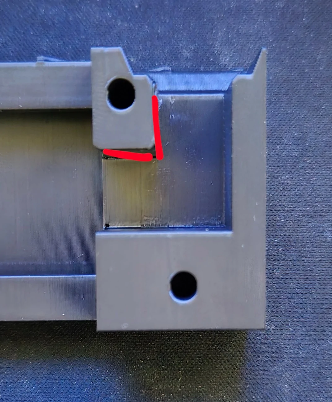

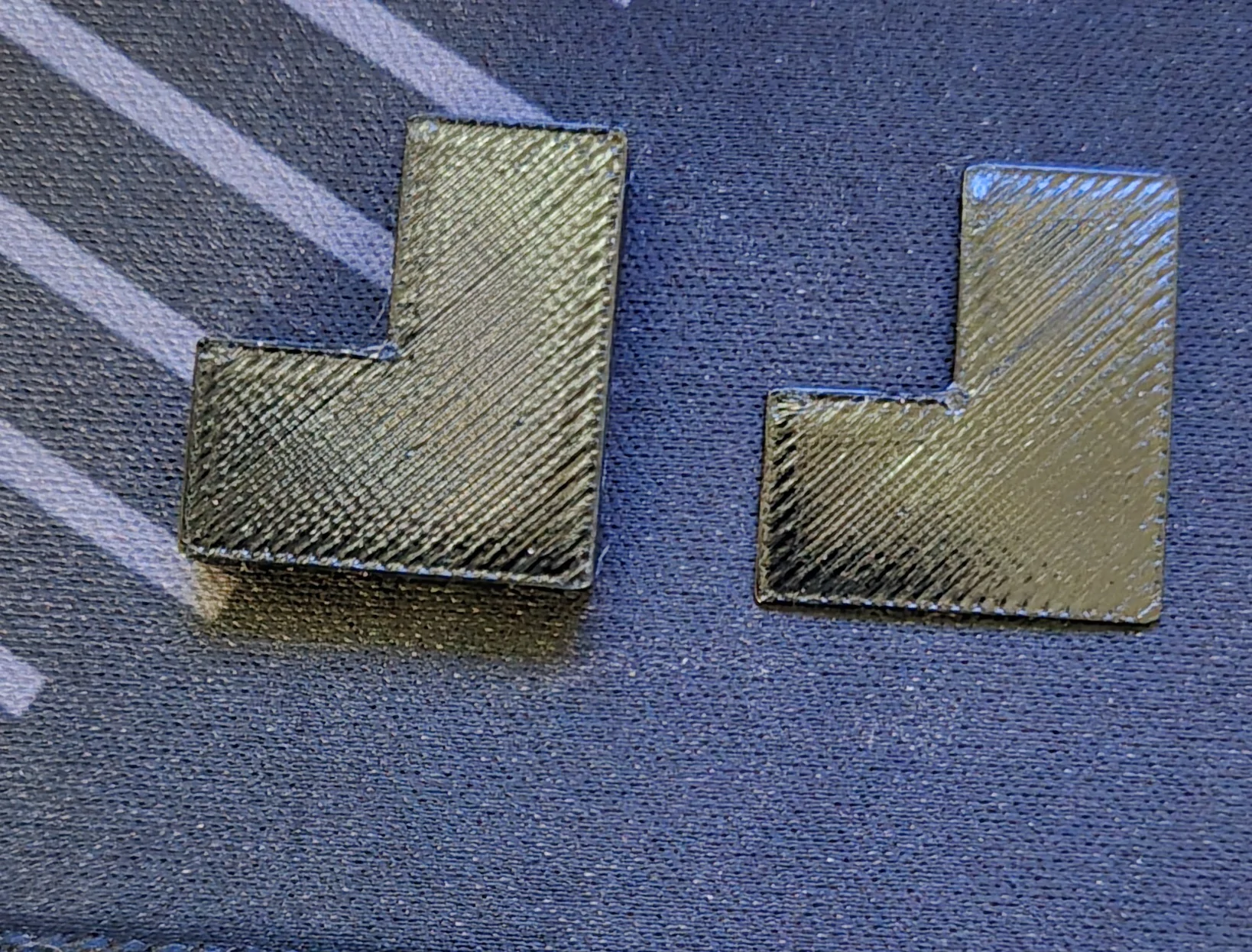

Those that are doing the retrofit:
You may need to lightly file the top corner of the dock for the coupler to seat all the way down, that spot has some support marring that can cause it to not seat fully. Don't go too aggressive, it takes maybe 3-5 strokes of the file to get it right. The thin TPU shim goes on the bottom and the thick shim goes between the coupler and the top plate.
