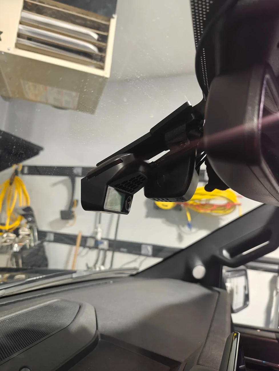

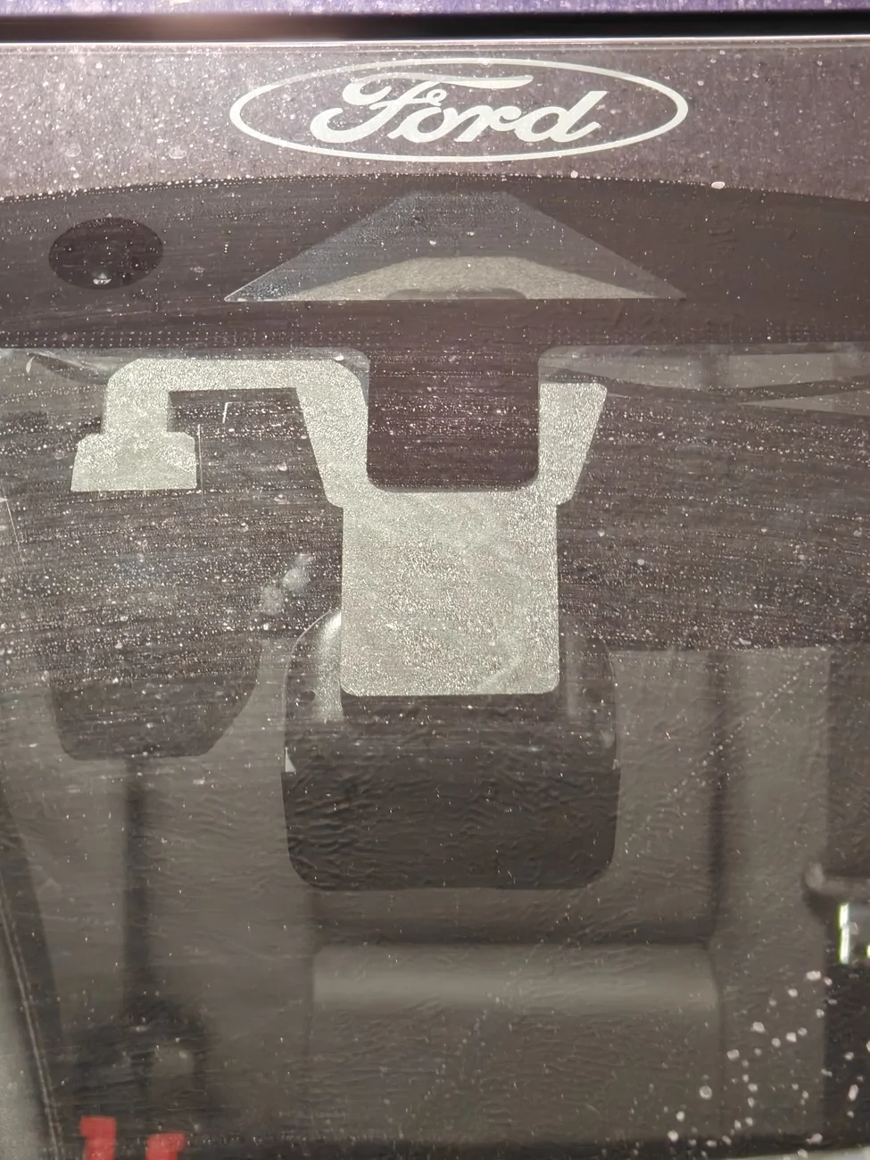

Do you guys think the C4 would hang too low if it was mounted to the bottom of the FCX?
I'd like to have my C4 below my FitCamX.
I'm 6'5" and I believe at my eye height, view of the C4 would be blocked by the mirror if it is mounted where the FitCamX is currently located.

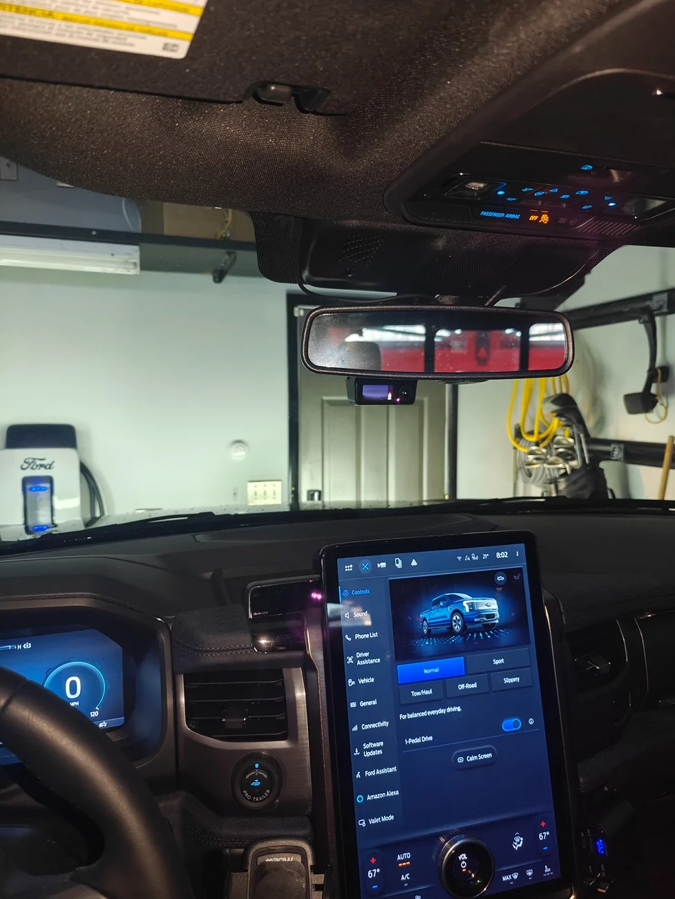

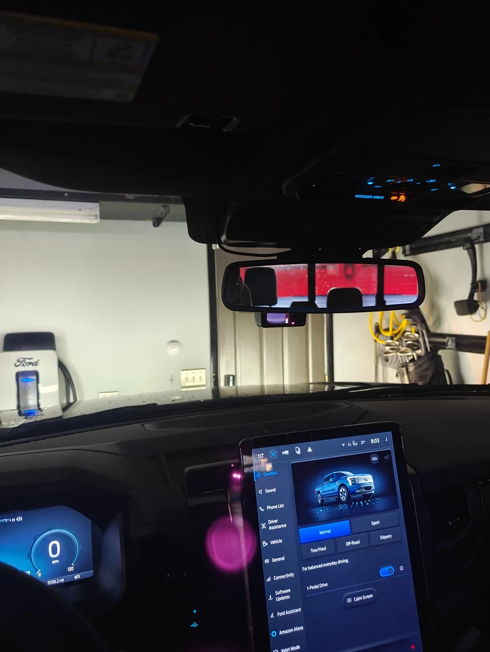

Not sure if this is helpful, but
Ford F-150 Lightning Comma AI self driver assistant IMG20260226080238
Ford F-150 Lightning Comma AI self driver assistant IMG20260226080341
I'm 6'2 and I took a photo approximating my eye line in the first photo, and then about 3-4 inches higher to simulate your eyeline as best I could guess.

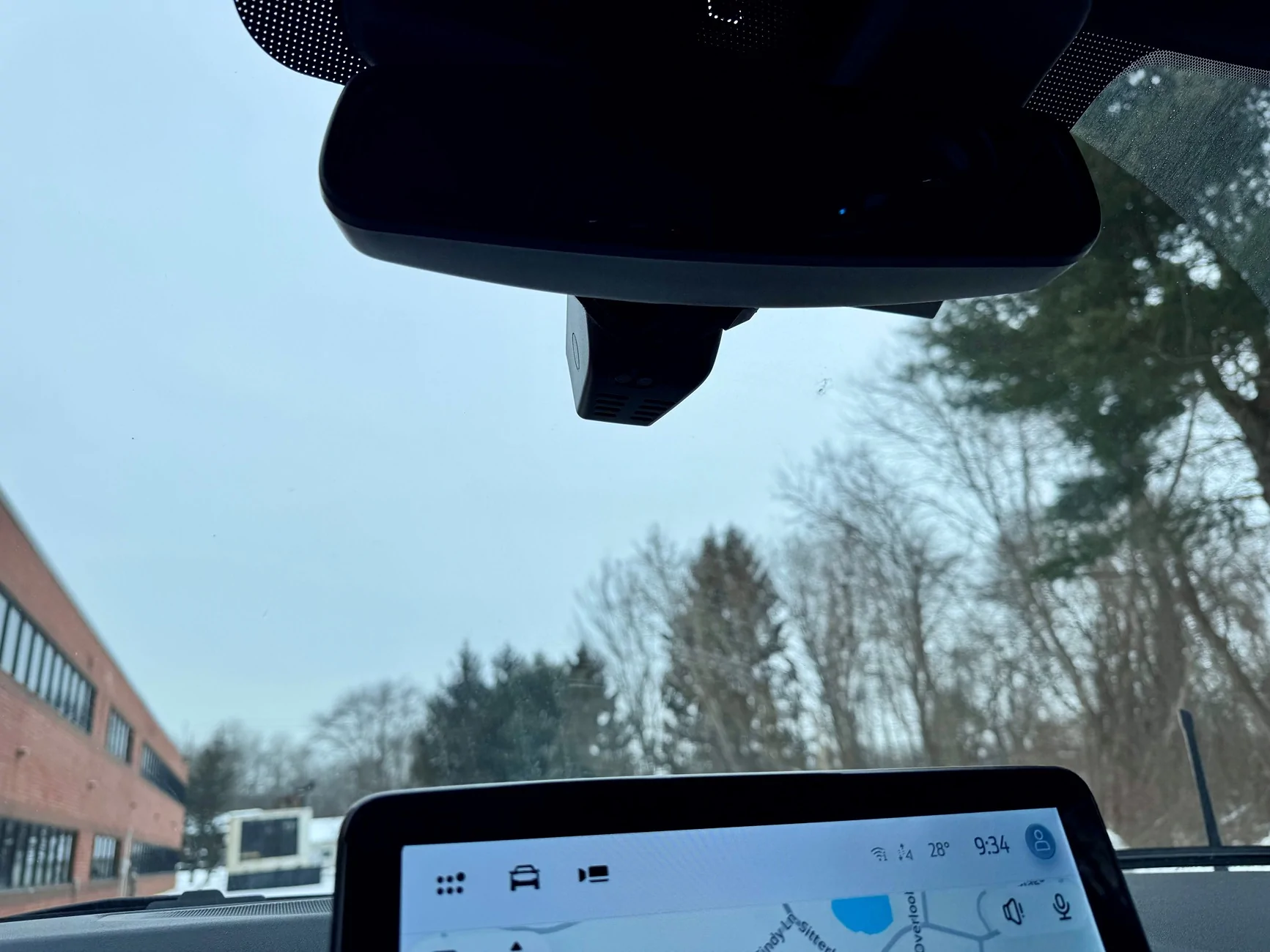

After playing with a real FitCamX I ordered just for this activity,, I've decided that the best path is very similar to what @Ramblinman86 already posted. The FitCamX is really light and can be moved without worry of leverage on the mount. I'm going to design a mount that moves the FCX up and to the drivers side, so that it stays hidden behind the mirror. The mount will be super simple, and so cheap to make that I'm going to be giving it away. If you want one, you'll just need to cover the cost of shipping. If you order a dock, it'll get thrown in the package with the dock.
Now THIS I would be interested in!! My Radar Detector is behind the mirror on the passenger side, and I don't want to move that too. The original bracket pic would have made me do that. If instead you move the FitCamX to the driver's side, I'm all in. That's exactly what I was going to do using 3m tape.

the problem I’m finding is that it blocks the comma from docking If it’s on the drivers side. Still playing with ideas.
Yeah, I was worried about this exact issue which is why I haven't done anything yet. It's still COLD here in the Northeast, so not a good time to mess with 3M tape. I need to disconnect everything and test fit to make sure the comma can still slide left, out of the dock. I assumed I'd have to move the FitCamX up and the C4 down a bit, but haven't played yet. Brrrr. Too cold still.
That's the other advantage if you come up with a dock. I won't need to wait for temps to increase or for someone to loan me their heated garage. :)

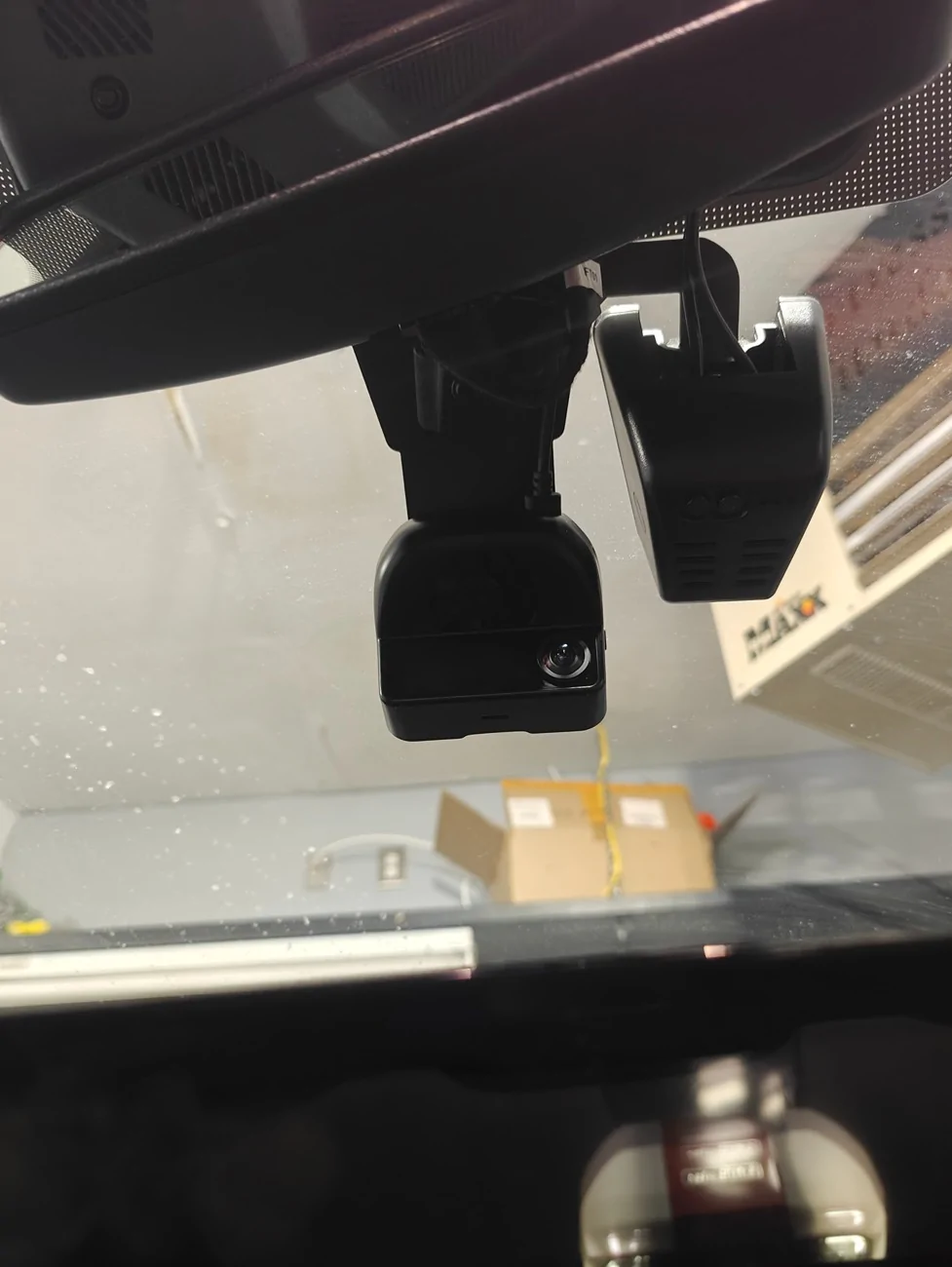

Here is my current design, still need to clean it up a little to look more sleek. It's a slight modification of @Ramblinman86. It mounts it higher and adds a little angle to it for a more flush seat. The final version will be printed in a GF ASA to match the docks I sell.
It's not visible from the driver's seat, so no additional blocked view.
It's not blocked by a C3X or C4

Passenger side. Bummer.
