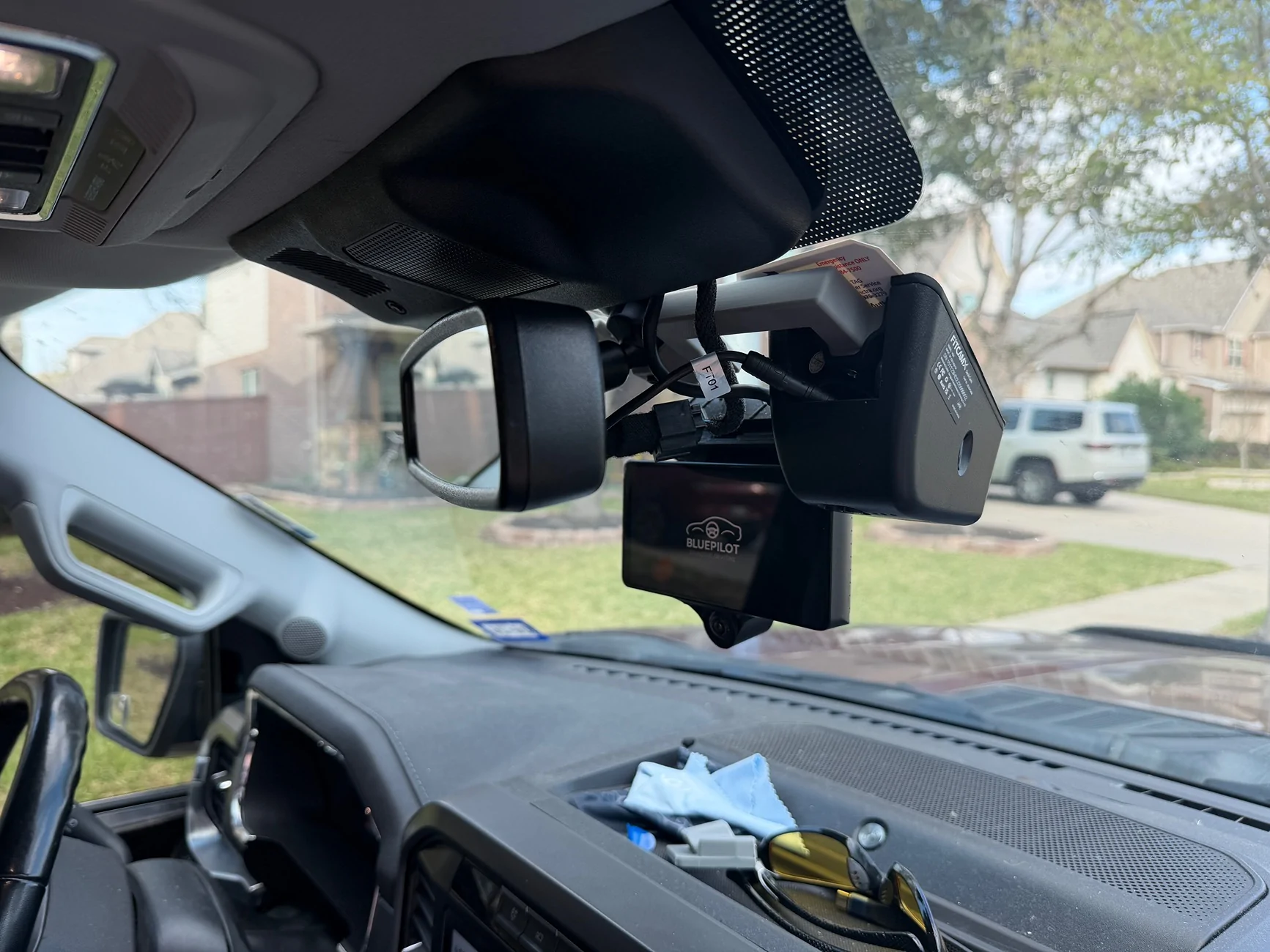

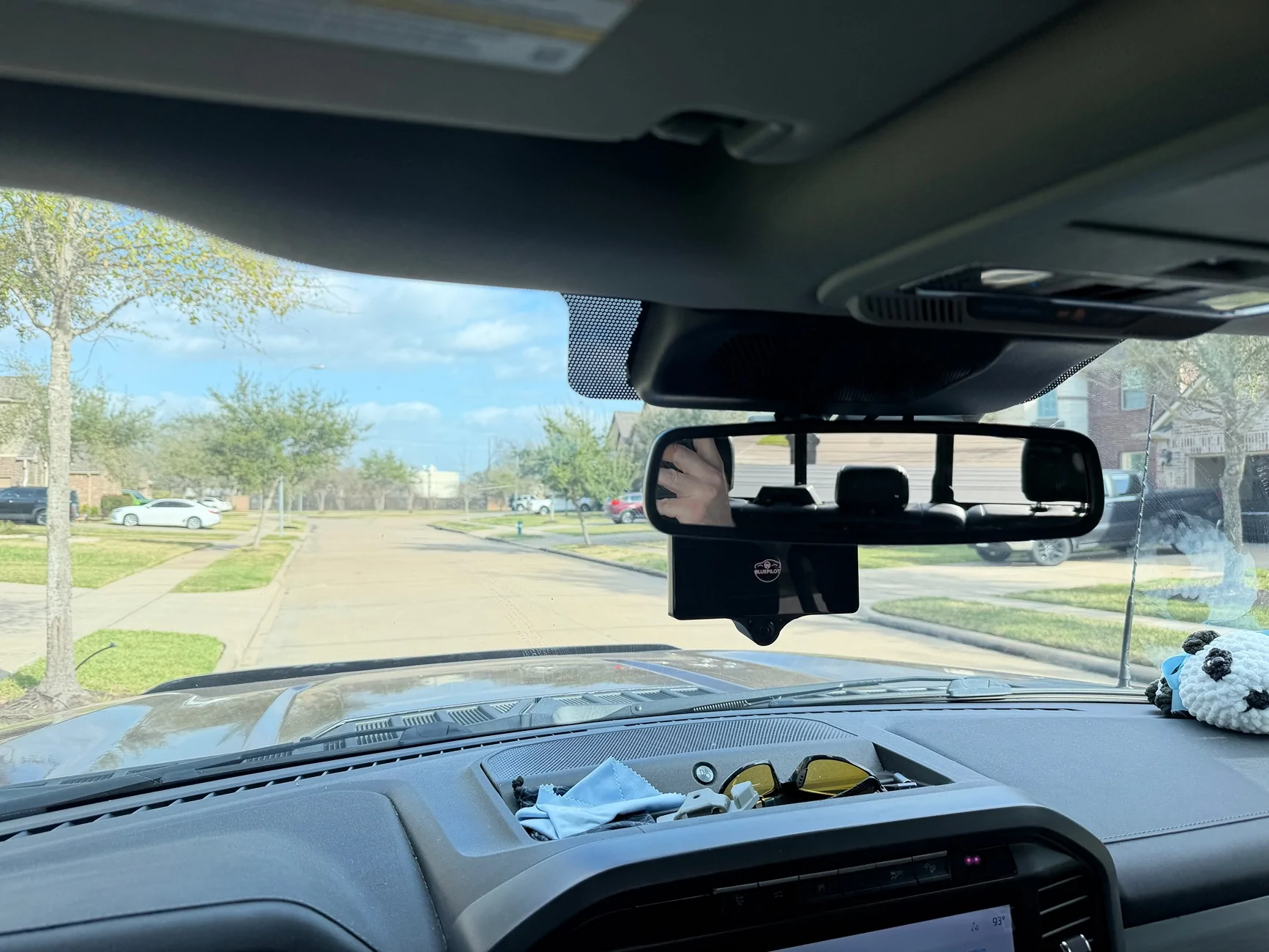

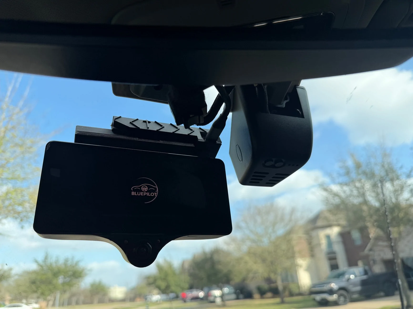

drivers side would be okay if mount the c4 low enough. Its not hard for me to mirror this design for you.
That would be awesome. I do have your c4 sliding dock, so as you mentioned, clearance for the slide is the only issue. I’d definitely buy the mirrored version.
Just send me a DM. I should start shipping some early next week. I'm designing them to take a 10-24 heat insert instead of a self-tapping screw, and I'm waiting on that hardware to come in. Should be here Saturday.
