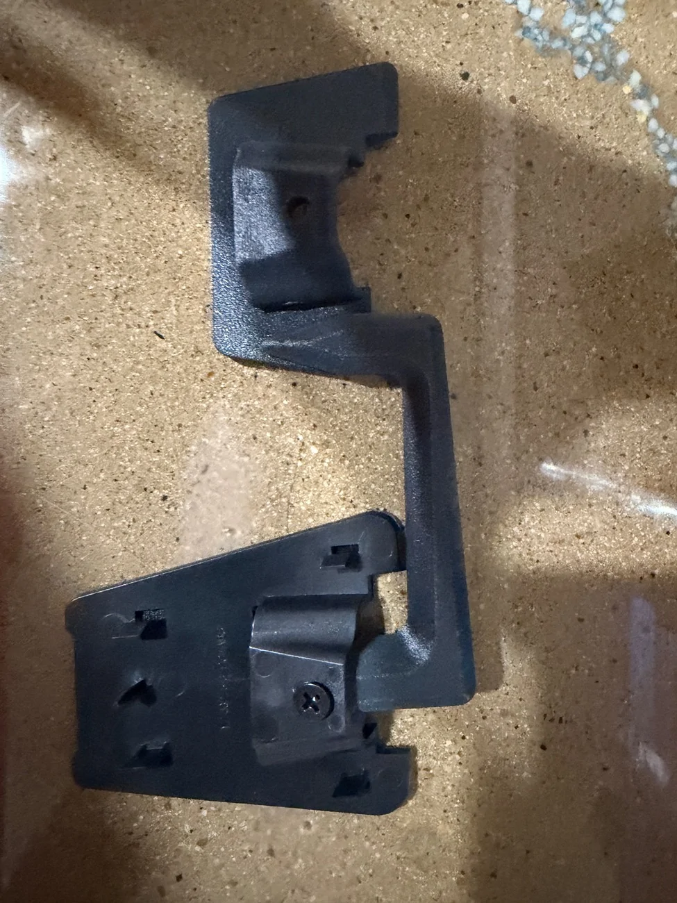

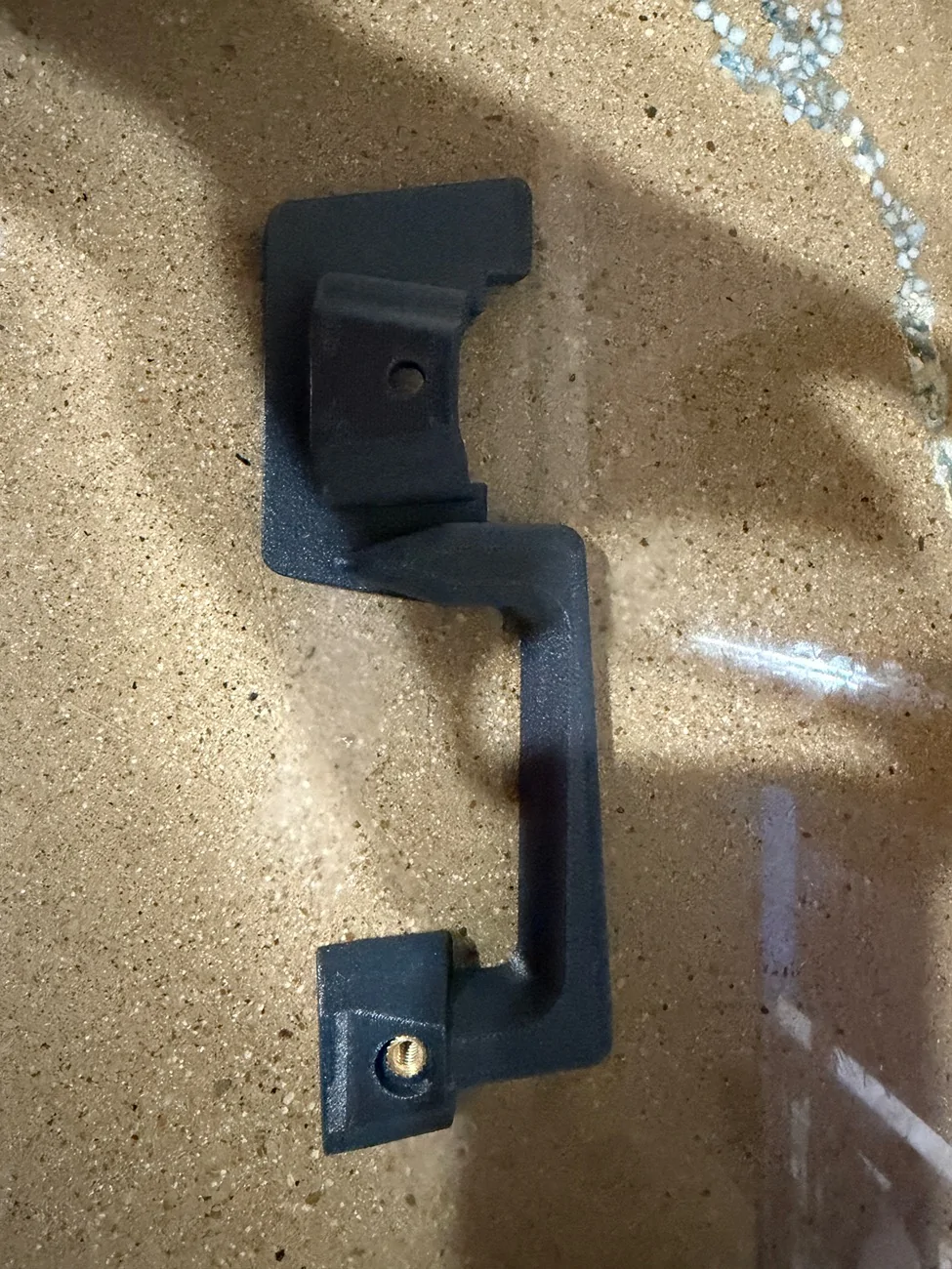

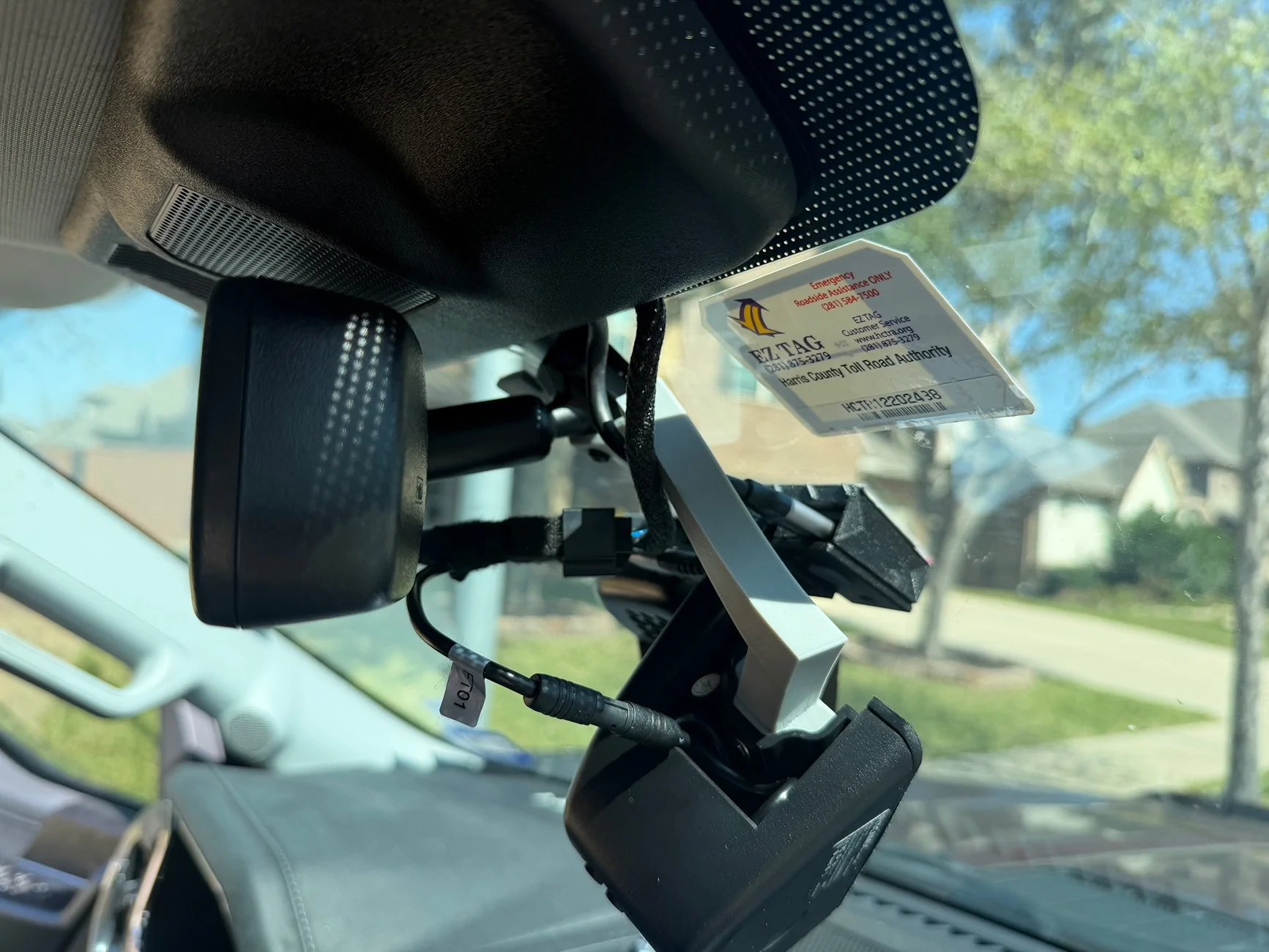

I make all of my prototypes from PLA because it is cheap and easy compared to automotive grade filaments. I left ths one up this morning when I tested it. 3.75 hours later and it is only 81F today.
Ford F-150 Lightning Comma AI self driver assistant IMG_5033
