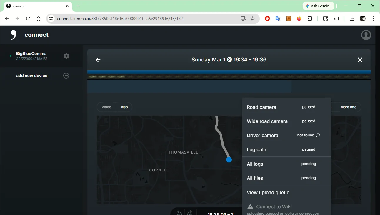

I am not near the truck right now and there is no wifi. I can connect to it via Comma Prime, but it is saying all the uploads are paused waiting on wifi. Does Sunny Pilot not permit uploading via the LTE modem? If that is not the default behaviour, is there a way to make it so? I don't have wifi access in our parking deck at home.
The LTE hotspot is off when the truck is off.

just take the device inside and power it with a phone charger overnight to upload logs
