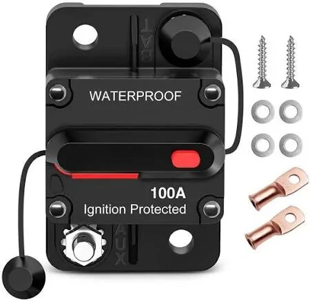

For the amount of times one is required to powercycle this damn thing, Ford should just put a 100A breaker right next to the battery.
You could retrofit one like this, then it would be just as simple as resetting a GFCI.

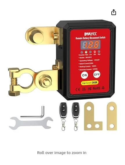

@rugedraw recently recommended one of these 12-volt battery switches:
https://www.amazon.com/IMAYCC-Batte...0D2K7CV69/ref=cm_cr_arp_d_product_top?ie=UTF8

I can't find which thread him and @Mike G were discussing it. It may have been on the Mach-e forum.
After reading about your experience, I finally ordered one.
We momentarily derailed the FDRS thread here to talk about this recently. :ROFLMAO: Very happy with it.
https://www.f150lightningforum.com/...software-updates-using-fdrs.11029/post-427296
