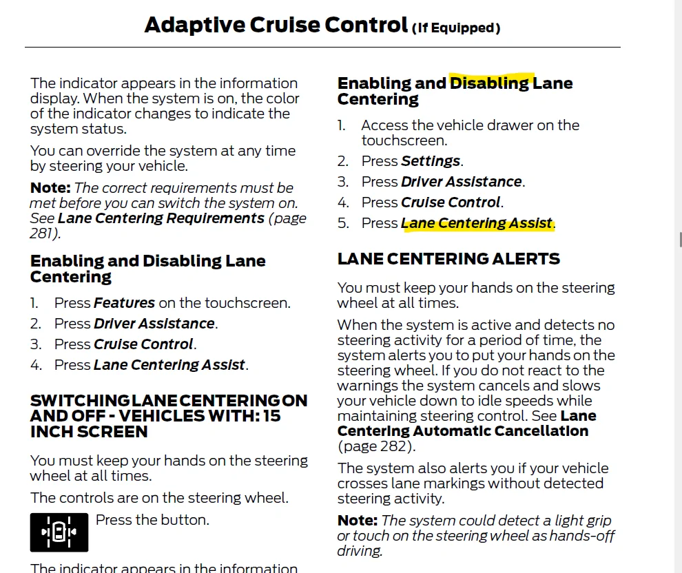

HOW DO I TURN OFF LANE CENTERING?
Button on the wheel, to right of the cancel button. It will automatically turn on every time you turn on cruise. It stays off if you use cancel/brake and resume.
There is a setting under cruise control that implies you can turn on cruise control without lane centering, but it lies. You have to turn it off manually every. single. time. you turn on cruise control. At least I have to in my truck. There is a button on the steering wheel for it.

Oh! I forgot that existed. I used it a long time ago but discovered if you do that, it disabled hands free BC as well. Since I don't have BC anymore, I might try that again. Thanks for the reminder!
