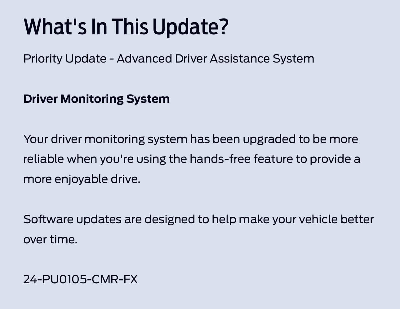

Interesting development for me. Got this update yesterday and now the sensor issue seems to be resolved so far. I wonder if the CSP (that I had completed last week) is actually reliant on this update as well, or maybe it just reset a system that my service center should have but didn’t post update. Who knows. So far it’s looking good though…
This update is very old, hence me wondering if it, in combination with the CSP, is what resolved it.
Ford F-150 Lightning CSP 24B56 - Inoperative Front Parking Sensor(s) - IPMA Software Update for Certain 2022-24 F-150 Lightning Trucks IMG_0389

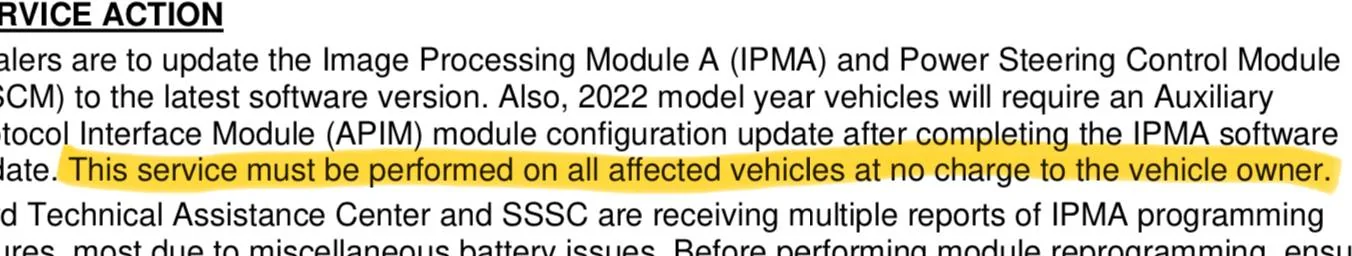

I finally went to the dealer to get CSP 23B70 done (BMS replacement). While there, I mentioned that I also got the CSP 24B56 front parking sensors notice. The customer service rep said that if I'm not experiencing a parking sensor failure, I'm not eligible for the software update. That it's only to repair defective sensors. He said if the sensor later fails outside of the CSP program range (Aug 2025), I'll be covered by the 3-year 36,000 mile warranty, and since I have a 10-year 66,000 mile Ford Protect Extended Warranty, I'd just pay the deductible to have it fixed outside of the standard vehicle warranty period. (I would hope OTA updates will preventatively "fix" the issue down the road, too).
If you look at Ford's CSP 24B56 Owner Letter (Mike G.'s OP post), the notice does seem to announce CSP 24B56 as a repair operation. But if the software update really is restricted only to owners experiencing a sensor problem, the letter is negligent for not definitively stating that.
My dealer rep is a Lightning owner, too, so presumably he knows what he's telling me from both sides of the issue.
BTW, CSP 23B70 was removed from my Ford.com account and FordPass the same day the BMS was replaced (today). There at 7 AM, gone by this PM.
TSBs require a fault but CSPs should be done on all affected vehicles. It’s amazing how incompetent Ford service people are.

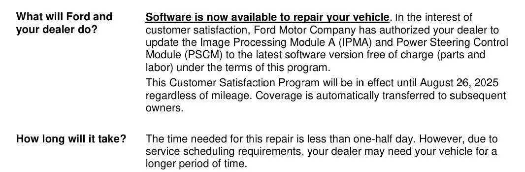

I'd say the ambiguity is precisely what is an "affected vehicle?" The documents announce that Ford is performing a software repair of defective sensors. My sensors are showing no defect, and the service rep said if the defect is there, it's inescapable as my screen will be flashing a warning at me.
Ford F-150 Lightning CSP 24B56 - Inoperative Front Parking Sensor(s) - IPMA Software Update for Certain 2022-24 F-150 Lightning Trucks 1726801395213-wu
I do plan to call Ford tomorrow to find out what they mean by software repair vs. affected vehicles.
I have to admit, though, that, on reading the context of the CSP 24B56 Dealer Bulletin that Mike G. posted in his OP, the term "affected vehicles" applies to all vehicles within the listed date span.
Two quotes:
US population of affected vehicles: 48,748...
Some of the affected vehicles may exhibit an inoperative front park aid feature with a “Front Parking Sensors Not Available Sensors Blocked See Manual” message in the Instrument Panel Cluster (IPC).
The second quote clearly indicates that vehicles with a blatant sensor defect are only a SUBSET of the affected vehicle population, which quote #1 defines as the total number of vehicles covered by the date span of the CSP. Hopefully, I can get someone at Ford to OTA update (so to speak) my dealer's view of the CSP 24B56.
