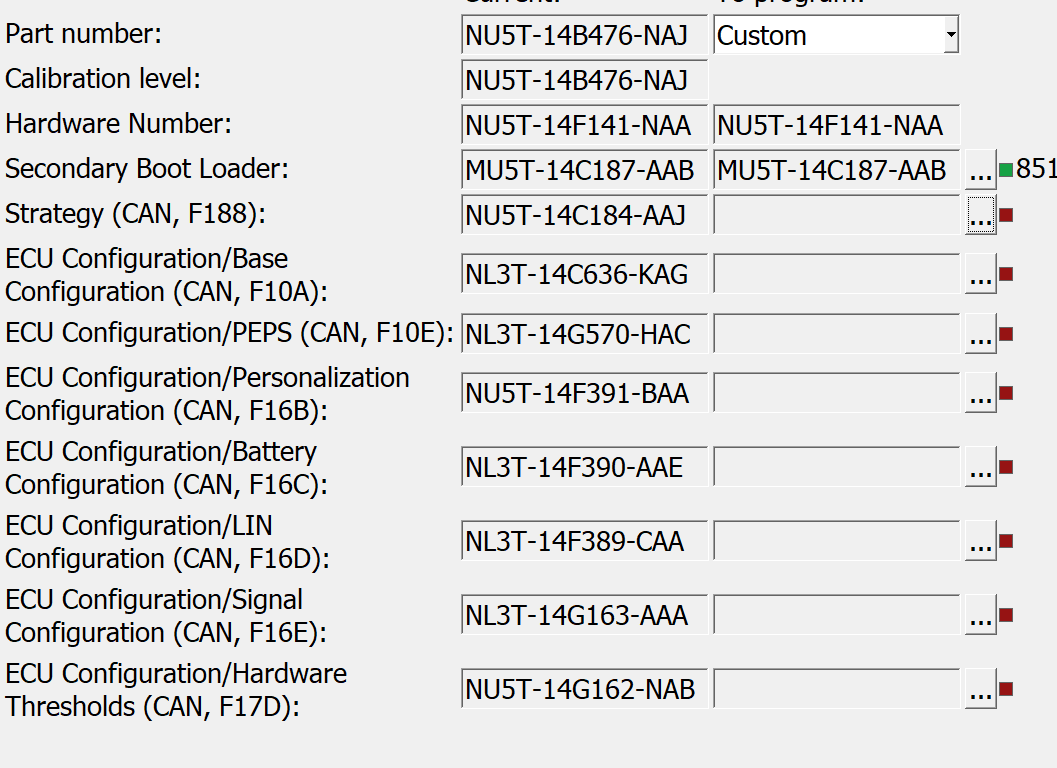

Ok, now I'm confused on the firmware update. Am I supposed to put those values into a file for the system to write? Also, I don't appear to have some of the sections that you had values for, is that an issue or do those values overwrite?
No all configuration changes are done in the As-Built area like other configuration stuff. Execute the changes the same way and you should be able to get the handle working and responding to the capacitive buttons PIDs. Where you have custom selected there should be a drop down for available. But as of just last week it was not there yet. This means you will need need the files. I will send to you in a PM.
Yeah, the configuration changes I already made and those all worked fine, even the light on approach worked. I think I found where to download the files from, but the link said I didn't have permission to access the site. I appreciate the help!

Firmware update was successful and really easy! Forscan doesn't even let you try to choose the wrong firmware file for the update, so that made things a lot quicker. Just make sure your laptop is charged up and not going to do a restart in the middle of the flashing and you should be good to go!

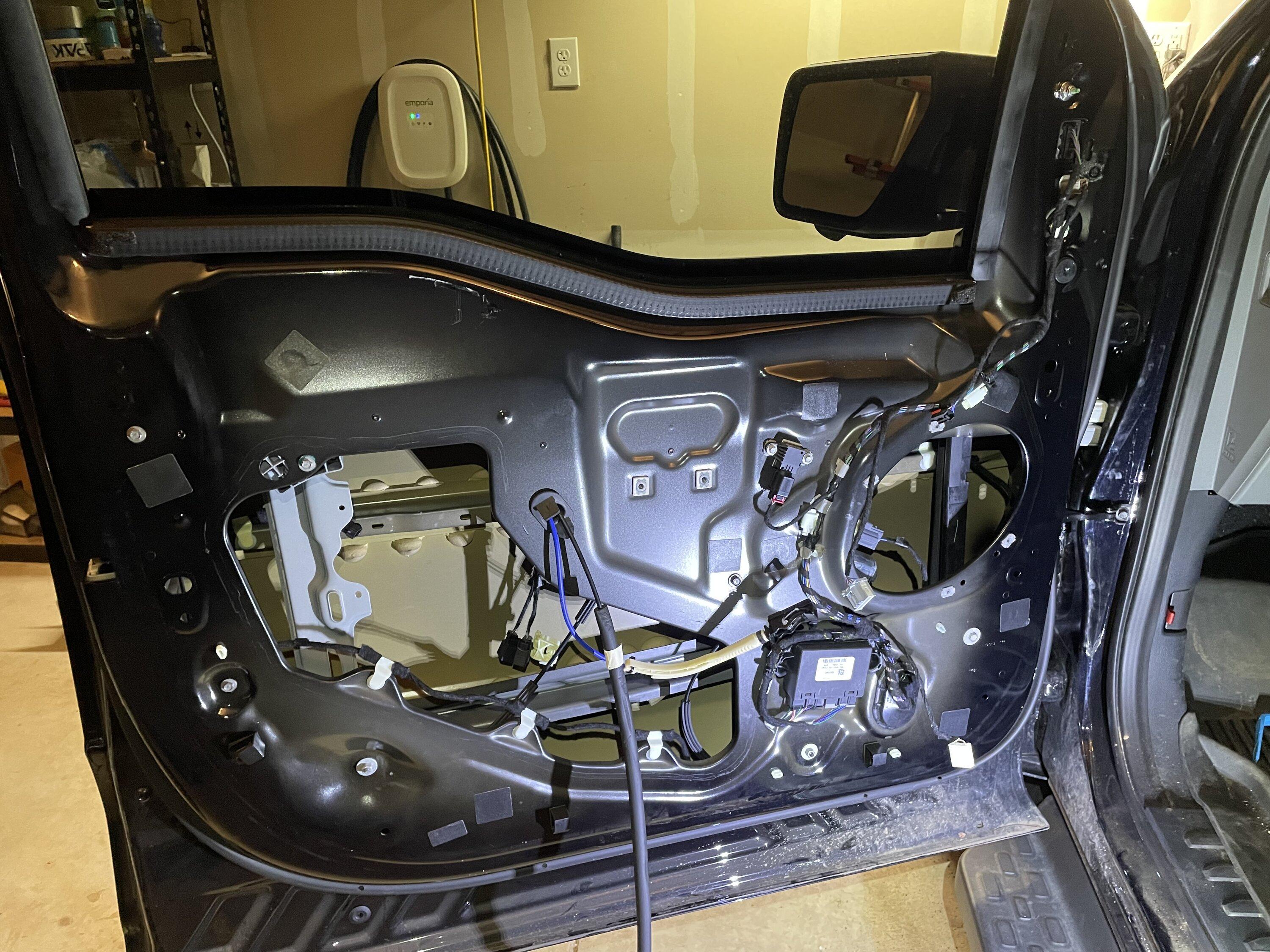

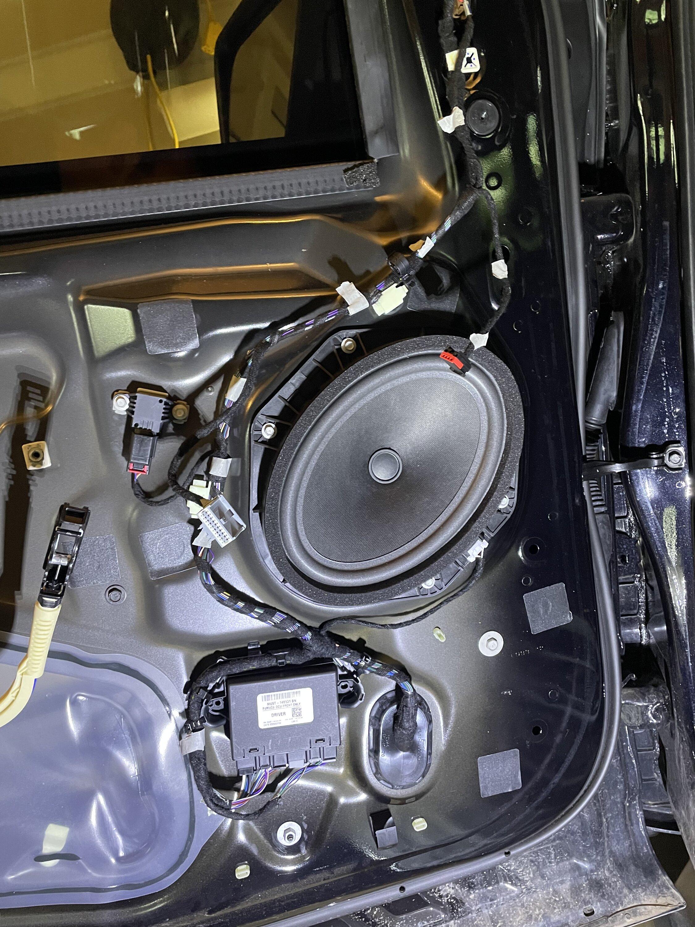

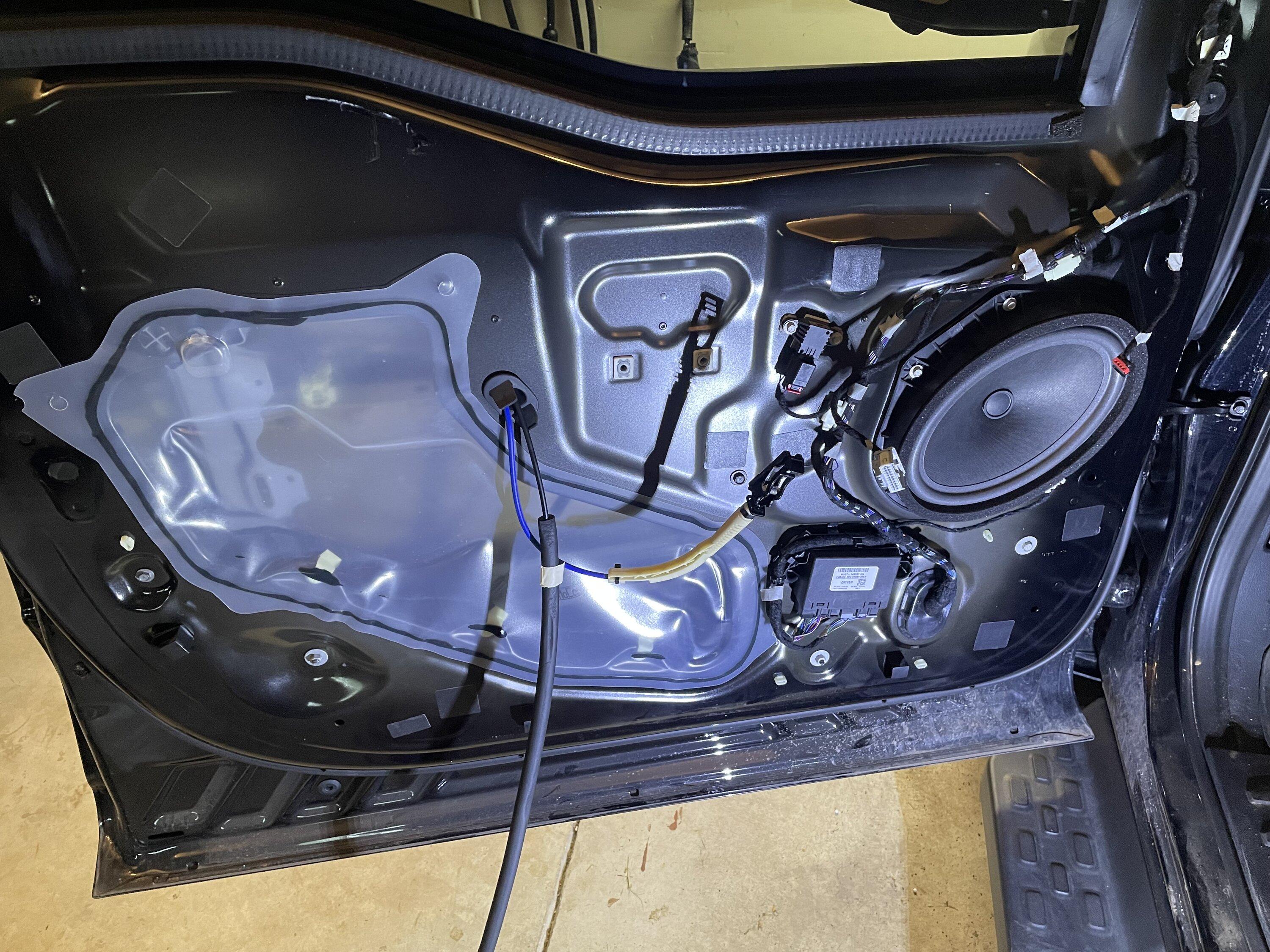

Just finished this as well today. Everything is working as it should. Unfortunately I ran into a few issue which I would like to help the next person avoid. As jdmackes mentioned remove the speaker and loosen the lower window guide rail, it will make it much easier to fish the harness in and out.
Secondly if you have adaptive cruise your value for 726-16-01 should be C110 4390 60 if you have regular cruise control like me keep it at C110 4388 60.
Additionally you'll want to request the files from Forscan for the firmware update prior to starting. I did not have these and got them from ZSC100.
Overall the process took me about 4-5 hours. Not sure how people got it done much faster. And last of all a huge thanks to both ZSC100 for figuring this mod out and helping me with the install, and JDMACKES for also helping during the install. I definitely couldnt have done it without either of their helps.
Now to find out the equivalent passenger part numbers…….
