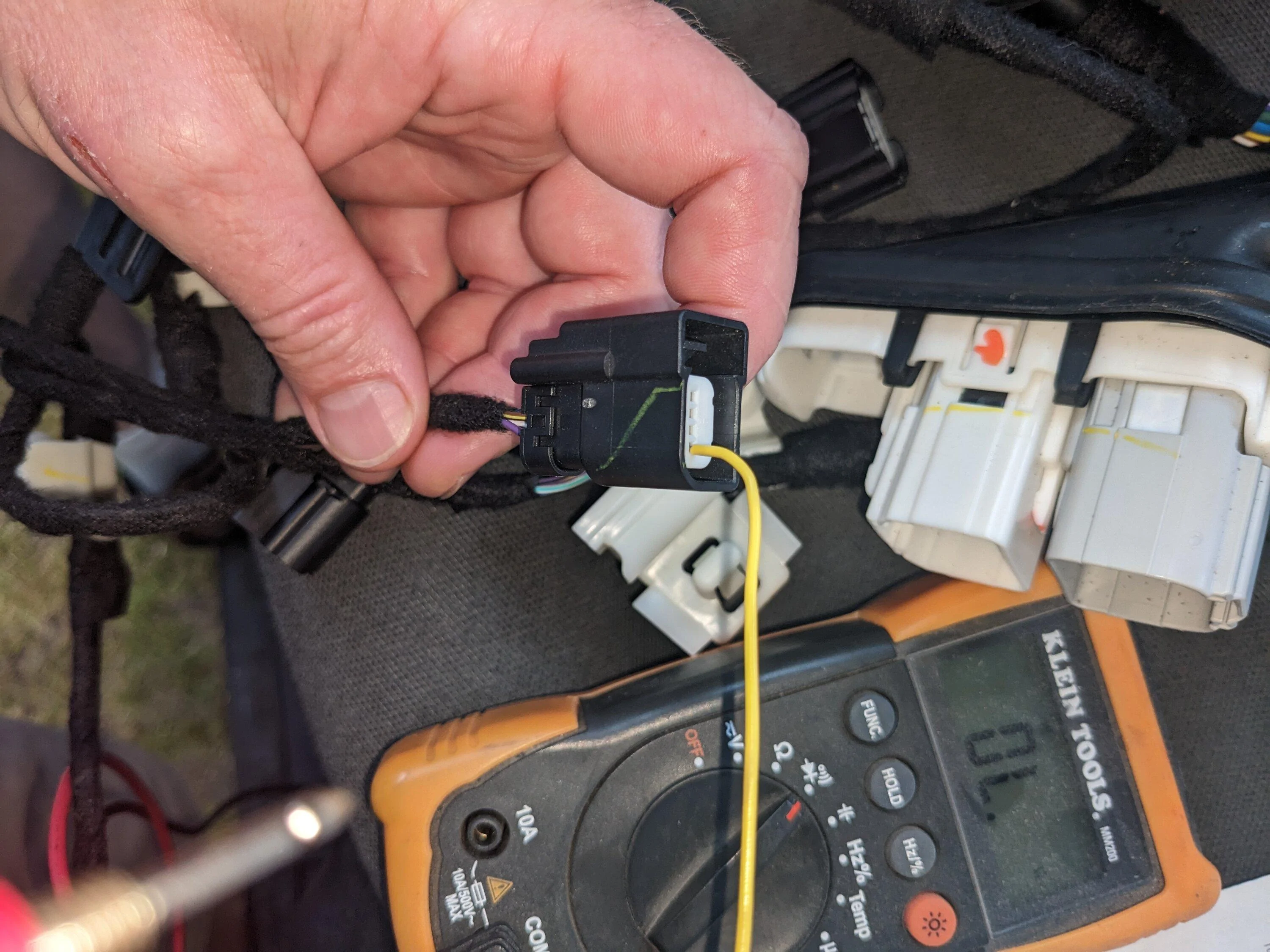

Changing the door harness if you've made it this far is honestly a breeze. The only difficult part is getting the door jamb connector popped out. I used some special mechanic pics and my new harness to learn how it worked; if you peel back the rubber boot and pick at it just right you can pop all the tabs loose and it comes right out.
Then, to release the connectors use an appropriately sized flat head screwdriver and push/twist with finesse:
I won't bore you with all the electrical tests I did to make sure the wiring was in place, but in my truck the wiring from the door jamb to the BCM was already in place and ready to go, thank you JESUS. The colors weirdly don't match Ford's wiring diagram which is VERY, VERY concerning, and they use 3 of the EXACT same wire colors, idiots, it's a wonder they got it right, but they did. Here are some pics showing this in detail:

So, I just wanted to put those diagrams here so you can visually compare and check that your wiring is in place and correct if you want.
