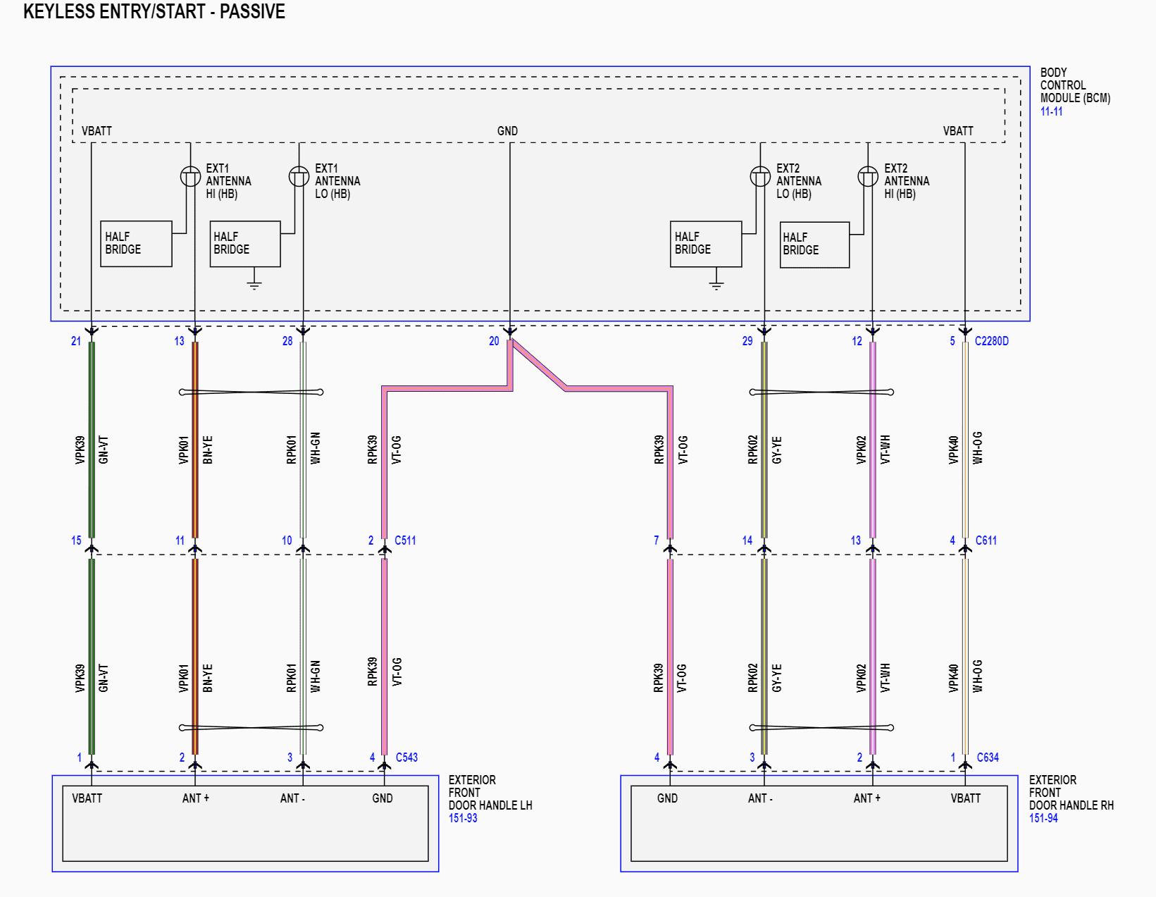

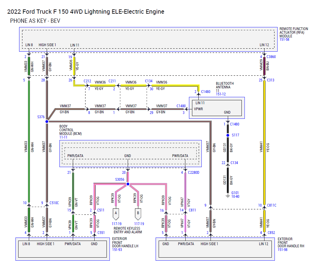

Lariat and Platinum Door Handle Wiring Diagram:
Ford F-150 Lightning DIY: Installing Passive Entry To A 2022 F-150 Lightning XLT 1685082899955
Pro and XLT w/EG-312A:
Ford F-150 Lightning DIY: Installing Passive Entry To A 2022 F-150 Lightning XLT Wiring - Passive Entry

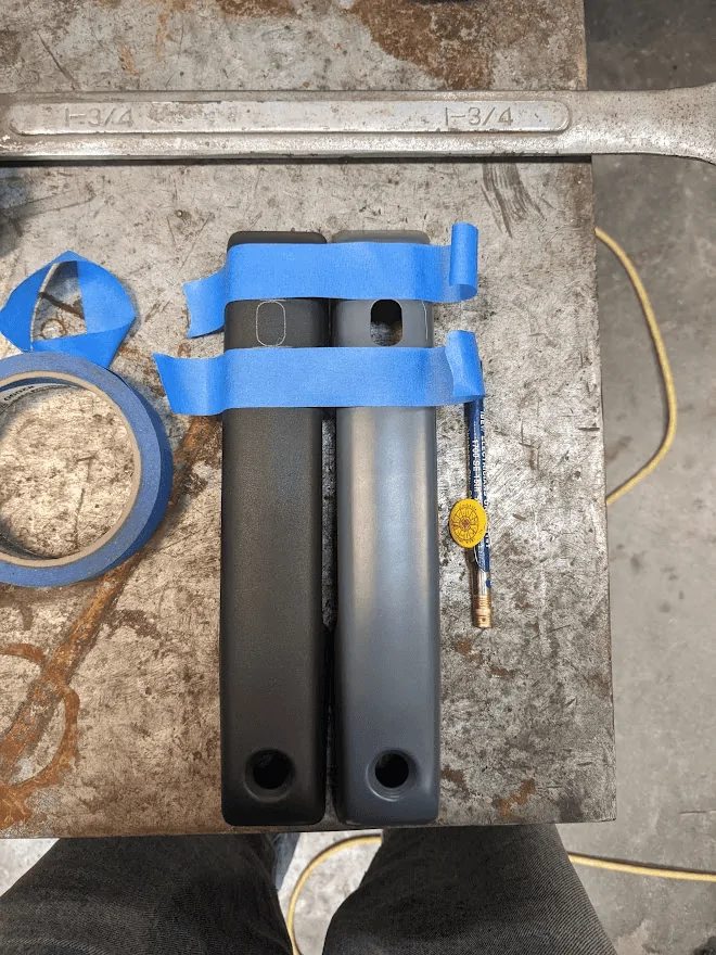

Oh and while were at it, the textured black ABS door handle doesn't come with ANY trucks with passive entry, so if you want matching handles you have to do it yourself. In my opinion the black textured handles are the best anyway, so I made it work, thankfully ABS machines very nicely.
The door handle I bought was the one a body shop would buy if they were going to paint match it to a vehicle: ML3Z 1522405 DCPTM

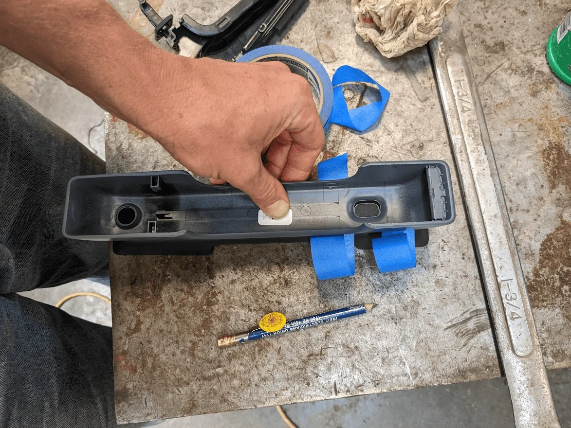

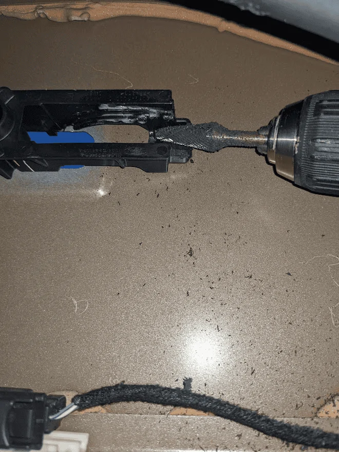

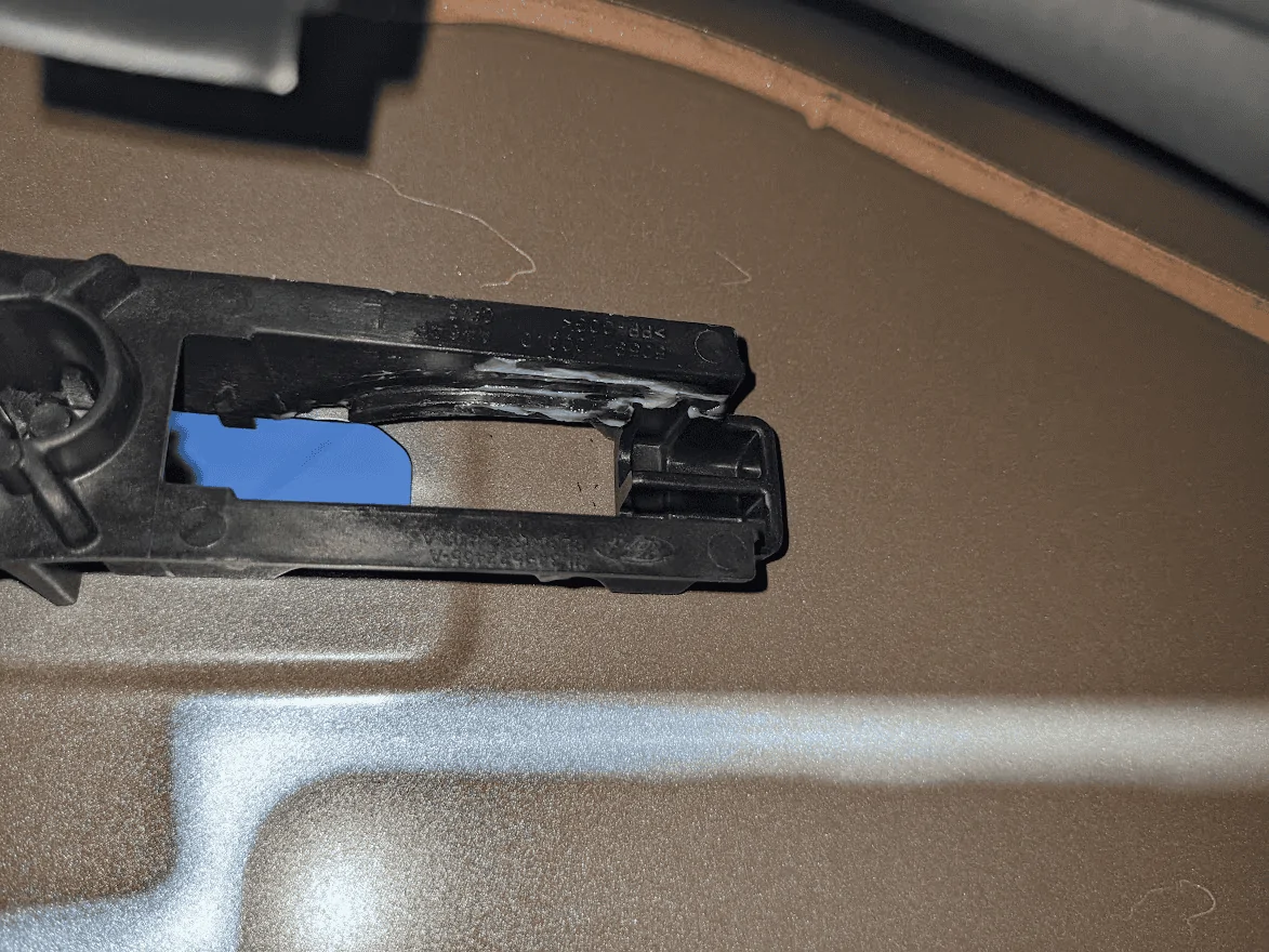

Now to the machining:
Ford F-150 Lightning DIY: Installing Passive Entry To A 2022 F-150 Lightning XLT 1685084037846
Ford F-150 Lightning DIY: Installing Passive Entry To A 2022 F-150 Lightning XLT 1685083990309
Ford F-150 Lightning DIY: Installing Passive Entry To A 2022 F-150 Lightning XLT 1685084055279
Ford F-150 Lightning DIY: Installing Passive Entry To A 2022 F-150 Lightning XLT 1685084083385
Just take your time or find a friend who's good with a dremel :) It's not perfect, but I'm super happy with the way it turned out. I was only interested in doing the driver's door and to be honest I can't understand why anyone would go through the expense or trouble of changing all 4 handles when the black ABS ones look so much better anyway IMO. So, you're not done yet unfortunately, there is a stupid plastic piece inside the door that has to be removed to allow room for the electrical connector:

Don't you dare try to buy this part and change this out internally. Just take your deburring tool and grind the hell out of the little plastic tab in the center while you give Ford engineers a good cussing :)

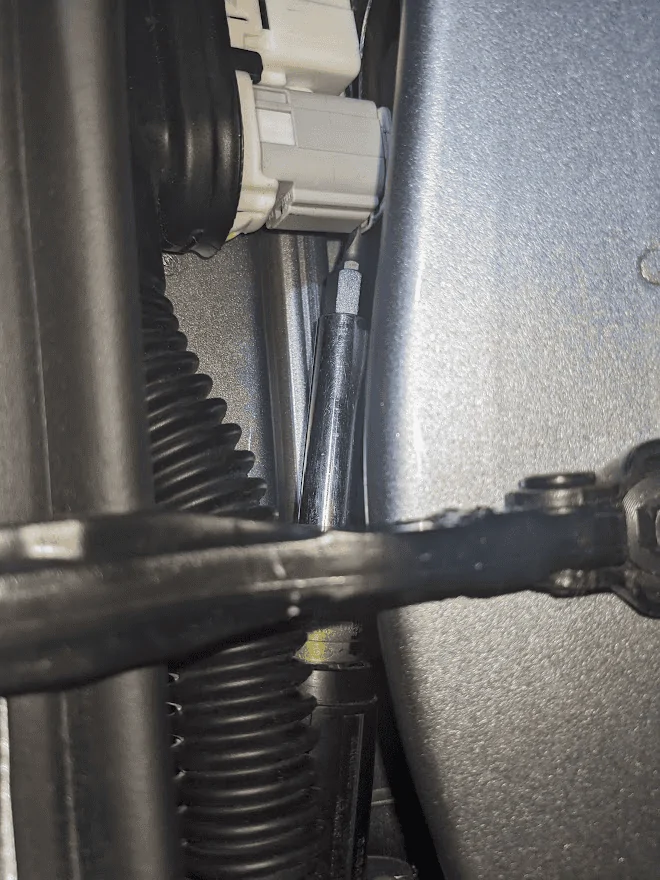

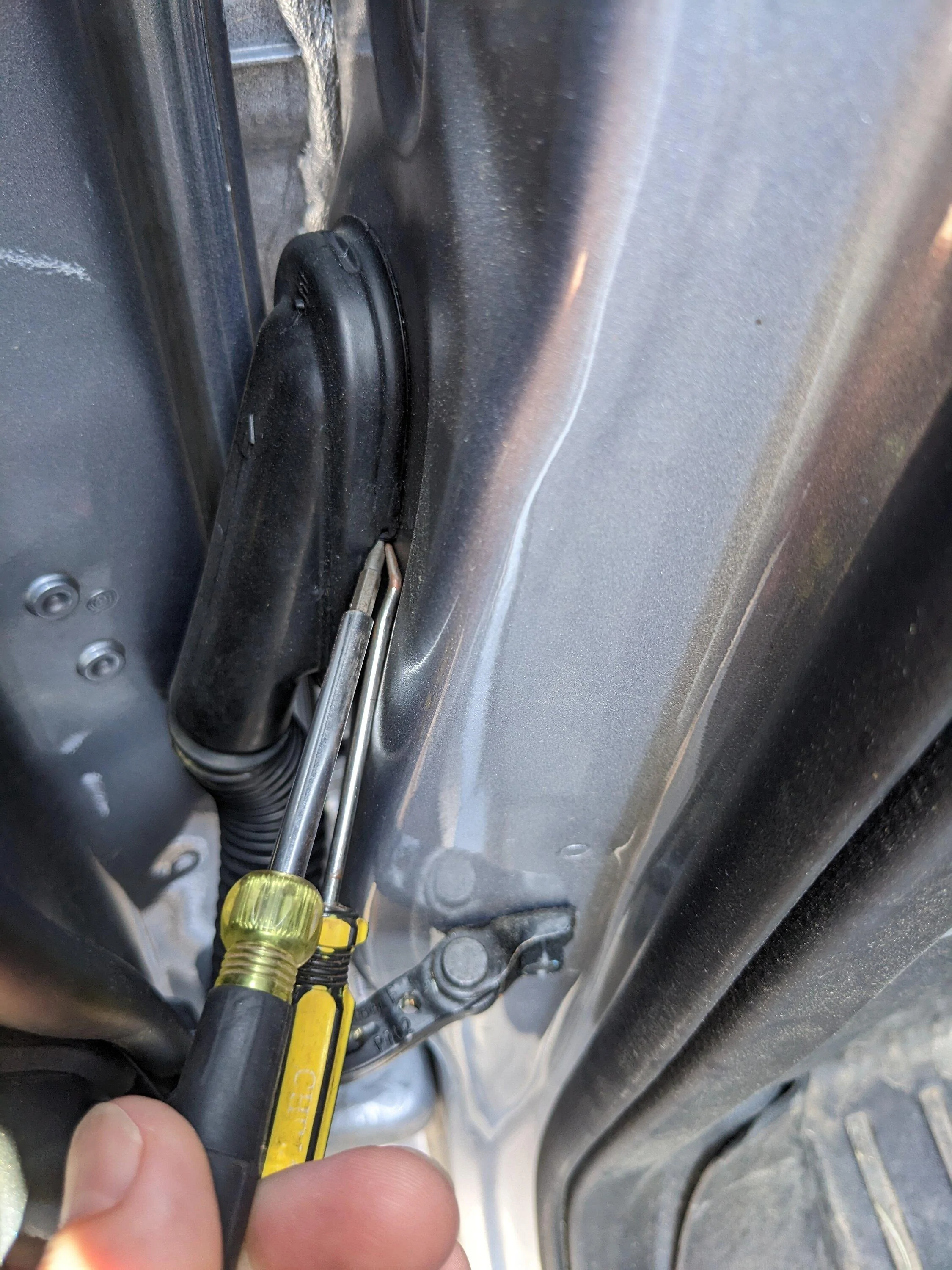

Changing the door harness if you've made it this far is honestly a breeze. The only difficult part is getting the door jamb connector popped out. I used some special mechanic pics and my new harness to learn how it worked; if you peel back the edge of the rubber seal and pick at it just right you can pop all the tabs loose and it comes right out.
The back tab is a real PITA, but if you have a few good mechanic picks and 3 hands you can get it. You only have to do it once, Don't pop that thing back in place until you are completely done with the upgrade and it's working. It can stay popped out a quarter inch, while you're waiting on parts or programming.
Ford F-150 Lightning DIY: Installing Passive Entry To A 2022 F-150 Lightning XLT pxl_20230531_155801307-jpg
You can see the right tab here with an orange paint mark on it, The left(back)tab is symmetrically on the other side, and can only be pushed with a good right angle mechanics pick.
Ford F-150 Lightning DIY: Installing Passive Entry To A 2022 F-150 Lightning XLT pxl_20230515_002318886-jpg

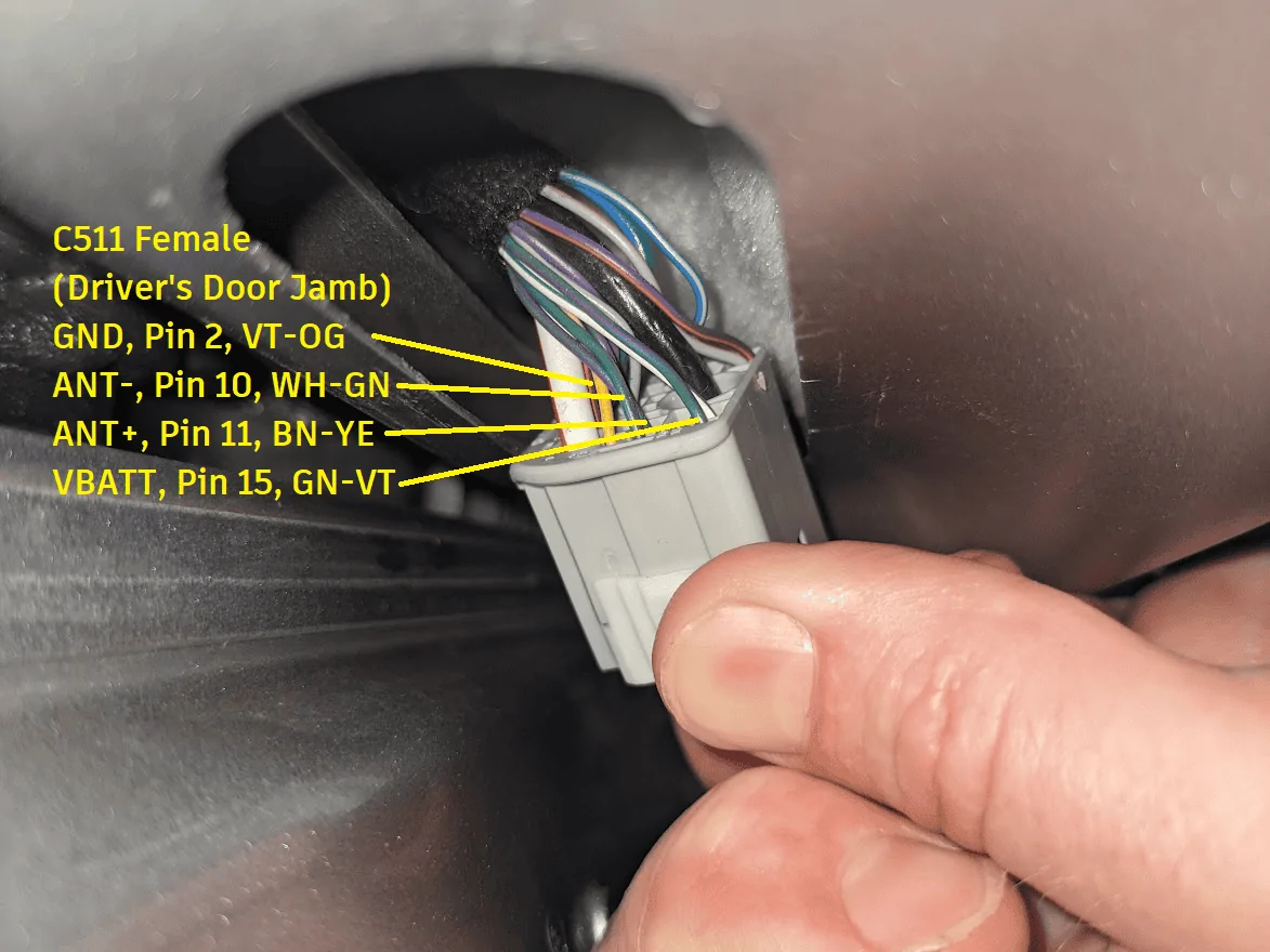

Then, to release the connectors use an appropriately sized flat head screwdriver and push/twist with finesse:
Ford F-150 Lightning DIY: Installing Passive Entry To A 2022 F-150 Lightning XLT 1685084754249

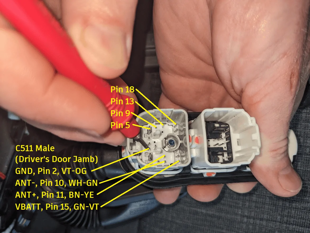

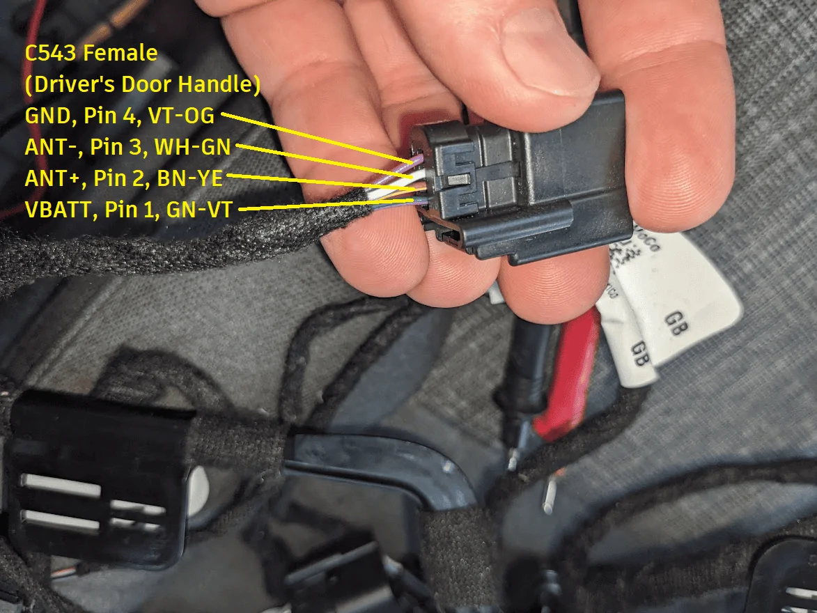

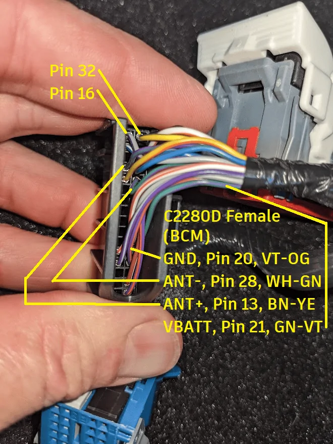

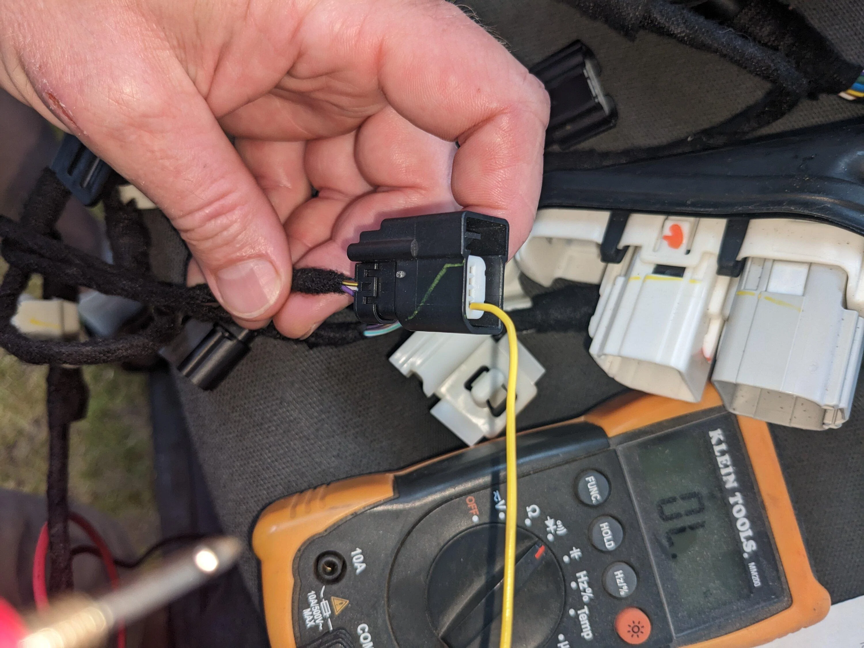

I won't bore you with all the electrical tests I did to make sure the wiring was in place, but in my truck the wiring from the door jamb to the BCM was already in place and ready to go, thank you JESUS. The colors weirdly don't match Ford's wiring diagram which is VERY, VERY concerning, and they use 3 of the EXACT same wire colors, idiots, it's a wonder they got it right, but they did. Here are some pics showing this in detail:
Ford F-150 Lightning DIY: Installing Passive Entry To A 2022 F-150 Lightning XLT C543 Female Back Labeled
Ford F-150 Lightning DIY: Installing Passive Entry To A 2022 F-150 Lightning XLT C511 Male Labeled
Ford F-150 Lightning DIY: Installing Passive Entry To A 2022 F-150 Lightning XLT C511 Female Back Labeled
Ford F-150 Lightning DIY: Installing Passive Entry To A 2022 F-150 Lightning XLT C2280D Female Back Labeled
So, I just wanted to put those diagrams here so you can visually compare and check that your wiring is in place and correct if you want.

Also looks like I don’t have the ANT pins 10 & 11on my c511 plug. Is this after you swap the harness? Does it go from C543 to C511?

So if I’m reading this right only 2 parts for roughly $200 total? How many hours do you think it took to do all the work once the handles were drilled open?
Since the FORScan public server isn't really accessible and the FORScan team sometimes responds slowly, here are the BCM files for this project (From Jesse @ Infotainment):
Lightning SR EG 312A files:
Yes, only 2 parts. If I was to do it right now, I'd say I could do it in 2hrs easy. Yes, no need for a parts person if you just order the harness I listed. That is exactly what my factory (no passive entry) C511 Male connector looked like. Look at your C511 Female that plugs into that and make sure you have those two ANT wires, if so, you're good to go:
