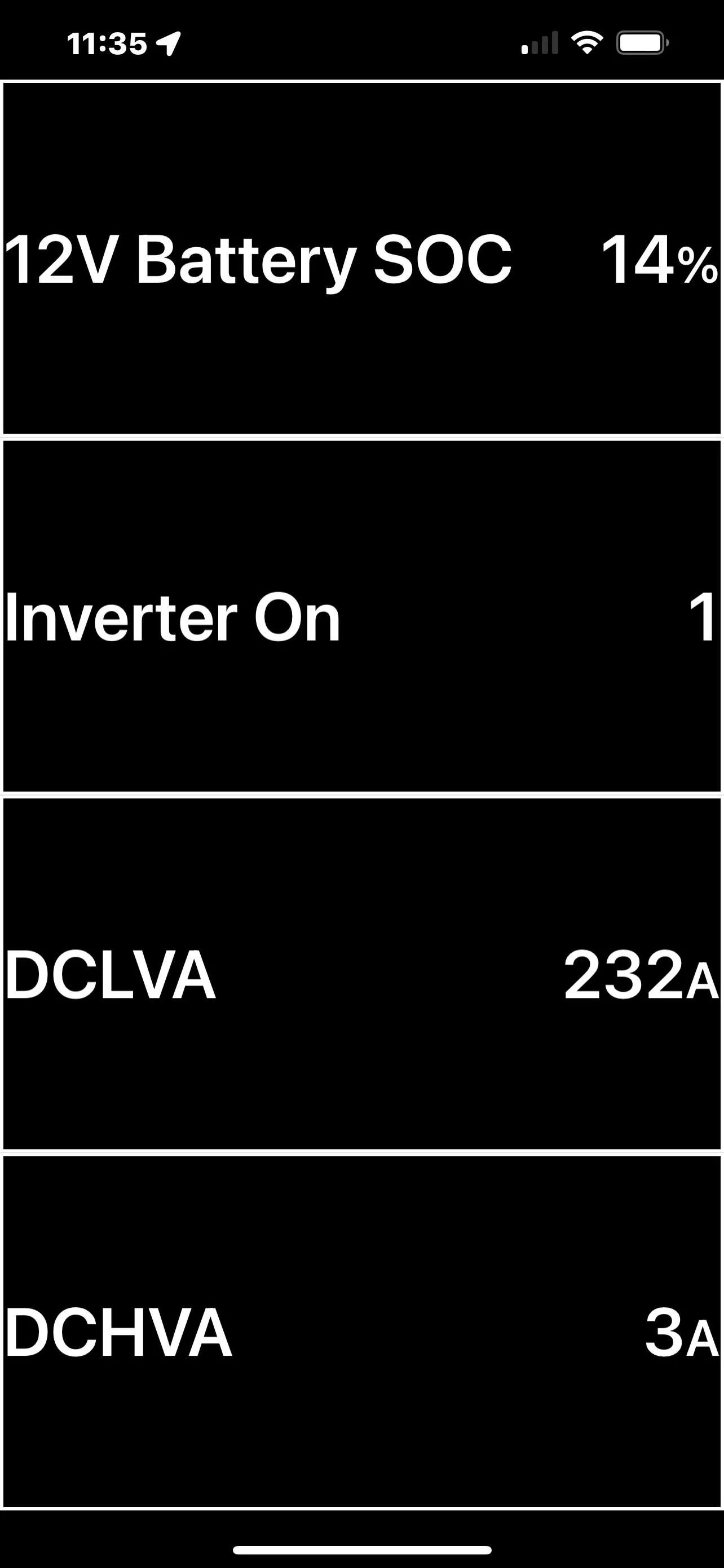

Do you have an OBD adapter? The one I linked below works well with the Lightning along with the Car Scanner app. With that you can monitor the LVB and see if things are working as expected. I also posted another thread about the 12V battery you can read here:

This is a screen I created in Car Scanner to monitor the LVB (ignore the values, it is in demo mode so it puts random numbers in). The top box is the SOC, the second shows if the inverter is on and charging the LVB, and the bottom two show the current on the 12V side and on the HVB side of the inverter.
