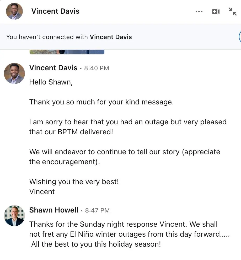

on a side note….i reached out to the executive at PG&E who is quoted in many of The articles and has been one of the driving forces behind V2G to let him know how pleased I was with my ability to power our property with this new system. I sent him the link so he may be a fly on the wall. He kindly responded. I’m hoping one day my Lightning can play the energy arbitrage game as we have a 14Kw solar array I’d like to use to our advantage.

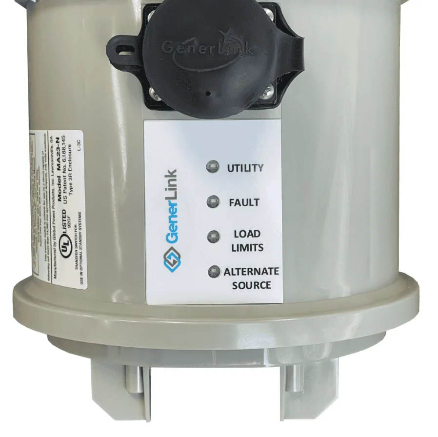

I was pleasantly surprised to say the least. My guess is the PGE model must differ from the Generlink one.
Any chance it has the same lights and or UL label on it compared to the Gererlink?
