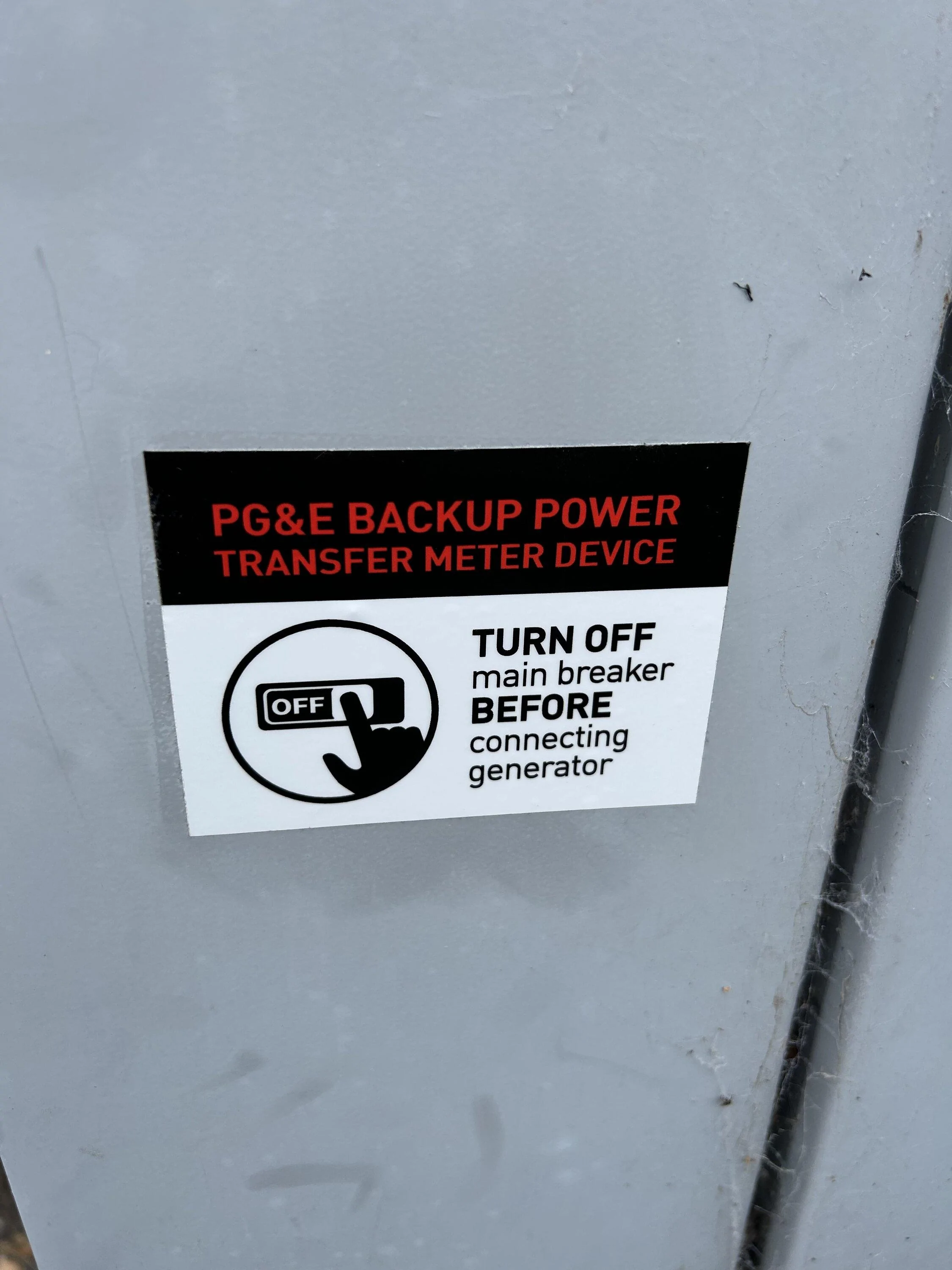

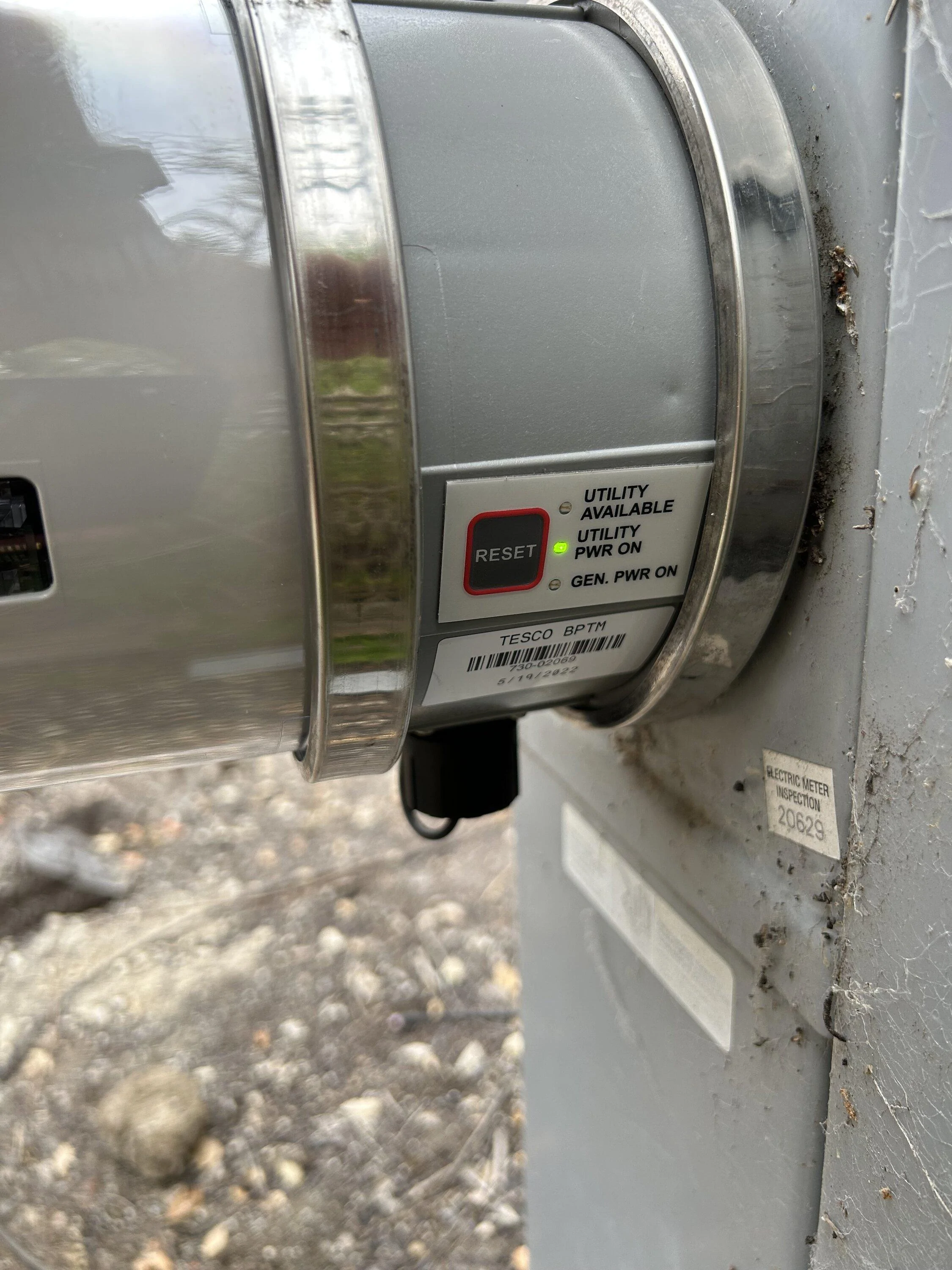

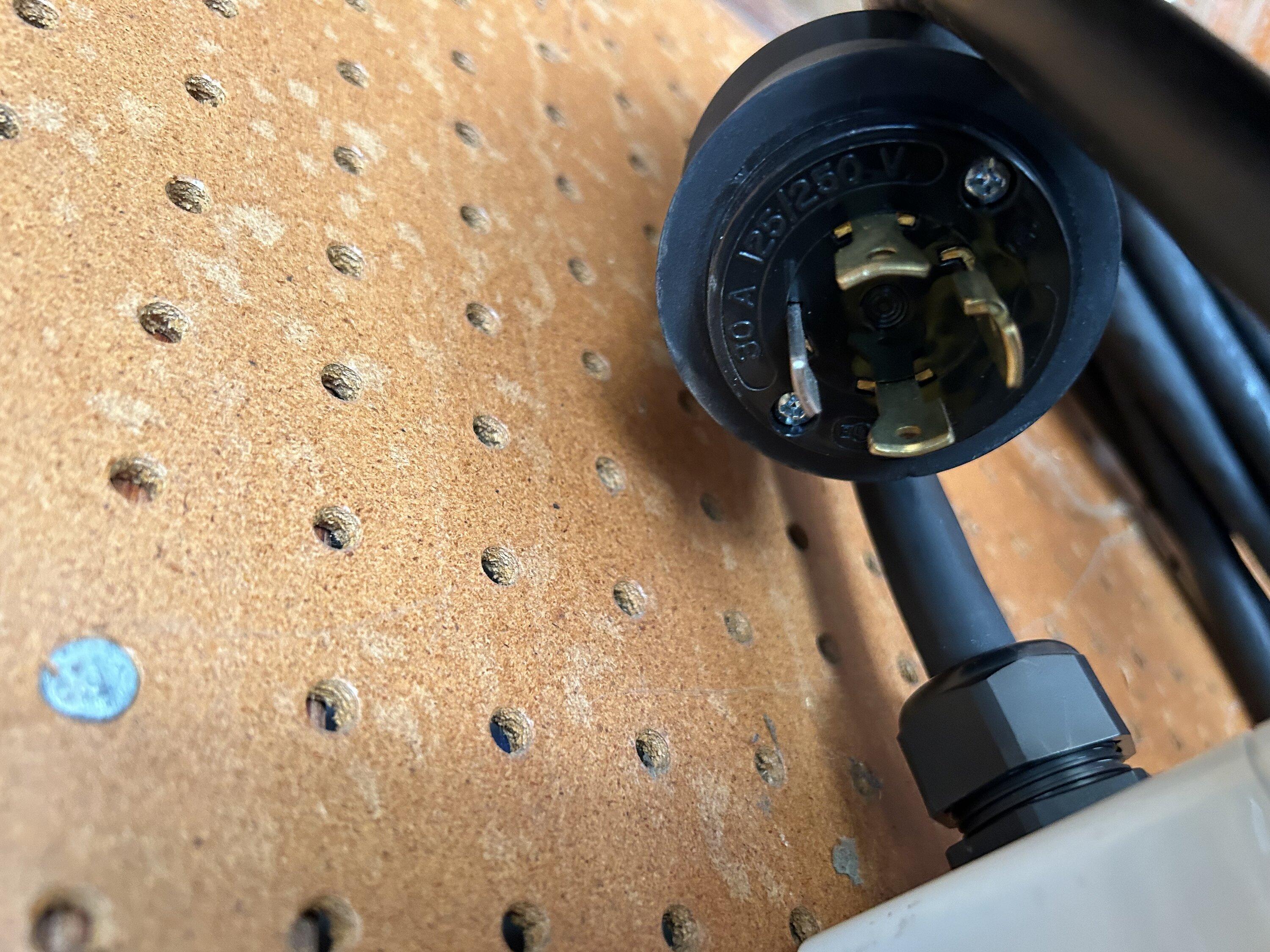

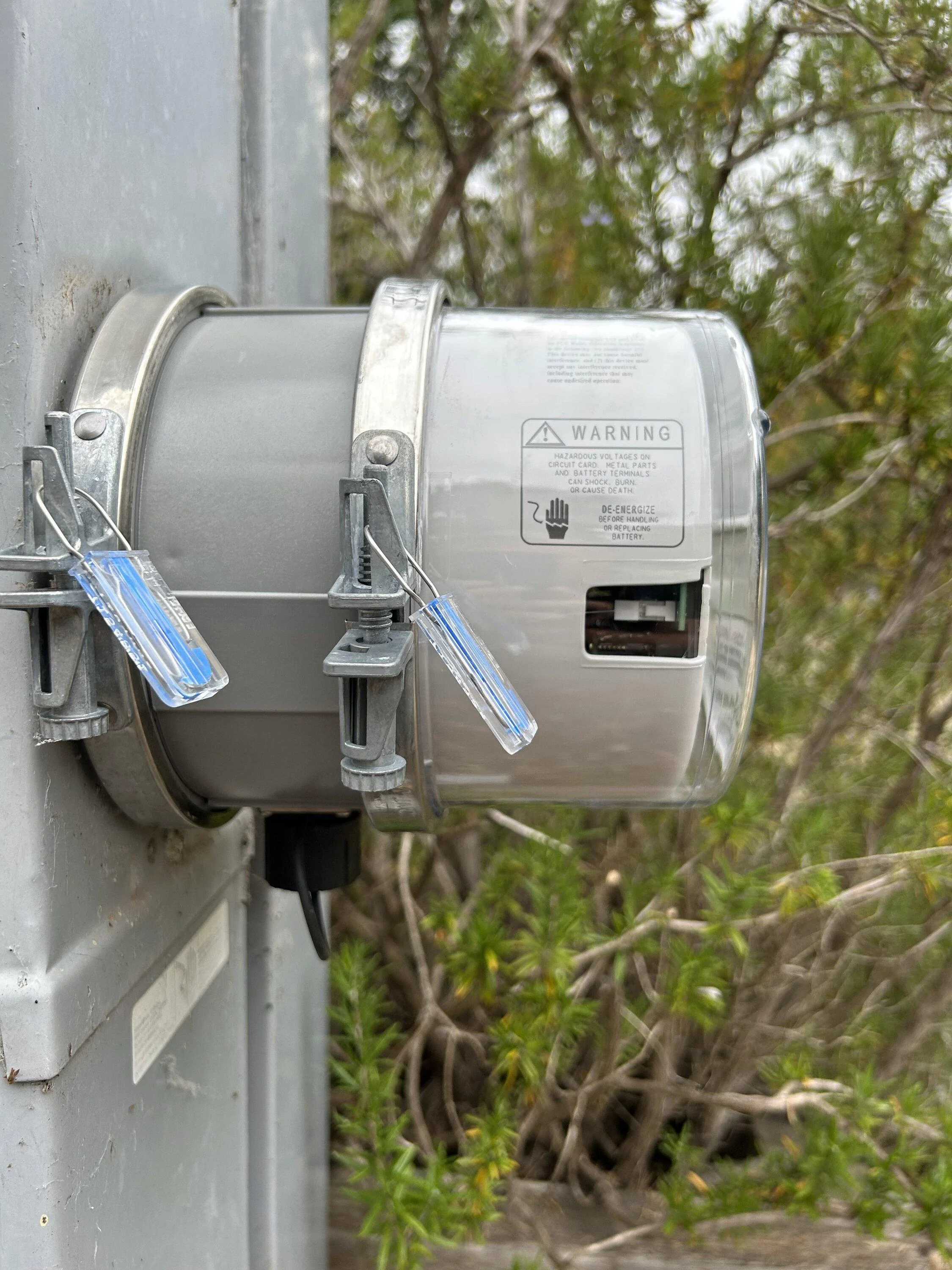

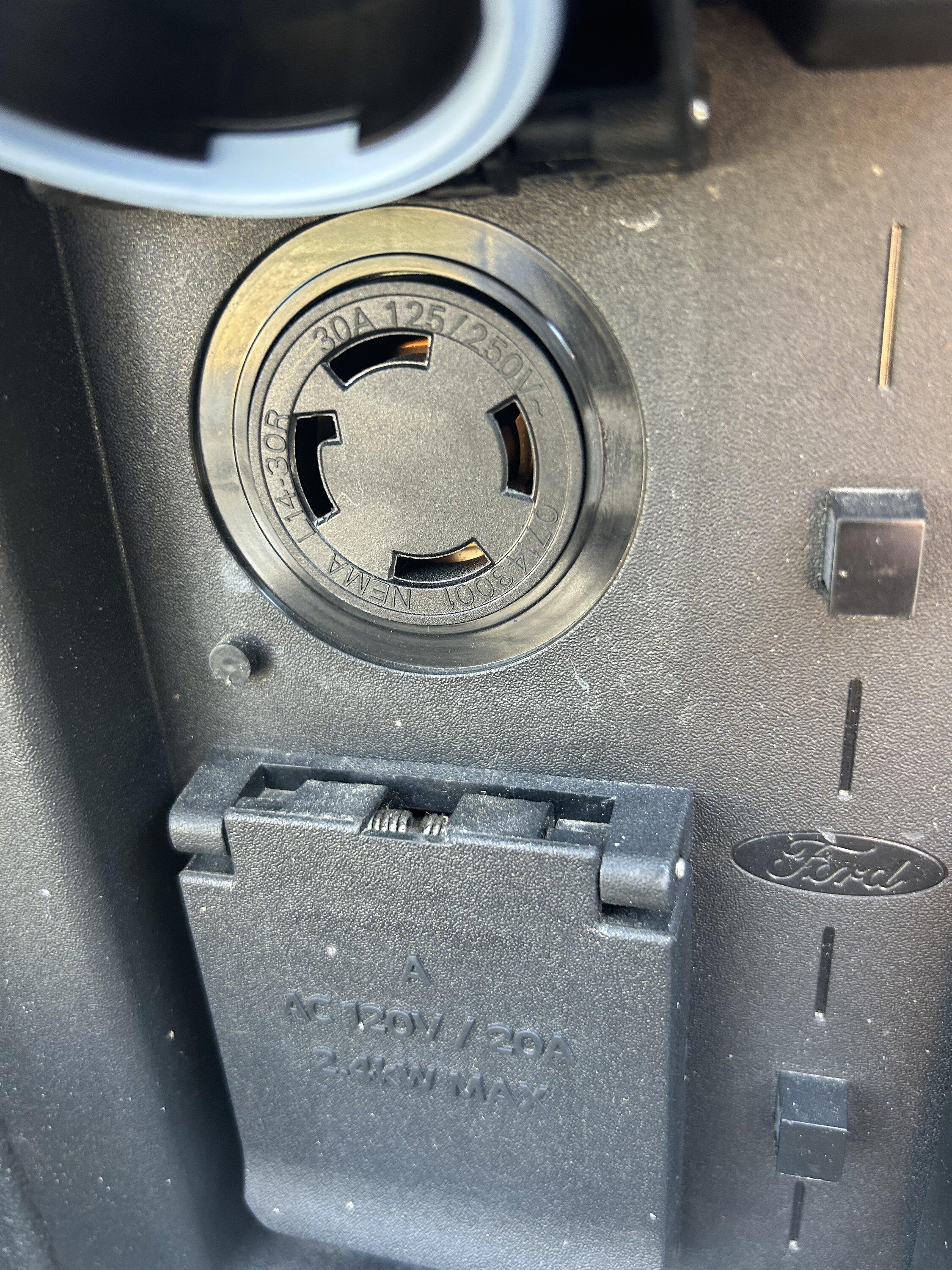

As some of you may know, PG&E has been in the headlines for flipping the breaker when certain areas are under threat of fire. Usually during high wind events in CA. We live in the country and depend on a water well. PGE has tried to mitigate the issues by offering free powerwalls (I missed that one), free 240V generators (meh, got that already) but recently they’ve offered a device like this one. https://www.generlink.com/ for free to us. I read the specs and signed up. a Few weeks ago they showed up and installed it on our meter in under 30 minutes. Their guy had me sign the paperwork, he briefly explained it, handed my a 35 foot cord and instructions and took off. Although the plug should fit our 240V bed outlet, it’s too fat and hits the dust/rain flap so it cannot be inserted properly. So I ordered an 8 foot heavy duty extension here.
https://www.amazon.com/dp/B083JJPS7D?psc=1&ref=ppx_pop_dt_b_product_details and it’s perfect for the job. So now for under $50 I have exactly what I need to power our house (I’ll have to shut off the spa, one water heater and not run the dryer) but otherwise we should be good to go for the winter. I know not everyone can get One of these from their utility but in some states you can purchase one and the utility will install it for you. For us, it’s really a great solution. We lost power for a week a few years ago and playing Games with a noisy generator and extension cords, gas cans etc for old real quick. Hope this helps others. The whole setup takes me under 2 minutes to connect in the event we lose Power. Some pics and few relevant links.

i was approved for this, but they could not install it because i have a 400A service panel and this device is only for 200A.
also, it is not an automatic transfer. The loads have to be taken down in order for the backup power to be let through by the meter. It will automatically go to the utility service once it comes back on, but there cannot be any load present before it switches to the backup. So you will still have to reset all your clocks. :)

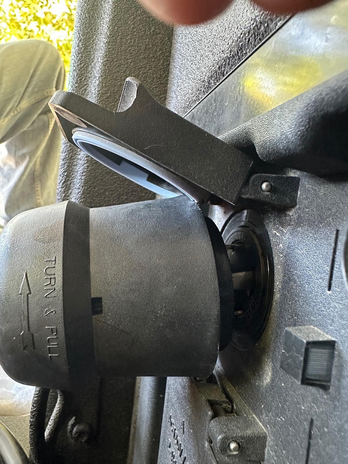

Finally got mine installed today! No advance notice, guy just showed up (same happened to the OP I think) and luckily my wife was home. Took him only 10 mins to install it, but he said he couldn't test it, you just have to wait for the power to go down (again, as stated by the OP). He left a simple instruction sheet, which I will need to get replaced because it's 2-side printed but has same content on both sides so I am missing half of the instructions -- anybody have a copy they can upload here? I found the manual online here (https://www.pge.com/assets/pge/docs...upport/backup-power-transfer-meter-manual.pdf) but it doesn't include end user instructions for turning it on.
Also, as the OP stated, the 40 foot cable they provide has a plug that doesn't seat snugly in the Lightning 240V outlet, so you need the adapter cable that he linked to in the original post. I had ordered it months ago and just tried it out, it fits like a charm. Here is a pic of the PGE cable plugged into the outlet without the adapter cable, you can see how it can't fully plug in due to the cover blocking it. I would like to thank the OP for solving this issue for me before I even knew it was an issue! Bring on the PSPS! (that's Public Safety Power Shutoff for you non-PG&E people).
Ford F-150 Lightning Easy way to safely access backup power for home and free (for some PG&E customers) IMG_3560.JPG

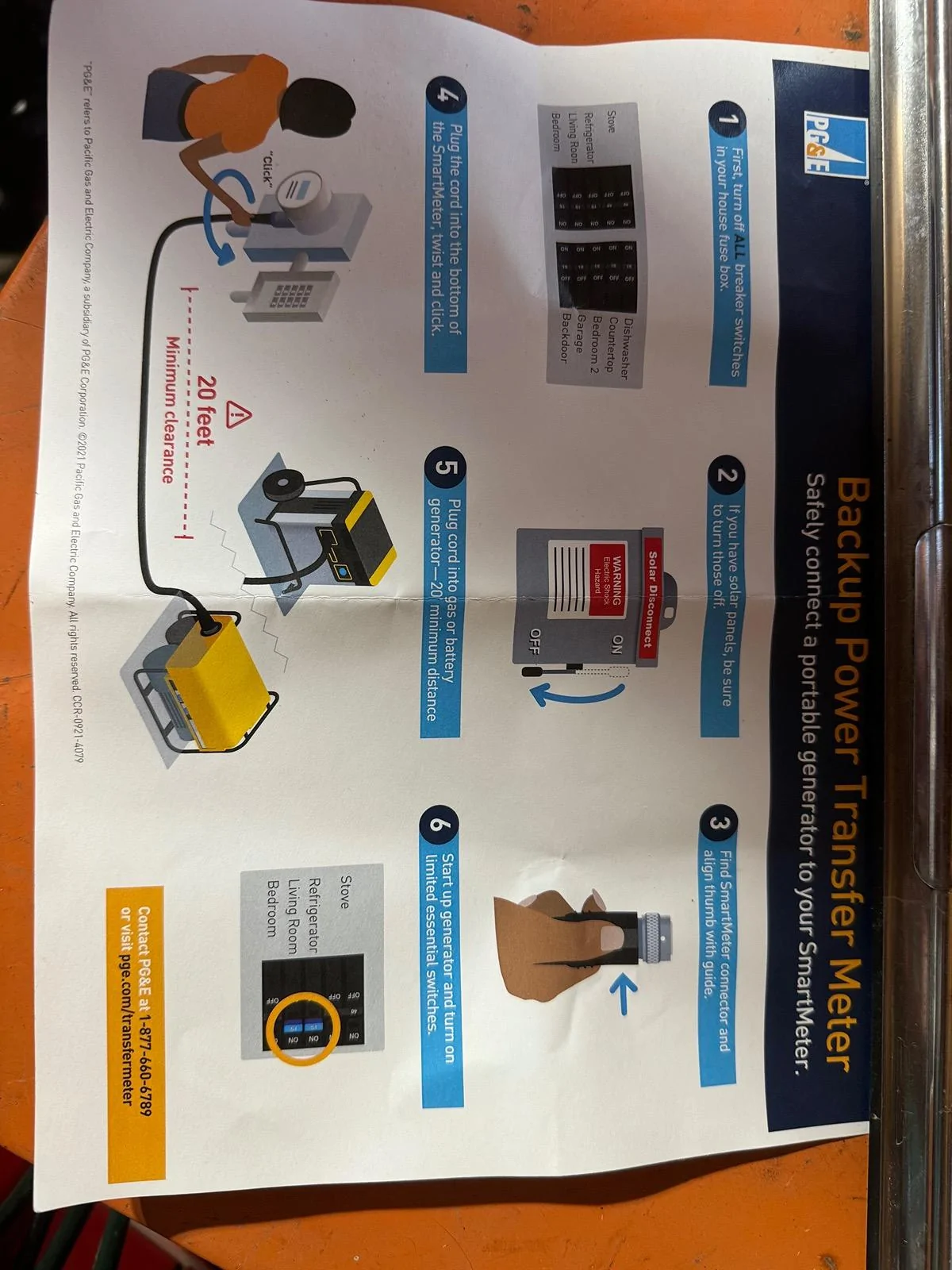

@Wsh68 , do you happen to still have a copy of the 2 page instruction sheet that you could post here? My second page was a dupe of the first page. I'm sure it's very straightforward, but I'd like to have the instructions handy in case someone besides me needs to hook it up. I emailed the installer (he left a card), but never heard back from him.
I think I do at home. We’re up at our cabin for a week but when we get back I’ll take a look.

Here’s what they gave me. Thereā€˜s not a backside to it. Hope this helps.
Ford F-150 Lightning Easy way to safely access backup power for home and free (for some PG&E customers) IMG_5385
