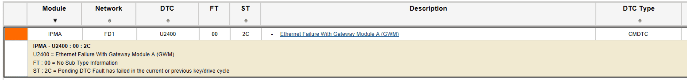

So @Bob_Mac are you saying that if you made custom changes via Forscan in a particular module that when doing an update via FDRS could cause issues?
abd79
Wayne
100
2021 F-150
He states yes but, why the DTC hours later and reverting back to default clears it?
If it helps any here is my first 2 lines on the IPMA which is different than what you had. For reference I cleared all my codes went out for a drive, did not use cruse control and the only DTC I had come back was U2400 i believe. See the snapshots.
As it turns out after doing a little digging, the FORScan change to Disable Auto-Reverse Braking and Alert is no longer needed since there is now a button to disable it in Vehicle Settings.

Just an FYI but I've seen cases where FORScan errantly reported a DTC that IDS or any other code reader wasn't seeing and the same DTC was fixed in the next update of FORScan. I'm not saying that's necessarily the issue here but the byte for that value in the '21 vs '22 IPMA asbuilt hasn't changed meaning so maybe just a hiccup or FORScan issue with the new IPMA update. Also, might be a good idea to create new vehicle profile in FORScan after all these updates.
Anyways, I've also just posted the '22 IPMA spreadsheet here for anyone interested: https://bit.ly/3KFeKit
