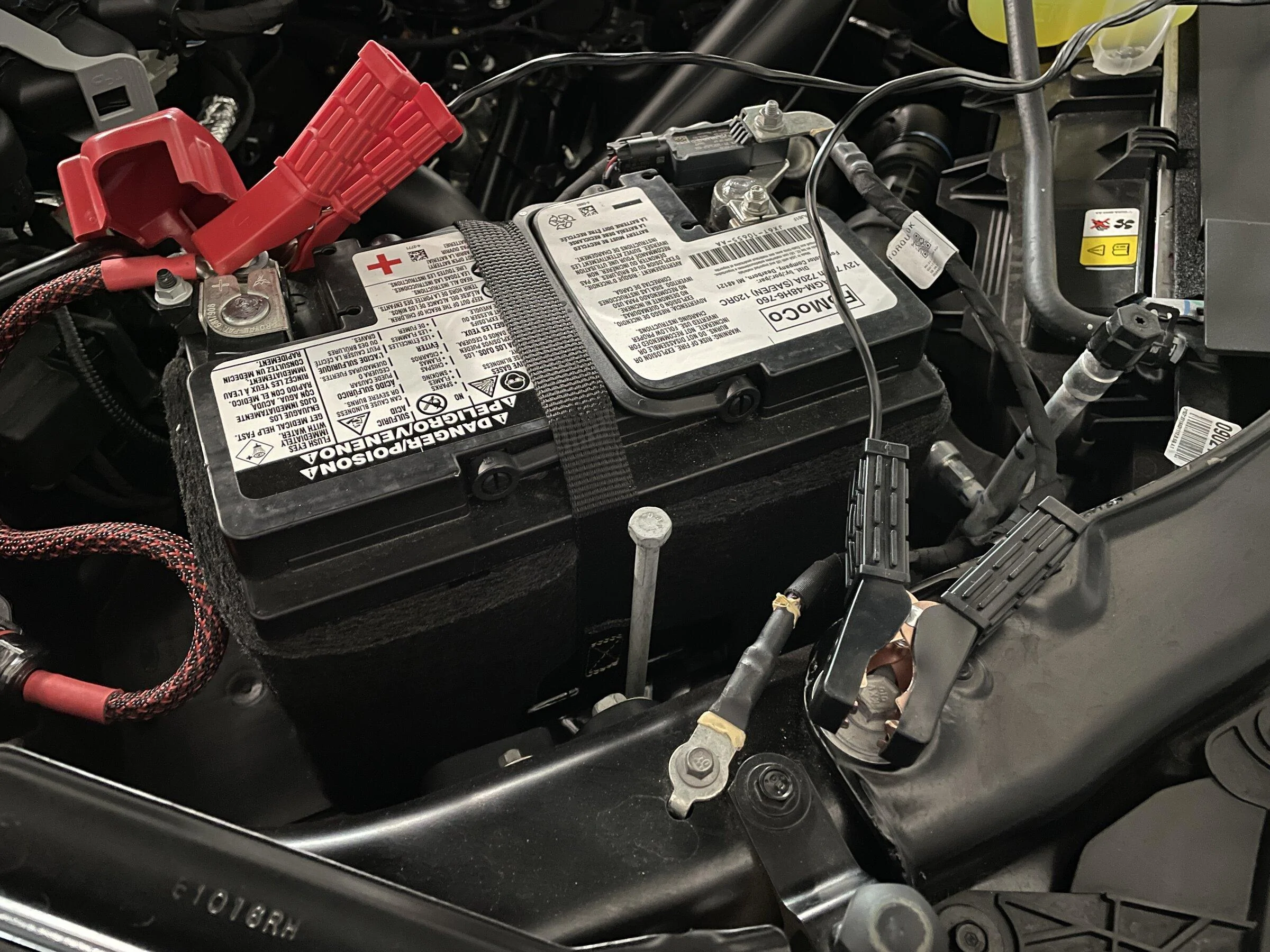

The charger wasnt the problem. The long hold down bolt was a weak ground spot for me. My battery was recently changed at the dealership and when they changed it they apparently put anti seaze on the threads which was causing me to get a weak ground. Thanks to @Bob_Mac he figured it out and Now Im back to 12.6 volts. Scary for a minute
Anti-seize is non-conductive. So, that post is useless as a ground now. Finding a good ground in these trucks is a pain in the ass. Plastic everywhere. Sounds like @Bob_Mac saved your kiester.

Best way to connect the charger I found. That long hold down bolt SUCKS. I tried it and got blistering hot - bad ground.
I’m going to”steal” your picture and add it to the guide in the beginning of this thread :)
My battery was never changed and/or removed. That bolt is just not a good ground. So don't feel bad.
