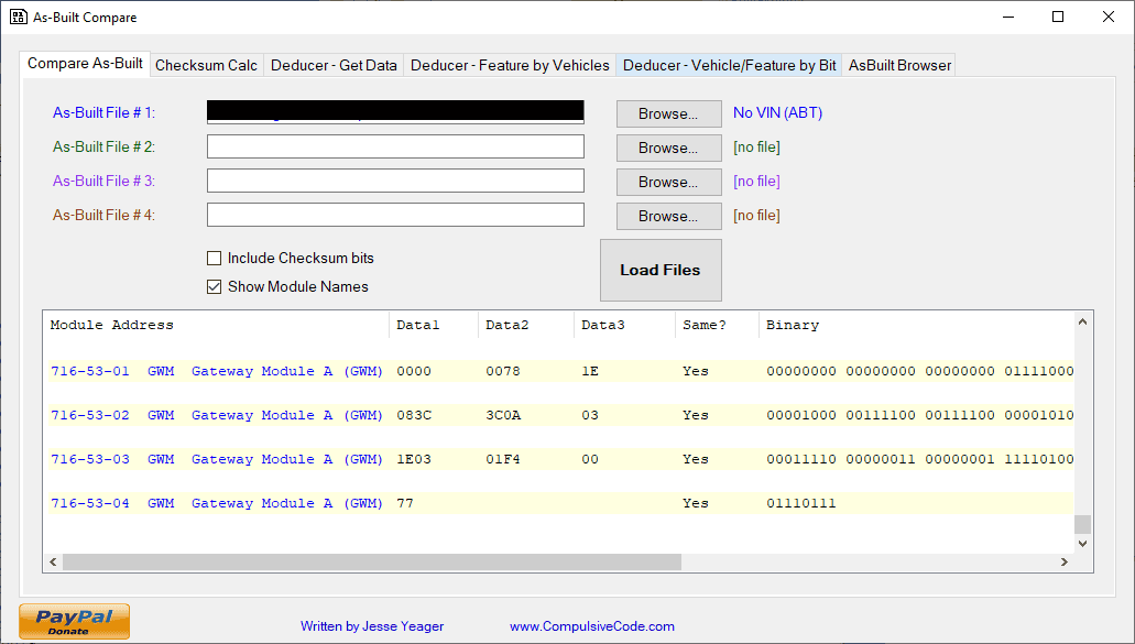

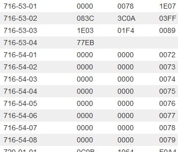

So I have been digging into what has caused this stupid 1.7.1 OTA screw up and I believe I may have figured out the issue. I believe this is an issue from the 1.6 OTA update where the GWM update gets corrupted during install and some lines of code are missing. Now there is enough there to get the truck thinking the 1.6 OTA software update is good and it starts looking for the next OTA 1.7.1 OTA but it locks up after this and puts us all into OTA purgatory. What's led me to this is that after reading everything here and looking through some TSB's, I decided to take my truck into the dealer today and they were able to get me in right away. I mentioned to the Service Manager the issues with my 1.7.1 OTA not working and its stuck. I seen in some TSB's that the GWM needs to be updated first then the APIM. Now I told my Dealer this beforehand. They attempted to update my truck to 1.7.1 and it did not take. My Dealer said they put the 1.7.1 APIM update USB in but it would error out. So I took my truck home and tonight pulled it up on FORScan. I have a DTC related to the GWM U2403 92 and this has something to do with no communication ethernet to the IPC. So I started to look at my GWM 716 Module and all lines in FORScan. I pulled up my Ford As Built info from the Ford site and between looking at FORScan and the Ford AS Built I am missing 8 lines. All of block 716-54-01 to 716-54-08 is missing in FORScan yet it shows I should have it from my Ford As Built. My original Ford As Built from when the truck was new had lines to 716-48-01. So that leads me to believe that update 1.6 OTA was supposed to add lines 716-49-01 to 716-54-08. Now this may have corrupted for a bunch of us SYNC 4 Job 1 F150's by not installing completely. What also has me thinking its the GWM is that for some of you I have read that have had their APIM changed out and is updated to 1.7.1, still can't get any OTA's even with an updated APIM. Also some of you using FDRS and doing various updates have also been stuck on the APIM update USB having to stay in for weeks sometimes before it catches. Did some of you FDRS guys do a GWM update in between and then this all worked and the 15 -17 other module updates suddenly show up and the APIM update finally worked? So to all of you out there that are still stuck in the System Updates with greyed out enabling Automatic Updates, Notifications, and Update Details that keep showing you are updated but your stuck trying to update to 1.7.1 would you check your FORScan, go to Module 716 and see if your missing the 754-54-01 to 754-54-08 blocks. Maybe there is a simple USB fix and a Call to Ford OTA we can make to ask them to uncorrupt our bad GWM's sending up the wrong info to the mothership that's preventing us from getting future OTA's. This then would maybe get our GWM working proper and get our OTA's working properly again without having to do a Mongoose Plus and Multiple FDRS 2 day licenses at a tune of $1000 out of pocket and updates this way forever at an out of pocket cost to all of us.
I think you're on to something. My Job1 truck hasn't received any updates and I have two DTC's - U023A:87-08 (Lost communication with Image Processing Module A) and U2404:92-48 (Ethernet Failure with Image Processing Module A).
Here's what I see in Forscan:

Here's my AsBuilt from Ford:

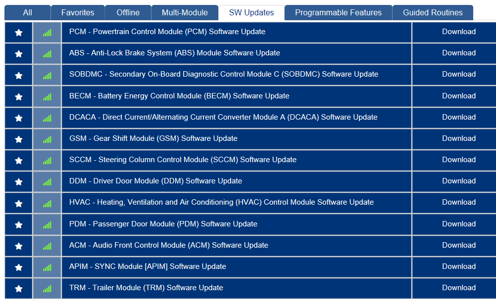

Edit: what's also strange is that there wasn't a SW Update for the GWM in FDRS:
The PMI of the gateway fixed it for platinum
the issue is the gateway reads the original config and had modified data when you look at the logs you can see the before and after and sometimes it fails towrite the after.
if you run a PMI or try a configuration it may correct the as build issue and DTCs..

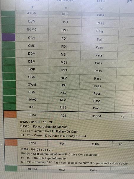

Just a quick sanity check. Are these IPMA DTC's the expected outcome on failed CCM updates with the nano?
Yes. those are both related to not talking to the CCM
