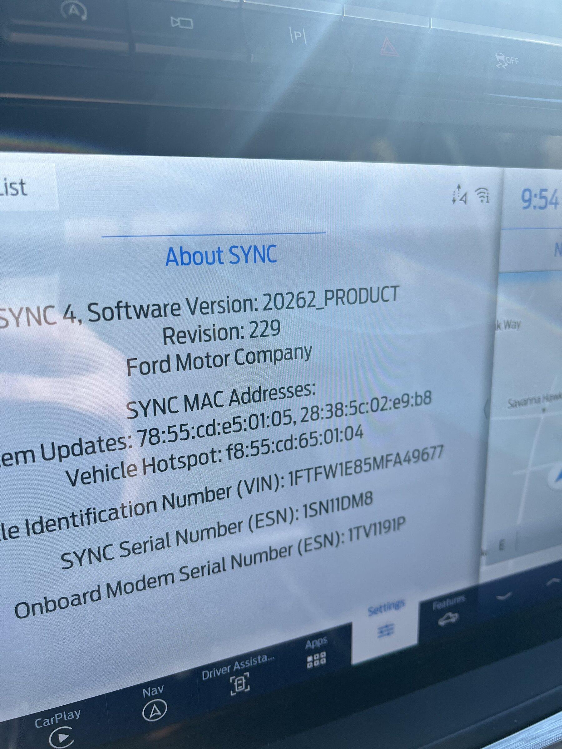

Holy shit guys, I went to pull my truck out of the garage and did my ritual of checking if automatic updates were on, AND THEY WERE. I then rushed over to the Sync version and I HAVE DATA. @Jesse-Infotainment @iceman77 can one of you geniuses tell me what version of Sync I'm on?

Awesome SpeedRacer! So happy for you! The others updates for APIM in FDRS should be easy going now!

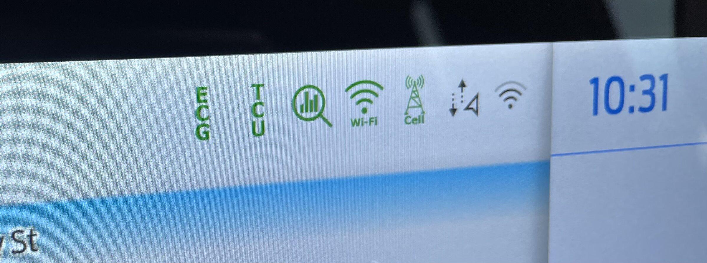

Started watching some diagnostics while driving. See if I can catch anything happening with the mods or sigs disappearing.

I’ll take a look at your vin and see what you are or what update you got. That sync version is old though.. the on in your picture
