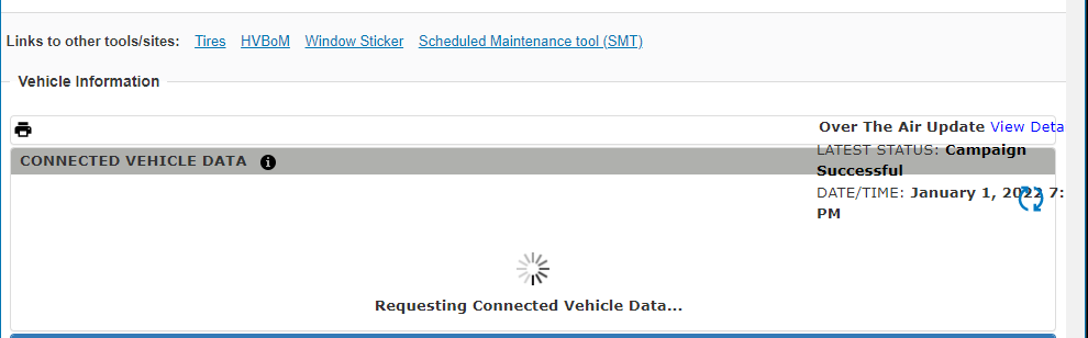

I am up-to-date with my modules updates via FDRS. I got a Motorcraft PTS subscription (OASIS) to see if I am even being sent OTA updates so hopefully I don't need to do this forever. When I get into my vehicle data I get this message below. In the past it would populate all my data here. I have tried difference browsers and waited overnight. Still same result. Anyone else who has done updates tried tried the PTS site? If someone else has a PTS subscription and willing to try on their end let me know.

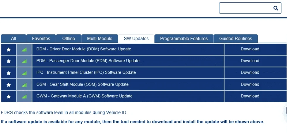

It's been over a week for me since I applied my last batch of available updates. My rev is still 244. Can someone please check this vin to let me know if there is anything new aside from the GSM?
1FTFW1E86MKD74376
Thanks!
Still just the GSM for you.
