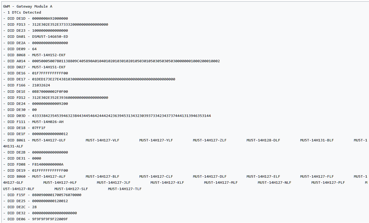

@20ecoboost21
I have a GWM that won’t clear either. I load the 14files via usb successfully and FDRS finishes and seems to be good to go but the update won’t clear in FDRS.
What are your part numbers either in FDRS or from the widget?

@20ecoboost21
It wont until the message installed complete comes up on the screen and is verified afterwards. Until that is done the update wont stick. Your otehr option is to failit and do the canbus route.

Ok I need a little help I am up to software version 364. But I still have a GWM error, I tried PMI and still nothing, Please any help would be great!!
