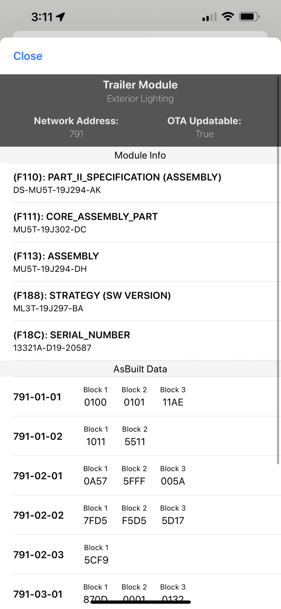

@speedracercjr
Vehicle Information
TRM - Trailer Module
- No DTCs Detected
- DID F110 - DSMU5T-19J294-AK
- DID F163 - 04
- DID F113 - MU5T-19J294-DF
- DID F15F - 08080001700968020000
- DID DE03 - 3E020A071400050002000A00025460
- DID F111 - MU5T-19J302-DC
- DID D03F - CFE065D63C5AC31ECFDD7D8AF8FBA888F5693EC0B9043861A1971699E2F37035
- DID DE02 - 870D0001010066
- DID F17C - 0808020001700727010000
- DID DE01 - 0A575FFF007FD5F5D55D5C
- DID DA01 - ML3T-19J294-BA
- DID F166 - 21083126
- DID DE00 - 0100010111101155
- DID F188 - ML3T-19J297-BA
- DID F18C - 30120A-D17-10740
So I updated my TRM March 21st and I have this same s/w version.
maybe this is the latest that address the recall? Or there’s something more to it?

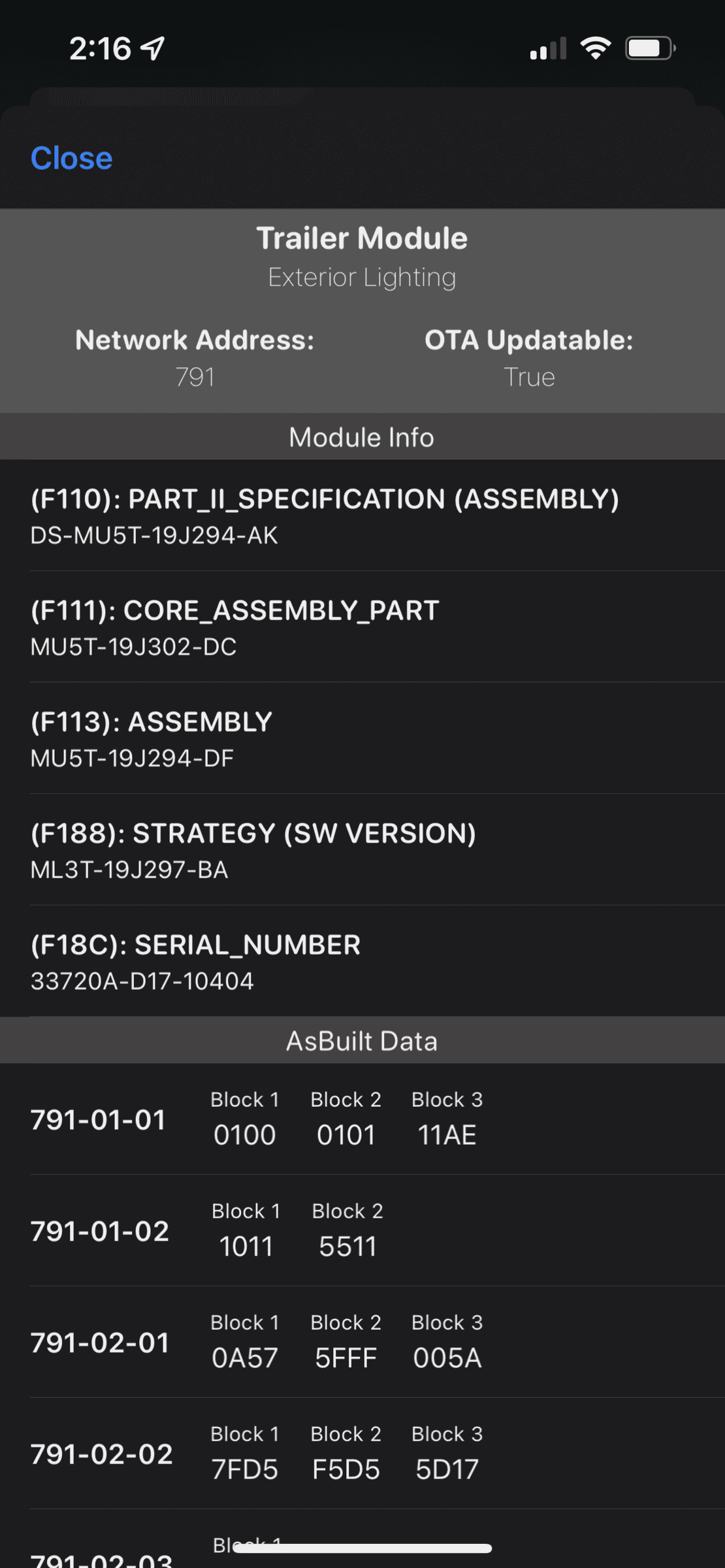

I need to get this widget... Pulling my as built from motocraft, not sure how often it updates though? Looks identical, maybe I need to wait till tomorrow.
791-02-02 7FD5 F5D5 5D17
791-02-03 5CF9
791-03-01 870D 0001 0132
791-03-02 0066 03
791-04-01 3E02 0A07 1402
791-04-02 0005 0002 00A5
791-04-03 0A00 0254 605F

Sorry I didn't grab all the 791 (assuming that the TRM?) Looks like I might have a few extra rows?
791-04-XX ?
Edit - I edited my orginal post with the as built.
