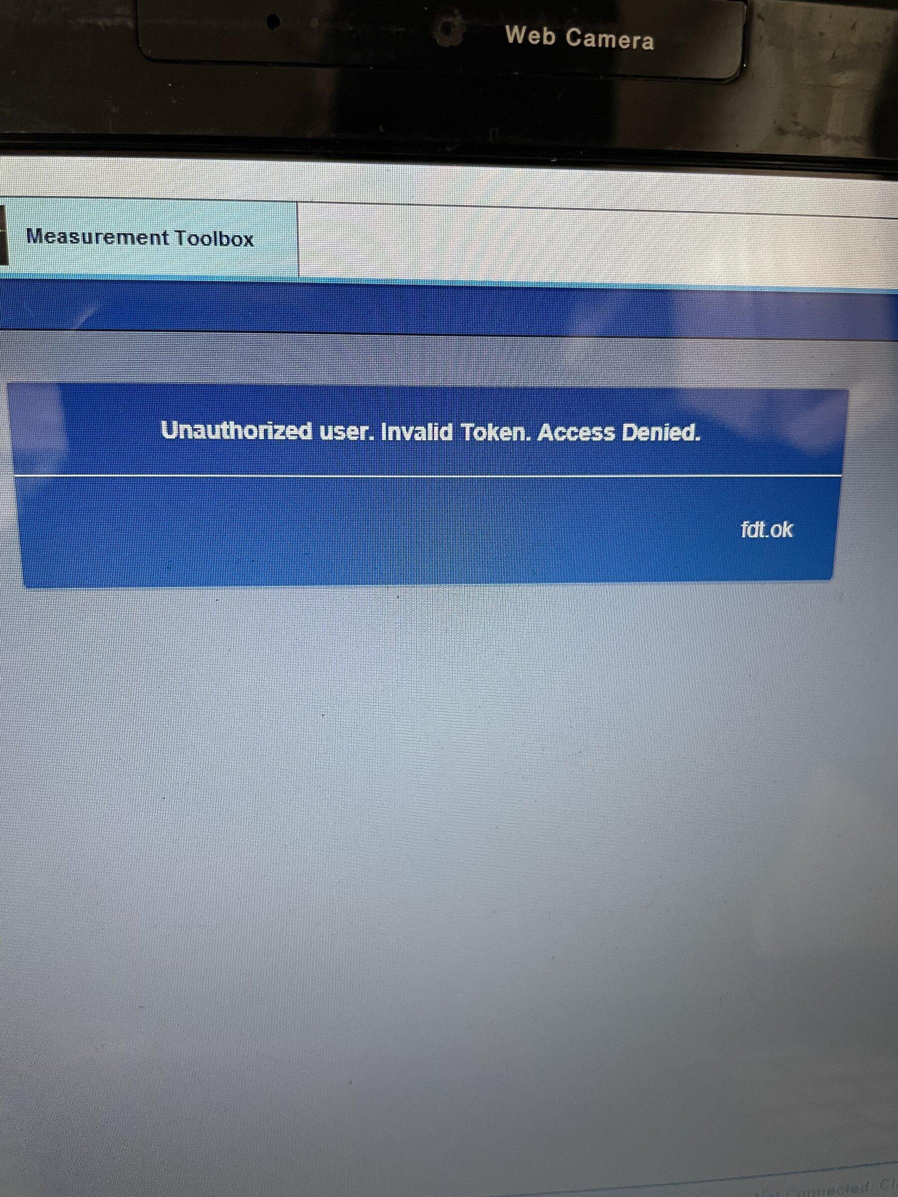

anyone else get this message while trying to pull up their vehicle history on FRDS? My truck is at the dealer, trying to check in and see what progress (or lack of) has been made.

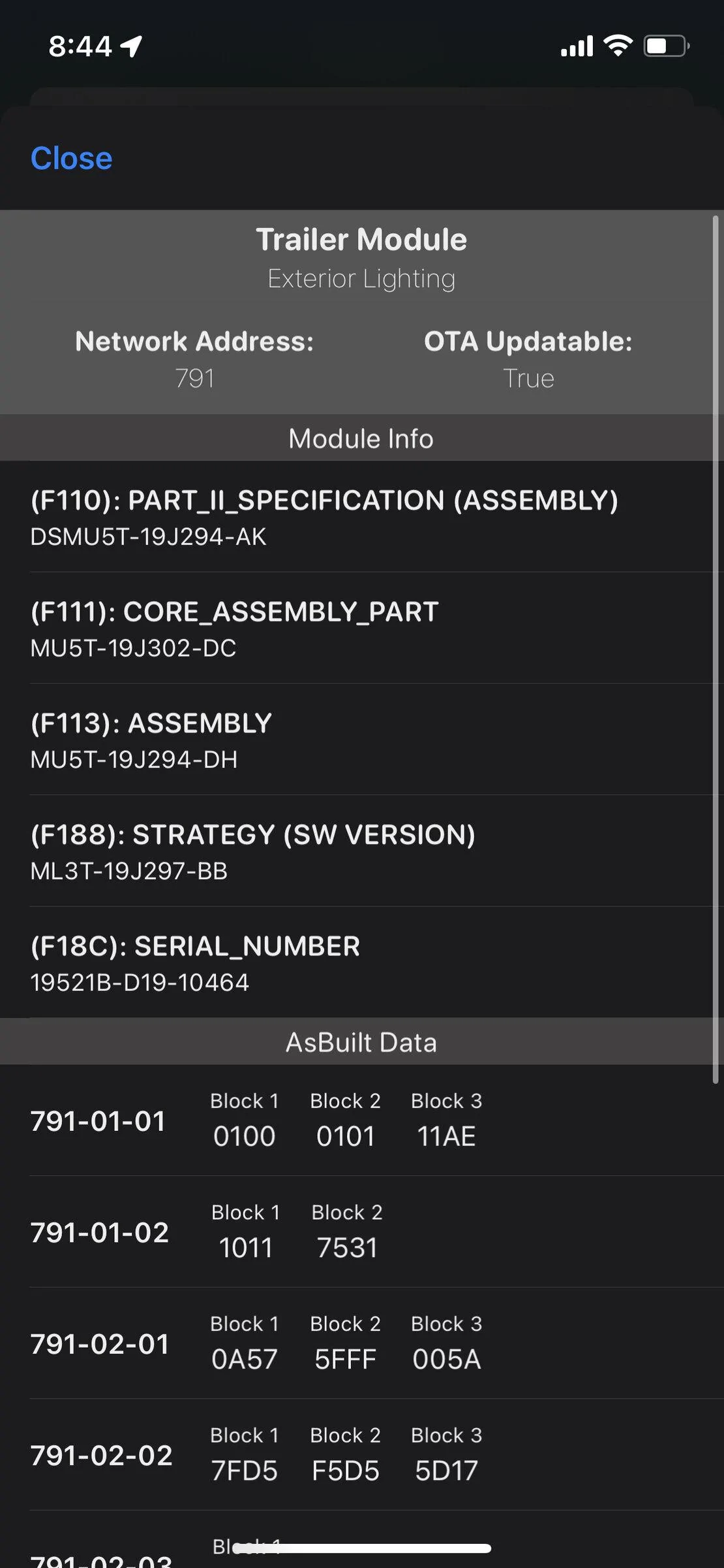

I installed the latest version available in FDRS today and the last two were BB, see below:
Ford F-150 Lightning ECU module programming guide using FDRS 37ED6419-C367-4C34-8E67-214A1B1D1402
Nope, just checked mine, all ok.
But it has choked in the past at times.....

same here updated TRM
Ford F-150 Lightning ECU module programming guide using FDRS IMG_247C21D86CE3-1
