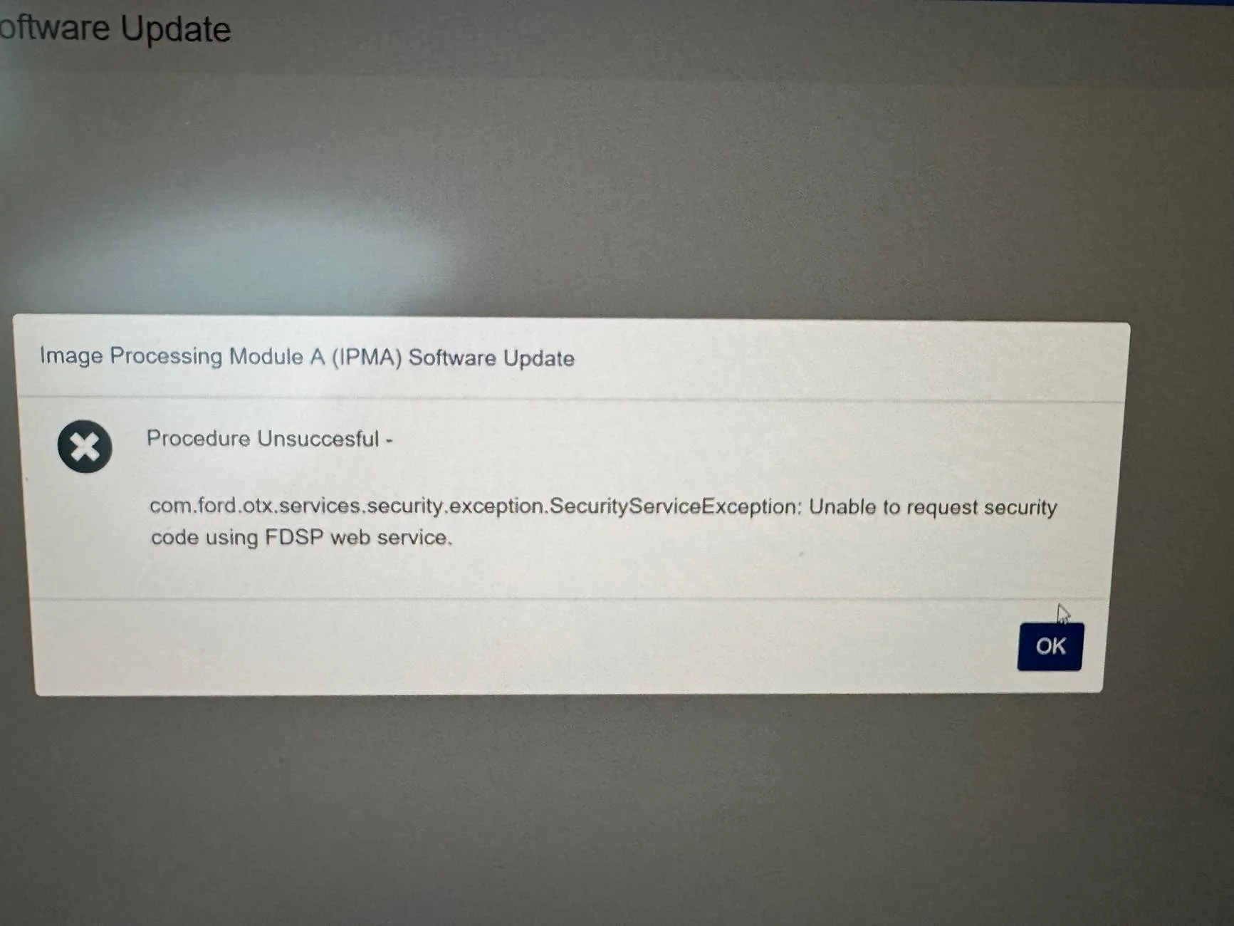

Well, now the IPMA failed took 2.5 hours!-?
Fluctuated between 13.1 and 13.2 V for the whole 2 1/2 hours so not the power supply!
Gave me the same weird error as yesterday??? maybe something to do with FDRS 42.5.10?

Did the IPMA update come off the list in SW updates tab? If so, turn off the truck and let it sit for 20 minutes. Restart the laptop, run FDRS and click the IPMA module to bring up the list of guided routines you can do on it. Run the IPMA config procedure.
I think it was still there. It went on to try to do the next update(when I started it said it was multi module or something to that effect), but I canceled it. It was about to start raining and cold so I figured I was done for the day.

If it's still there, then it needs to be done again. Truck is fine? No faults on the dash?

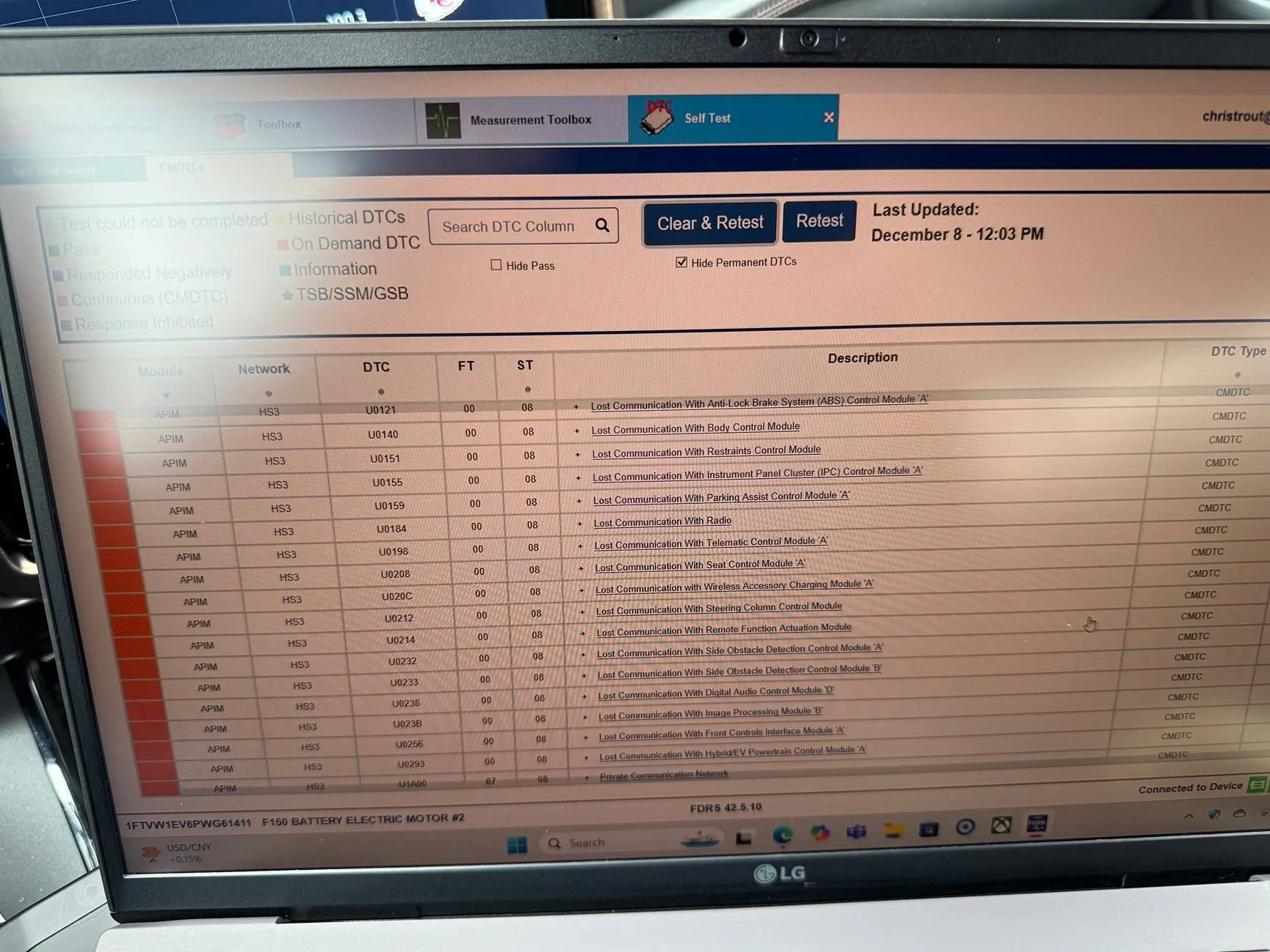

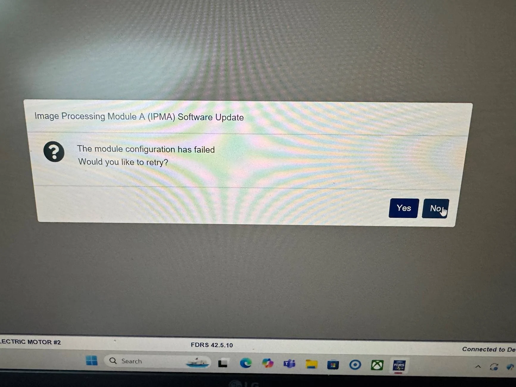

So… what is the opposite of no faults???
Ford F-150 Lightning ECU module programming guide using FDRS IMG_1249
Drove the truck to work and everything was fine and when I got home to redo the IPMA and hooked up to FDRS this is what I found

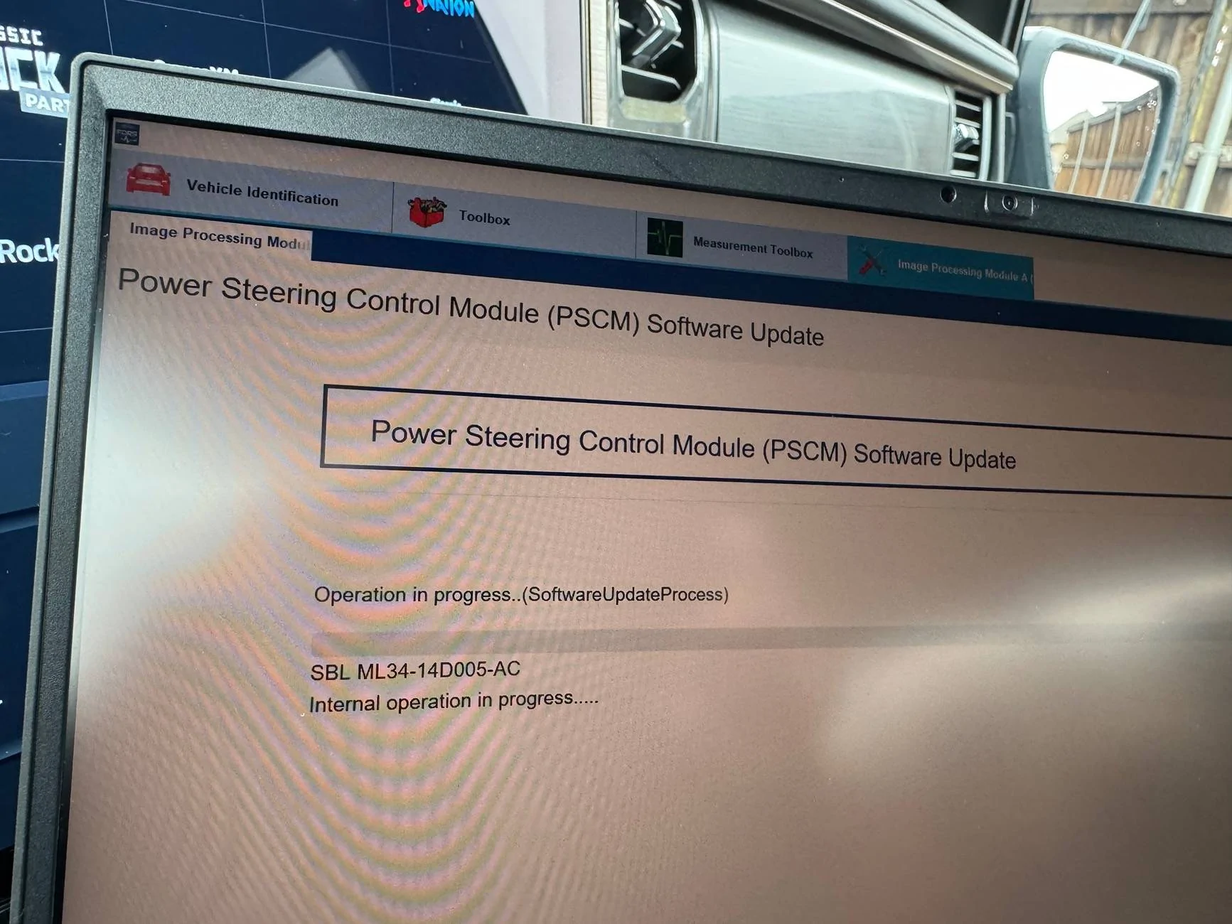

Apparently, only the module configuration failed? Cleared all the faults and luckily did not have to sit through 2 1/2 more hours. It took about 2 1/2 minutes to redo the module configuration and automatically started the power steering control module.
Ford F-150 Lightning ECU module programming guide using FDRS IMG_1251
That one finished and it popped up a gateway module which required the USB that is in process now!
Ford F-150 Lightning ECU module programming guide using FDRS IMG_1252
still at least a couple more to go, but at least we are moving forward. Just thought I would update in case others run into this.

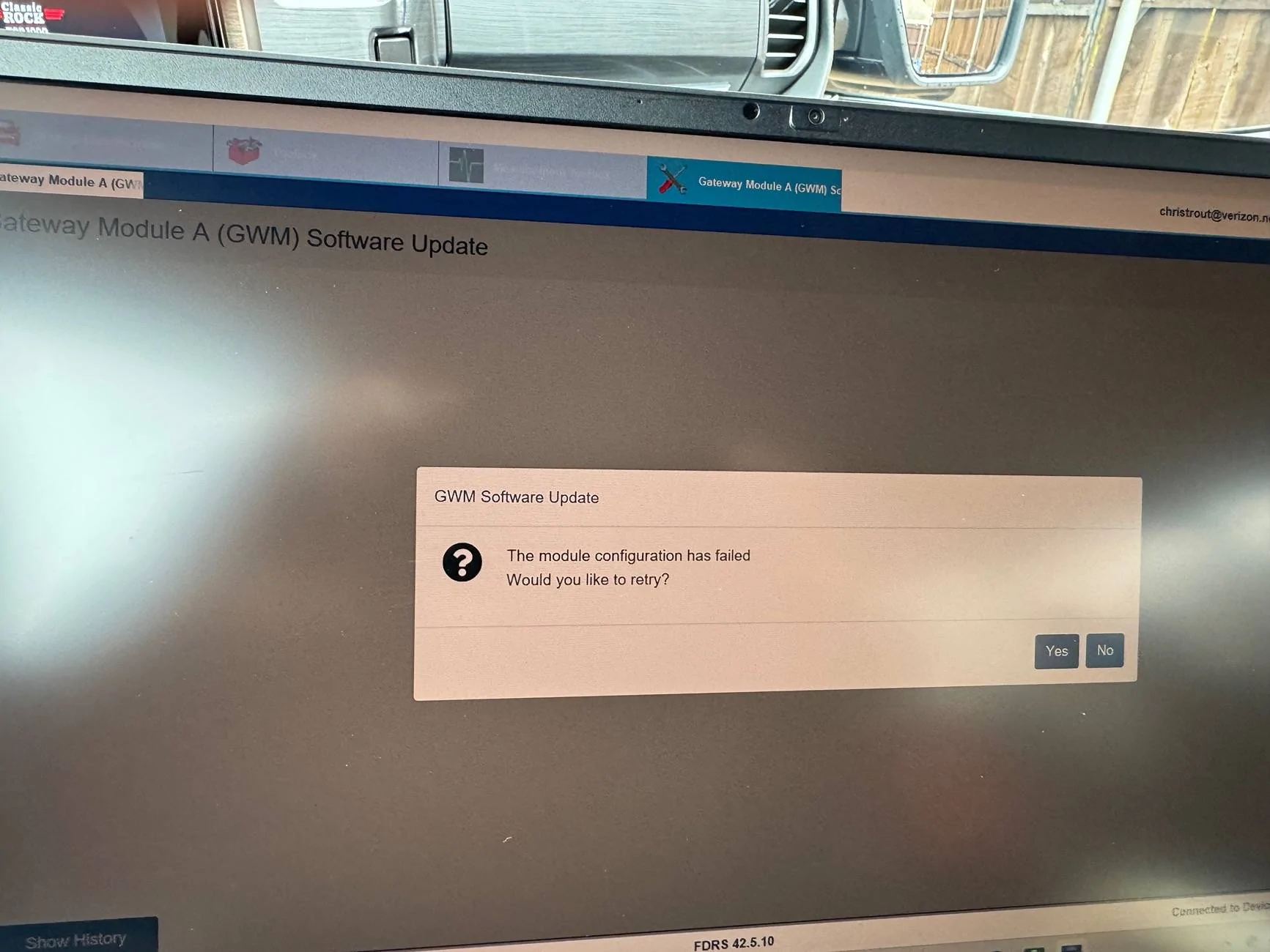

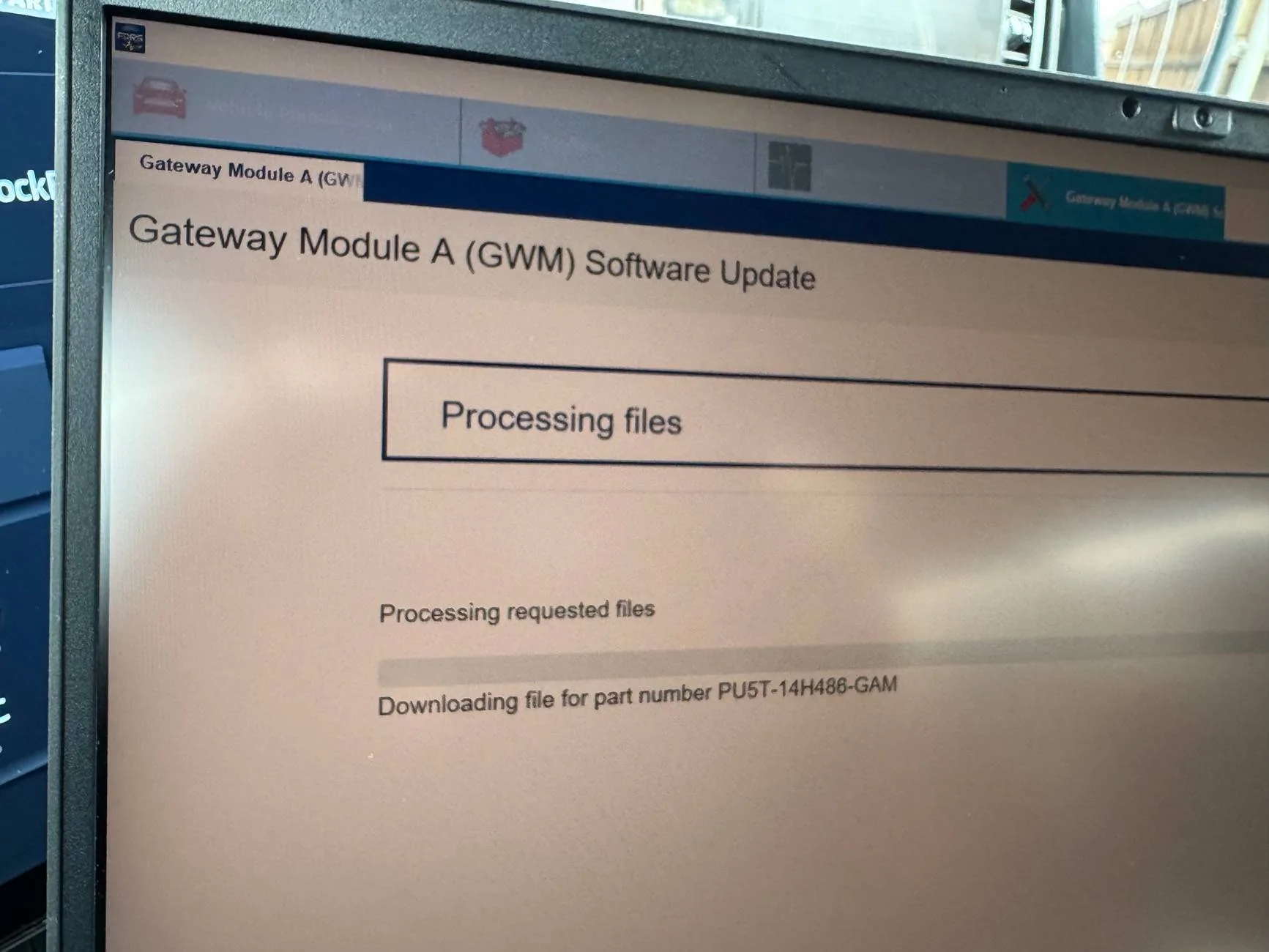

Well the gateway module configuration failed as well:
Ford F-150 Lightning ECU module programming guide using FDRS IMG_1253
I don’t remember, but I think I just hit yes and it went through the second time (if not, then I hit no and went and re-scanned the network and then it went through fine)it is only when it gets to the module configuration that it is failing kind of weird so that is why I question if it has to do with this version of FDRS?

Final update on the latest round of updates….
Basically every module gave me the same error code, and I had to go back in and try it again and then it would go through! GWM two or three tries, but finally went through after cycling the truck on and off a couple times…
So I am now up-to-date with karaoke to boot
