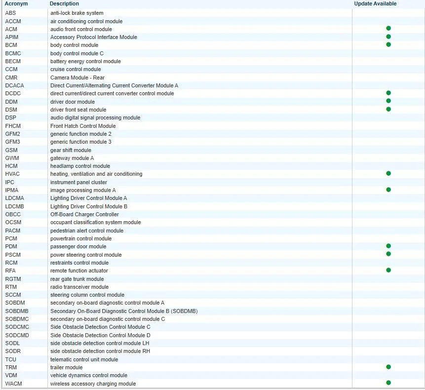

BCM will not prevent the APIM from releasing. Just messaged you.....you do have an APIM pending.
Yep, I'm shocked by that. It wasn't available when I updated over Thanksgiving weekend. Pretty rude that I have to buy another 2-day license to get it.
It is, however, good news that it's back in the list for 22s. Thanks for checking.

So 13 pending updates! Wow...absolutely unreal. I really appreciate you doing this!

Be careful with that IPMA update. It can be problematic on 22s, though it should be fine with the 12V fully charged and the appropriate power supply. And make sure to run the 360 camera config for him afterward, and if you have Forscan, do the BC1.3 feature enablement. But even without the new features, that one is a real game changer for BlueCruise lane centering.
I haven't asked Ruged in a while, but I'd wager I'm behind by about double that. I have the mongoose, will be ordering a USB and power supply soon. With a little luck I'll have myself up to date by the end of the month.
It's definitely ping-ponging. I had the APIM update appear in my list sometime in September. It was still there on Nov 26 but gone on Nov 27th. Had it checked today and it was back. Then tonight I got the 10.1.0 update which I believe might be the APIM. I'll ask someone to check tomorrow but I wouldn't be surprised if it's gone again. My Sync version is now 24127 which I believe is the latest. I have the Public Charging and Stingray karaoke app.
Hold off on the license, you may be getting it OTA.
EDIT; catching up and saw you got 10.1.0. See if it clears the APIM.
