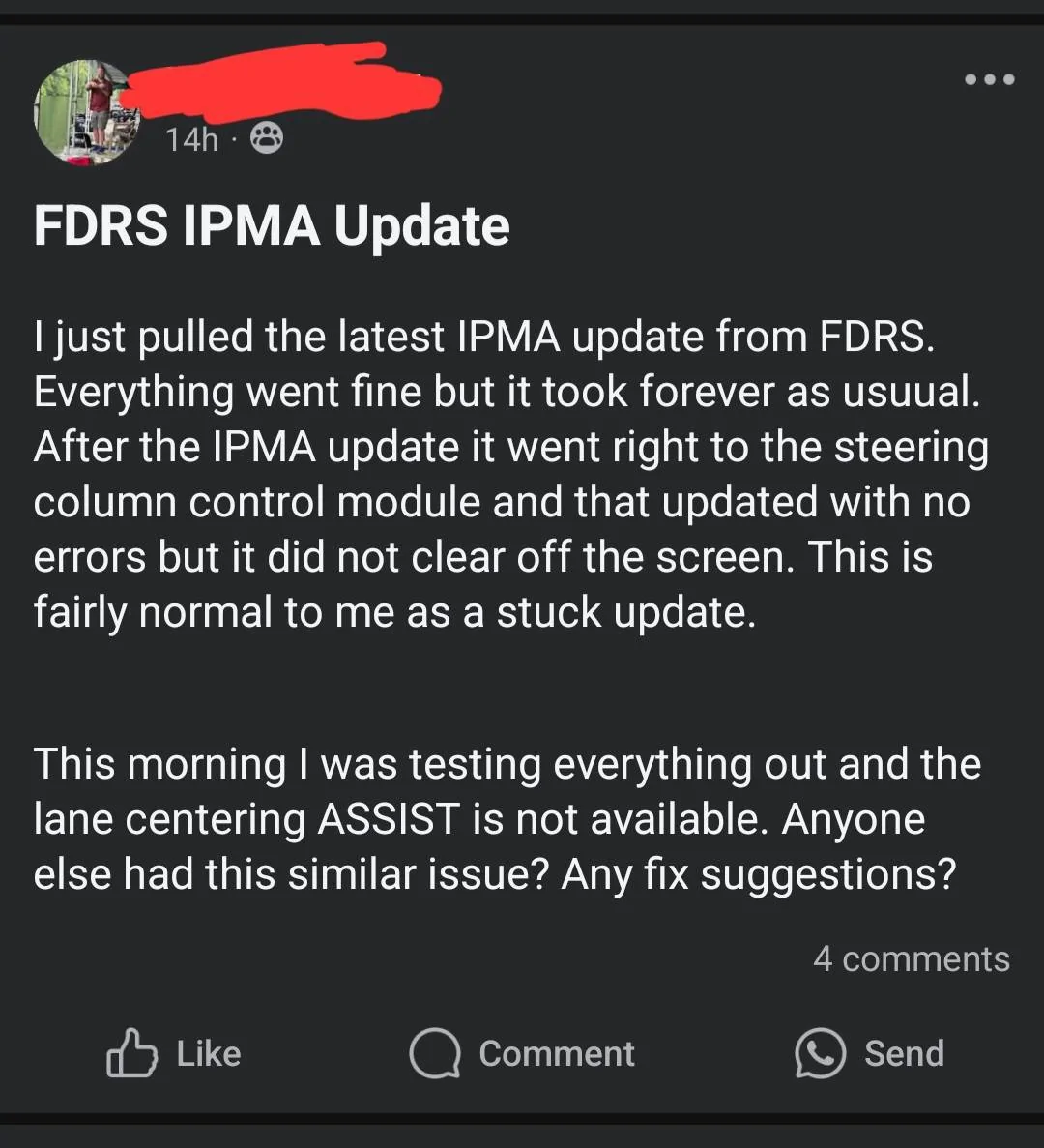

PSA: I recommend to not update the IPMA until further notice. While only a very small percentage of trucks are being affected, the ones that do get affected will lose lane centering and bluecruise indefinitely. At first, we thought the issue was only affecting the hybrid F150's, but that we know of, at least one Lightning and now three ICE F150's are also affected. Today alone, two new cases popped up on the F150 forum. There is no fix.....the dealer can't help. I have no idea if the OTA version causes an issue or not as no cases have been reported on the forums by the few that have gotten 1.4 via OTA as of yet.
Edit: And another one......

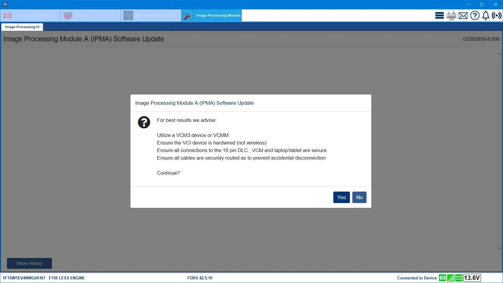

Ford F-150 Lightning ECU module programming guide using FDRS IPMA_Update_notes
This is what you'll see right after you click "Run".
I saw that, but as far as software updates go you'd think it's a matter of it either works or it doesn't and not that "best results" could mean we'll brick certain functionality if you don't use a VCM3.
I know that the VCM 3 is a lot faster than a VCM 2 or a comparable J2534 device like the Mongoose + Ford, or Bosch Master Tech. I believe what they are trying to tell the techs is that if you have a VCM 3 in the shop, put down the VCM 2, and go get the VCM 3 out of the cabinet because this will be faster using that. I don't think the issue is whether or not the success rate of the update will be impacted....it's just a lot faster.
