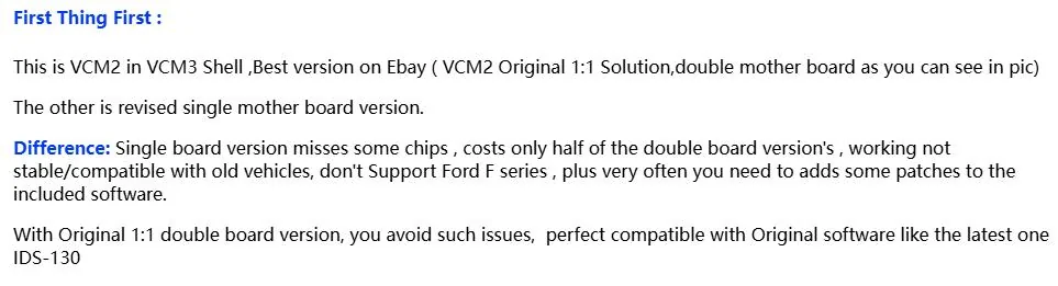

I use one of these. Performance matches the mongoose. Recommend updating firmware with VCI Manager before using.
And I would strongly advise you or anyone from using that tool. If you used this and nothing bad happened, consider yourself lucky.
It's a cloned VCM2, that's why VCI Manager can load the latest Bosch firmware onto it. I've used it with absolutely no issues, including updating the IPMA and PSCM modules. Also use it with FORScan.
As the ad indicates, you shouldn't use the cheaper single board clones for updating modules, they only work well for diagnostics.
I see what you're saying....I read it wrong. I still wouldn't go this route personally, but I do see what you're saying.
