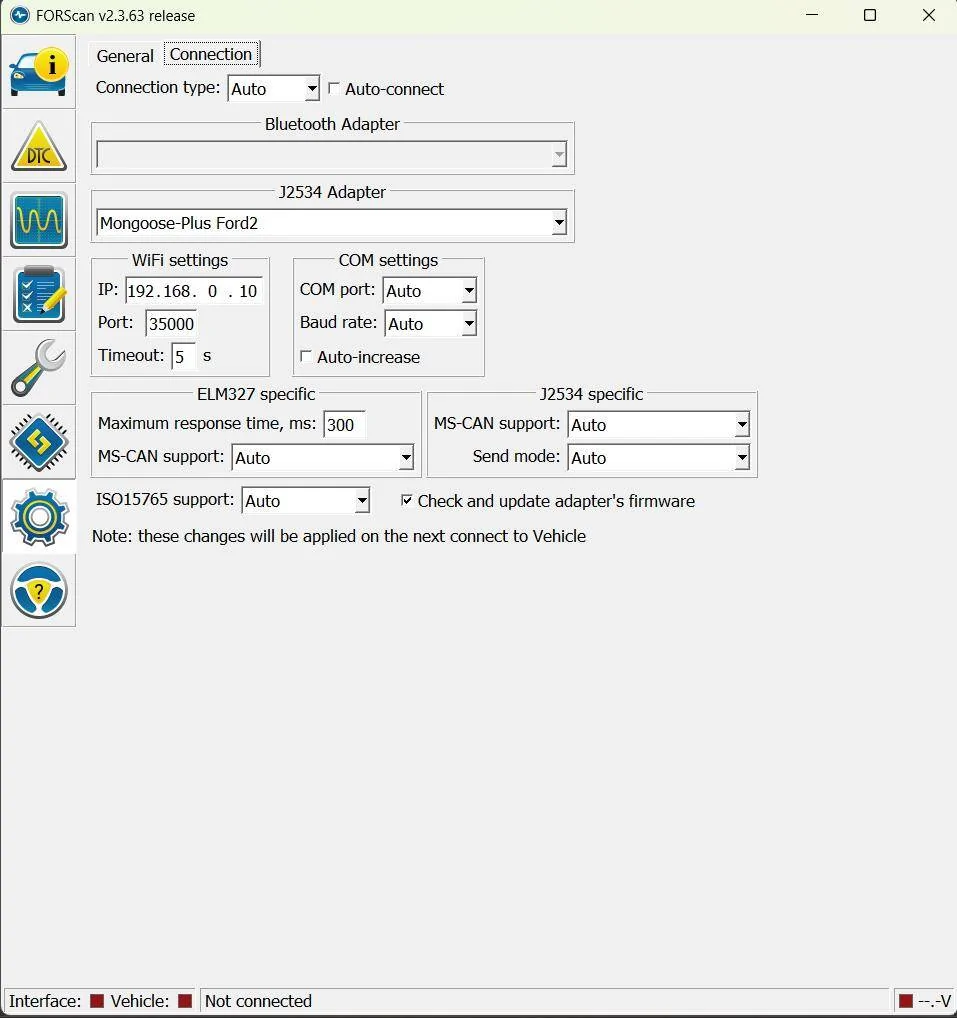

What am I doing wrong to connect my mongoose to fdrs and forscan . Says unable to connect ...Installed drivers and I'm able to get fdrs to says connected shows battery volt but when I try to scan Vin says device not connected but when I enter vin manually i click connect bottom symbol says connected ?

Yes I did . After installed that one I got vcm device options...I also can see my driver's are installed shows vehicle pass through and shows mongoose....but just strange I cannot even get forscan to connect

Sure you ordered the Ford version of the Mongoose? Where are you located? Maybe someone near you has a working one you can try. The only thing I recall installing was the Opus IVS Driver and for FORScan I just selected the mongoose on the screen below
