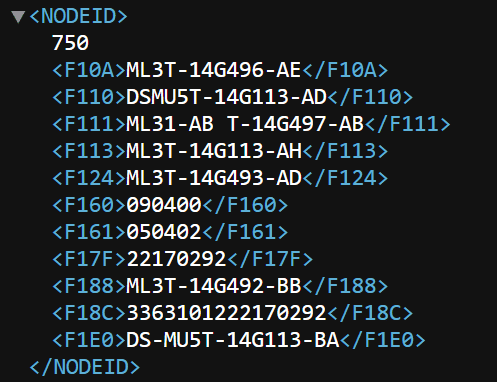

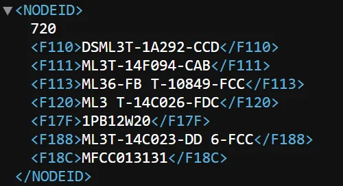

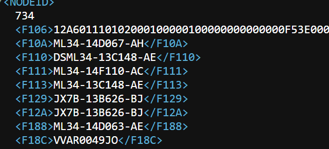

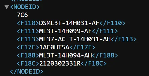

Looks like I have several modules impacted. It is also interesting that a couple of them were not updated but are now corrupt.
Does anyone know if this long field (F106) is corruption too? (Bottom Screenshot).
I have these issues also. Comparing my original data, This is something new and wasnt in my original data.
