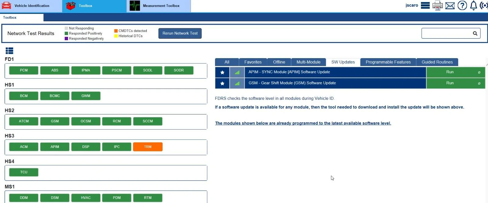

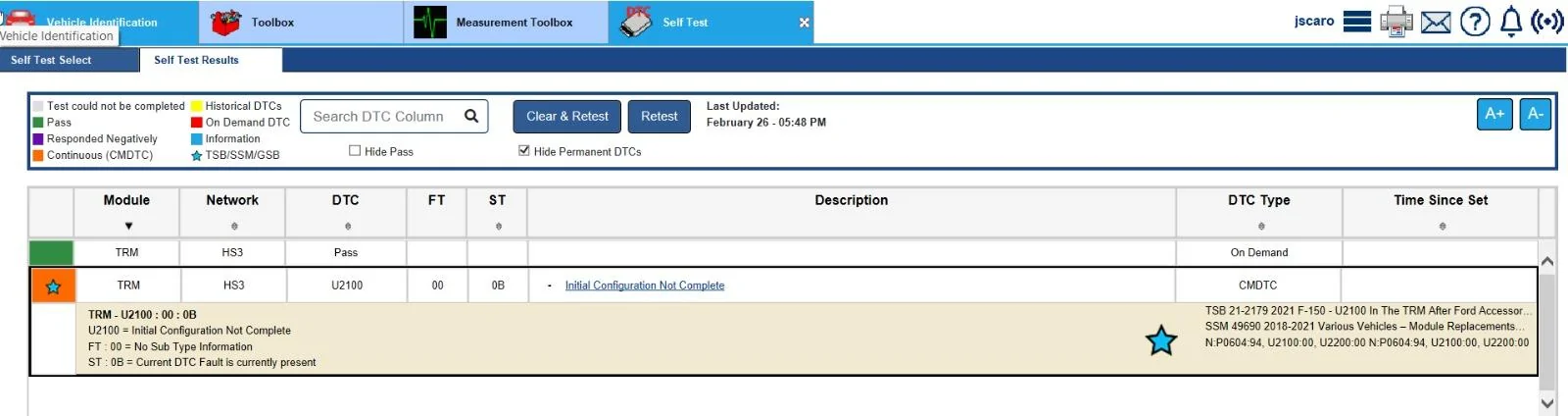

Well making headway now. Got some updates done but of course can't get rid of the GSM update and the APIM won't kick start from USB.

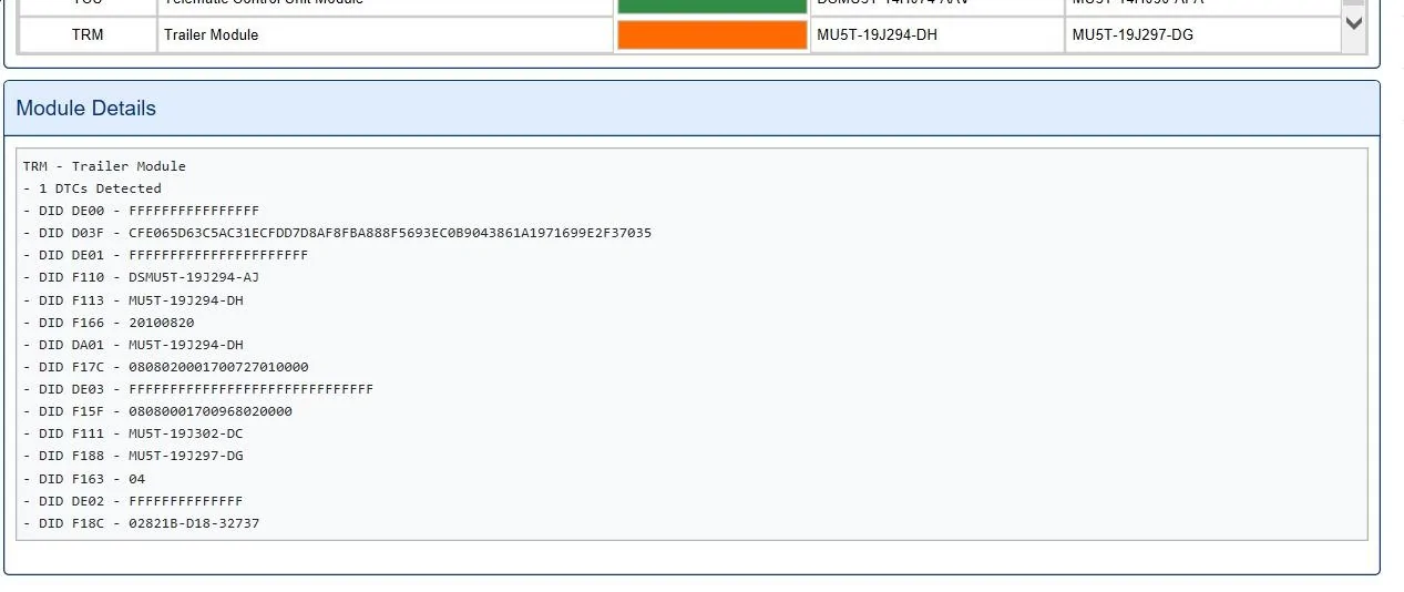

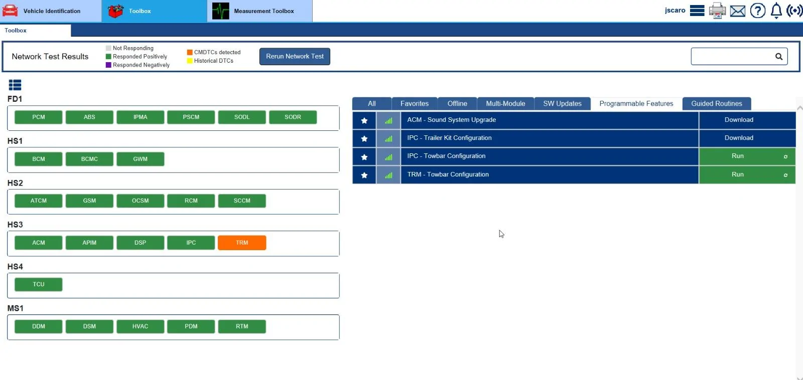

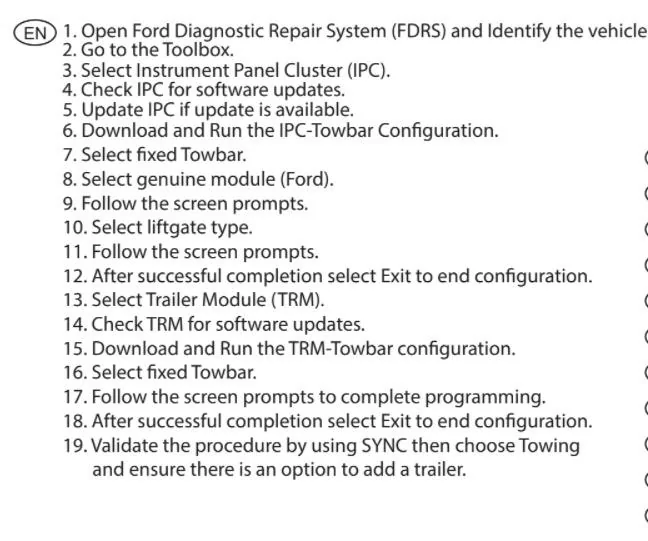

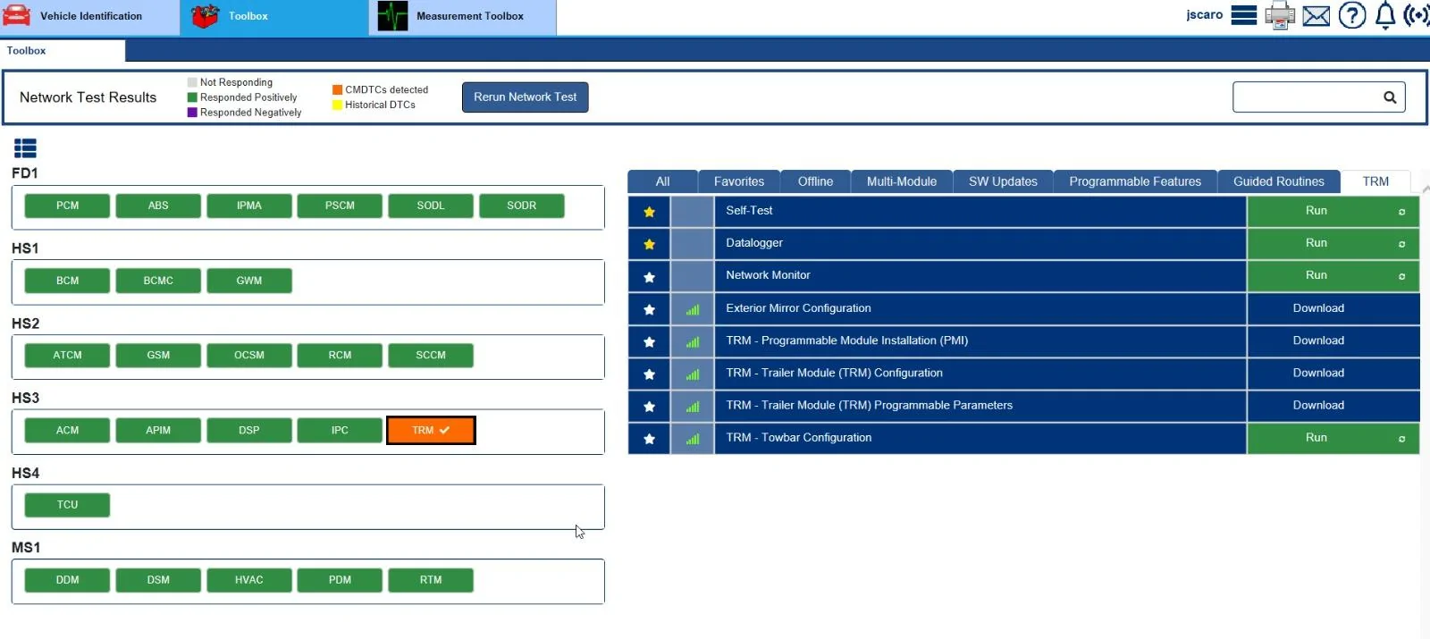

Now I need to work on my TRM DTC. My truck didn't come with the controller but I added it and had Ford program it - well thought they did. It has a DTC and I'm attaching some screen shots. I have the PDF with the steps to program it through FDRS but that didn't take care of the DTC.
Any Advice on which ones to proceed with?

While in the toolbox click the All tab then click on TDM on the left side you should see a new tab show with TRM as it's label now click on TRM - Programmable Module Installation (PMI) then Download and run. Go through the prompts as if you already installed a new module and report back if that cleared your DTC
The GSM will not go away... disregard it as it appears to be a bug

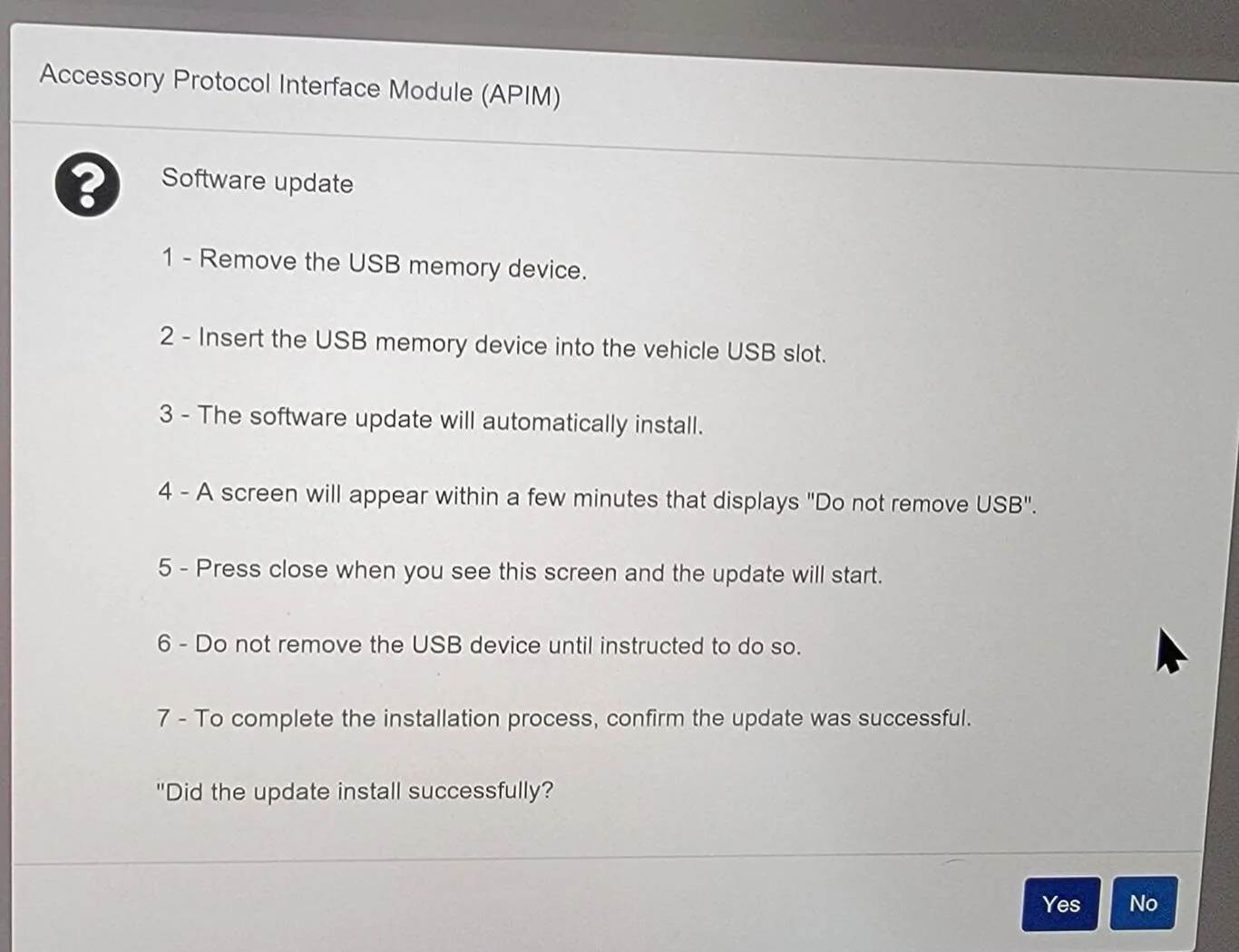

Anyone feeling like they have no choice but to update the IPC using the bus instead of the USB should try ONE other thing first.
The USB routine is much like the other USB updates and will begin by FDRS downloading the necessary update files to the USB stick. Then you are prompted with the SAME FDRS USB screen prompt that FDRS always prompts with :
Ford F-150 Lightning ECU module programming guide using FDRS 20220218_133639
I believe that for this particular IPC USB update, that screen is possibly an inaccurate depiction of the proper routine. I say that because I believe that the screen above can only be accurate if the truck performs the entire update process on its own with no assistance from FDRS.
In other words, the USB stick will be inserted, the onboard system trigger and will copy those files. Then the files will be acted upon (executed) by the onboard system independent of FDRS. In fact, notice that the FDRS prompt above ends with a question of whether the update was successful or not. That implies that YOU will know whether it was or not based on the Sync screen informing you that it was.
However, the IPC files on the USB stick trigger the onboard system to copy the files (exactly like the APIM and TCU) and the progress bar on the Sync screen shows that it completes. But that's it. Nothing else ever happens. No "restart truck"..... Nothing.
If you leave the USB stick in and restart the truck just because you think maybe it will do something (because other updates included that routine) you will find that nothing happens except the ordinary detection and indexing of the USB stick.
But, if you return to FDRS and click "Yes" on the standard instruction screen, FDRS immediately runs a verification of the files that are related to the IPC update and then EXECUTES the writing to blocks on the module.
In other words, unlike what that instruction prompt states, the truck does not prompt you to do anything, and certainly not say yes to FDRS to complete the update.
I suspect this is why some have answered NO and then chose to update via canbus because they think the update failed.
I think there is a considerable lack of consistency between how each update is constructed. Or at least FDRS doesn't have accurate screen prompts to accommodate subtle differences between updates that are not identical in necessary routine.
Having said all this, maybe I just got lucky again? This is twice now that I didn't get stuck in a loop or dead end by deviating from FDRS or Sync screen prompts that resulted in failure

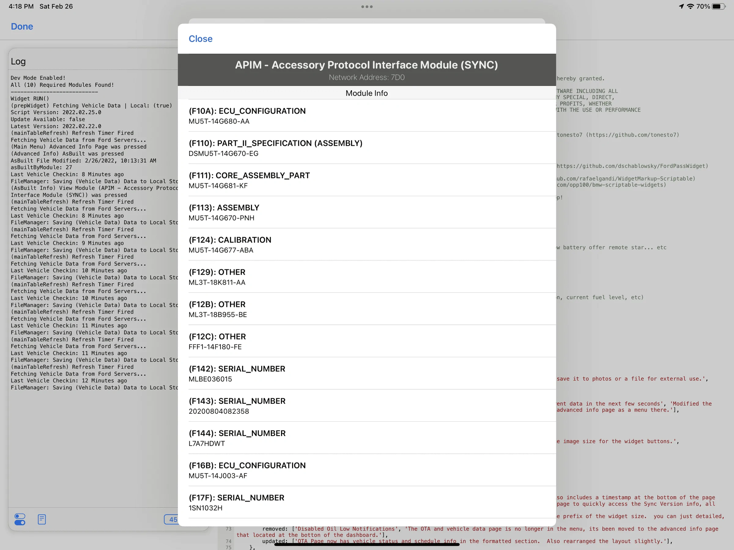

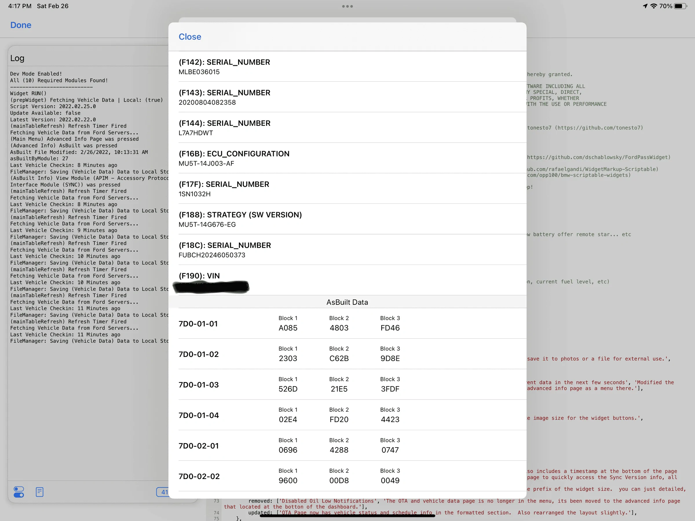

I agree. I think it's more related to the speed of the VCX Nano. My UCDS adapter hasn't had the corruption others have. I only have the ML3T- the part number in the Sync Module.
My data is back to looking good again. My truck must have sent in the latest data.
I just tried out your new widget to check my “as-built” data. Thanks for this valuable update. But it raises even more questions. Are you sure your data is now uncorrupted, even for the APIM? It looks good as far as it goes. But my APIM data is showing, among other things, an “unknown node” at (F12A) and missing parts of the strategy code: ML3T- 6-BJ. You have no (F12A) node at all. There might be other differences as well—I still have corruptions so it’s hard to parse.
