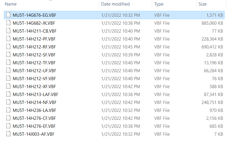

I scanned but only ended up with
As you know, those two updates are there even if you have already applied them. (twice ?)

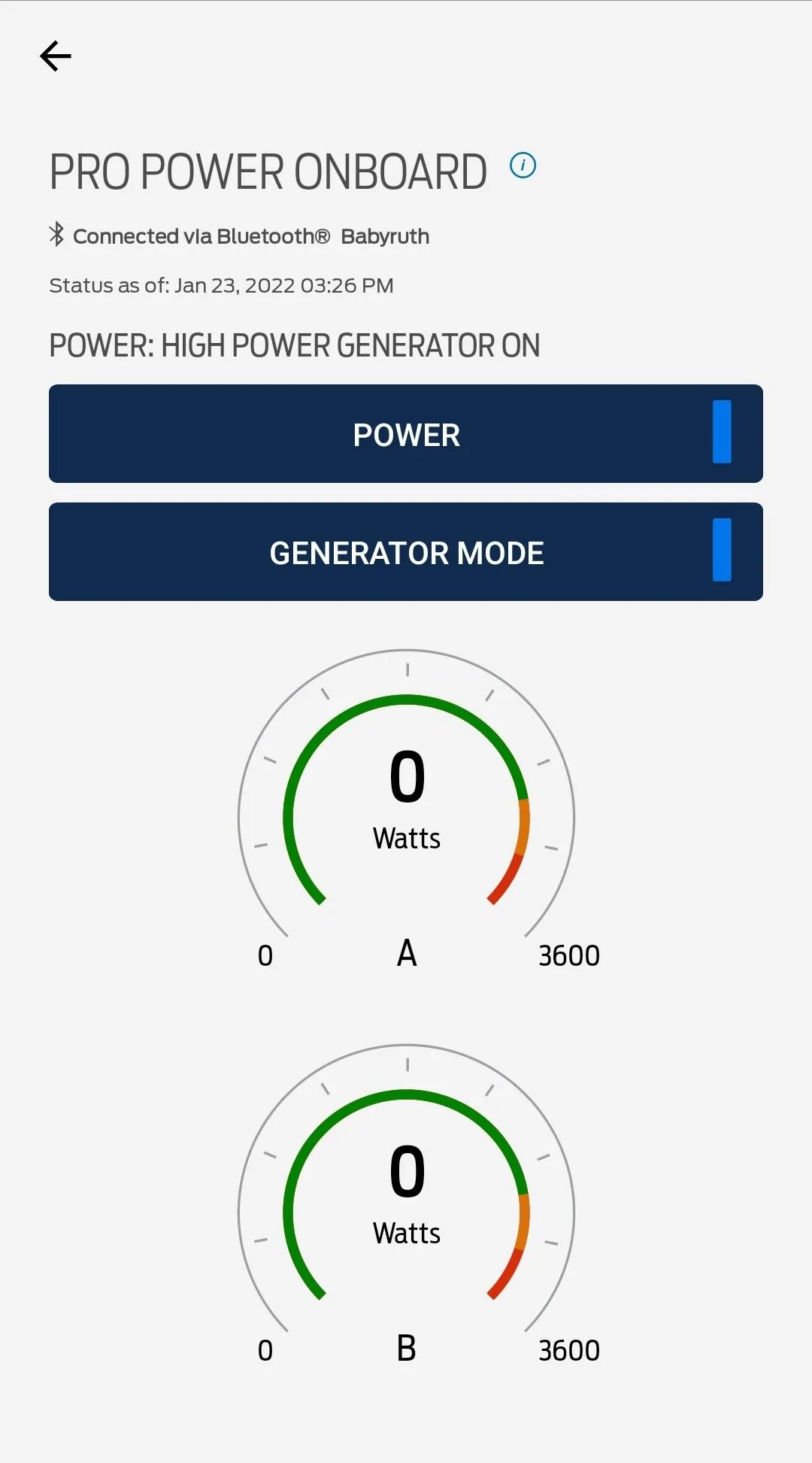

By the way, guess what showed up today?
Ford F-150 Lightning ECU module programming guide using FDRS Screenshot_20220123-152628_FordPass
THIS is what I REALLY wanted!
Everything else was icing on the cake.
I'm a happy old man with all his "stuff" working now.
Cool! Glad Pro Power Bluetooth control finally showed up for you.

Yup I have the same, GSM won’t clear on FDRS as well under the SWupdates tab. Installed it multiple times.

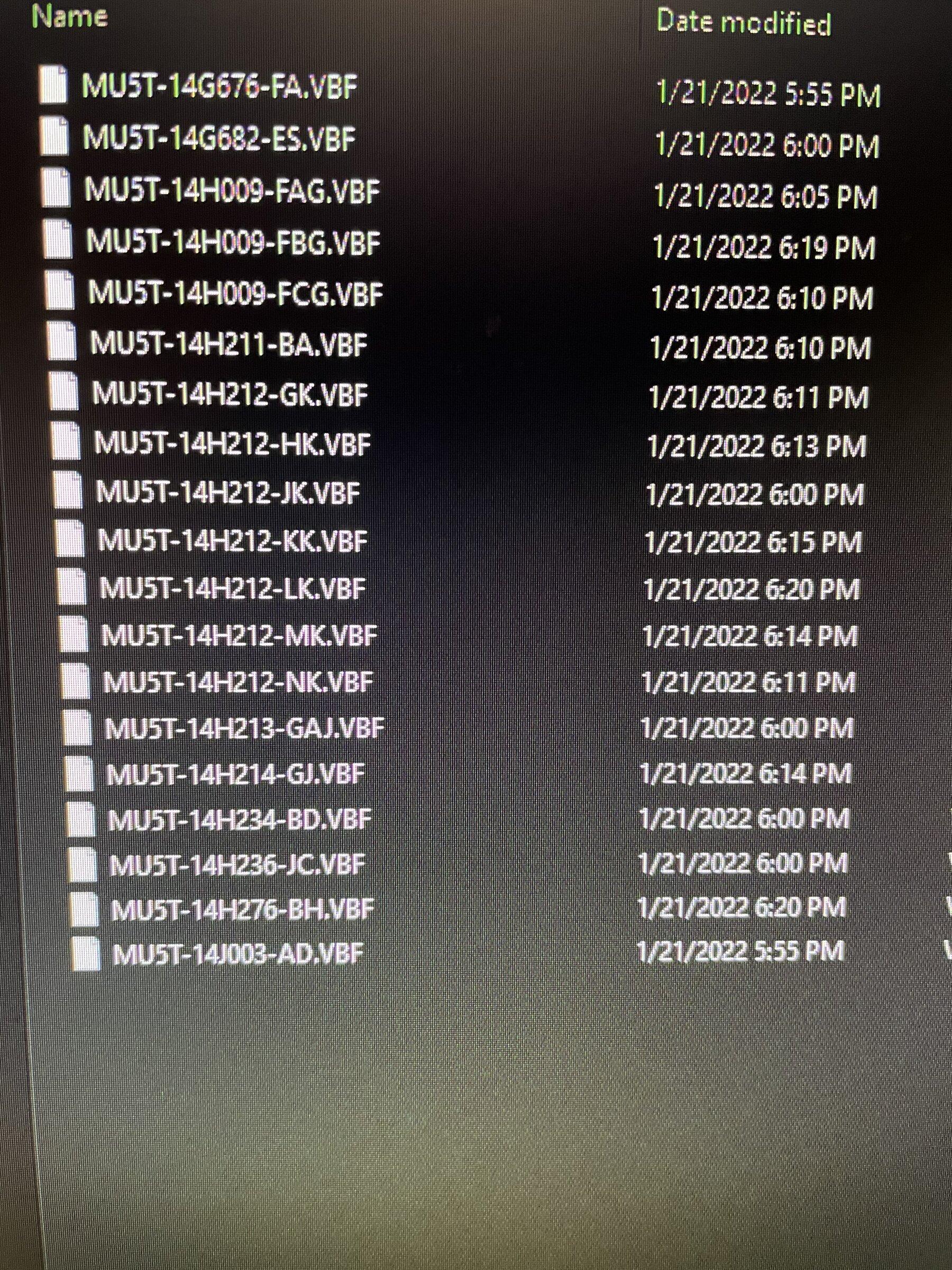

One question I do have is within FDRS my APIM update won’t run either… nothing displays on the screen… not even the “Do Not Remove the USB” warning screen your supposed to get. Not even after 1 hour of the vehicle running.
I did get update 1.6, then 1.4 automatically via the FordPass app notification about a month ago. I believe the 1.7.1 failure applies to me with not being able to select auto update or schedule updates etc.
What were the file names in your USB key made from FDRS? Mine have “14” in the name. Is this supposed to reference like ver. 1.4 in all of them??

Ya, my update package ended up being about 3.8GB.

Ya, my update package ended up being a little over 4GB.
That would be 21146 rev145 (or OTA 1.7.1 equivalent). In my opinion, this is the hardest obstacle, to get this APIM update kick off. Once this update installs, its easy-breeze to install any subsequent updates
