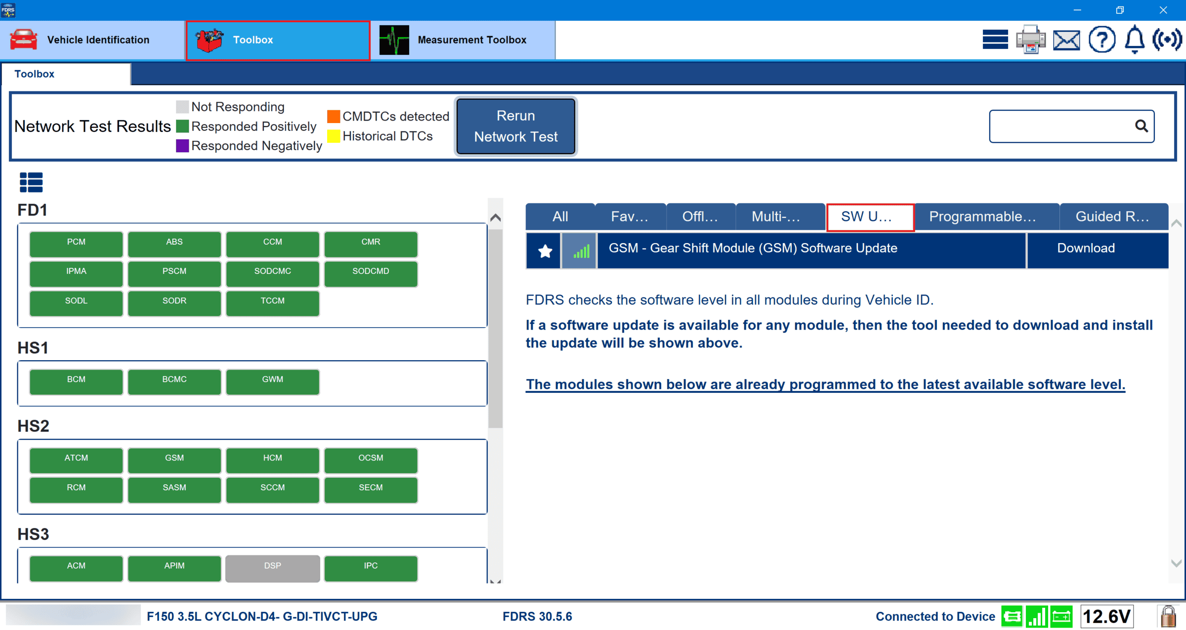

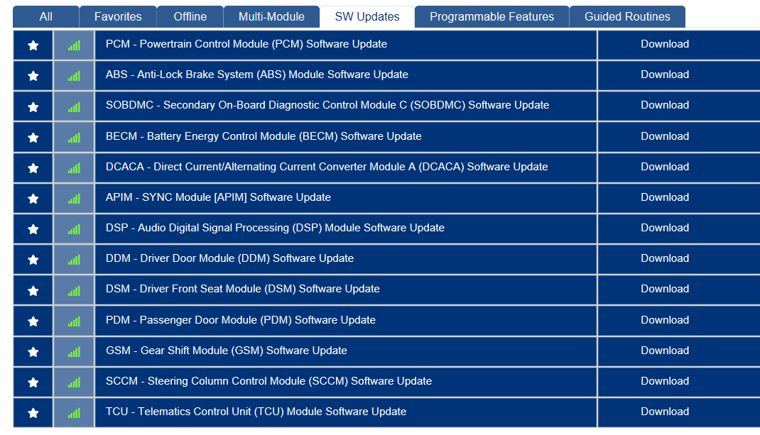

Here is a list of the first scan of my truck and the list of updates it was eligible for after reading the 40 modules.
Note that list does not even represent updates that become eligible AFTER you perform the listed updates!

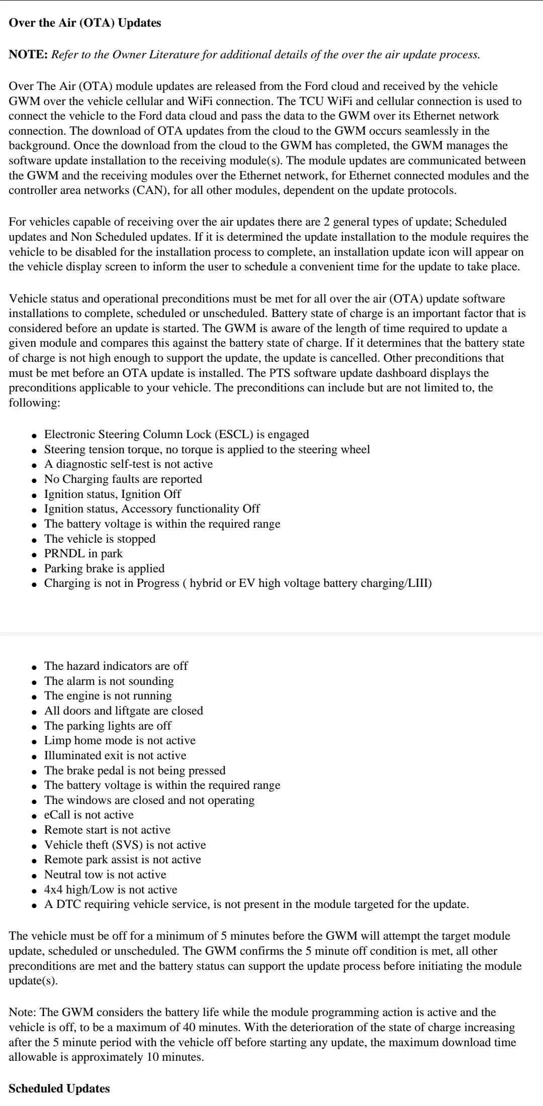

One thing to also know is OTA is limited to the modules on the ethernet. So other modules also have updates that are not even apart of the OTA.
This is another reason why its important to keep the truck up to date. Especially for job 1 trucks and early build trucks.
Ahhhh. That explains that!
I have the factory service manual. I suppose it will clear up which modules are available over ethernet and which aren't?
What's amazing about that is how would a customer ever know that there is an update for the driver's seat module? (for example)
When I performed the update it was obvious the module was being updated, but I have no way of knowing what the update actually addressed? Lol

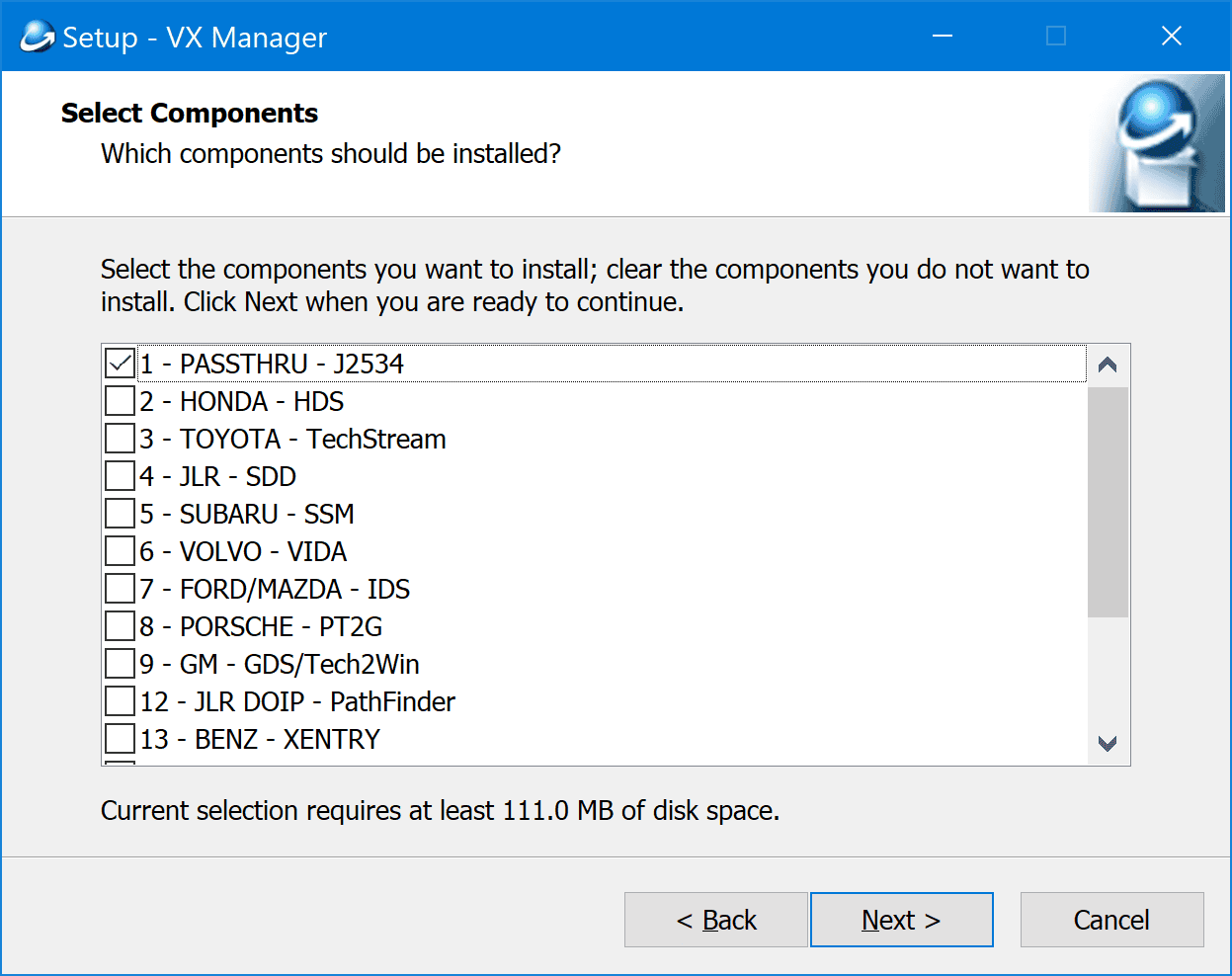

Tools you will need:
- Windows PC with 4GB RAM or greater, running Windows 10 natively (Macs running Windows bootcamp or other VM based solutions are known to cause issues)

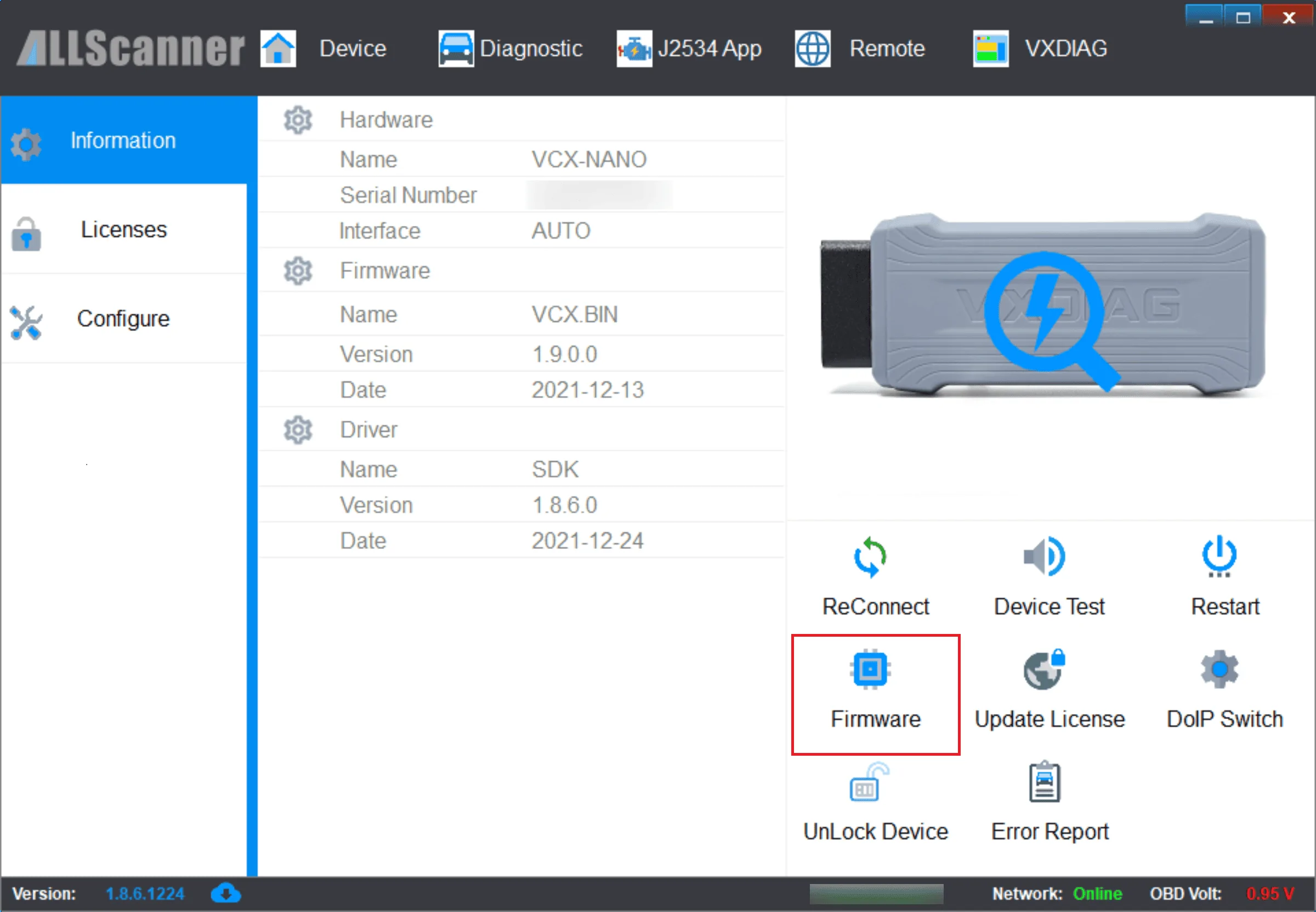

- VXDIAG VCX Nano interface (can be purchased from Amazon here)
- USB Flash drive 32GB or larger (must be formatted to exFAT)
- 12V Automotive Battery Charger/Maintainer (I used this one from Amazon)
Software you will need:
- VX Manager (installs driver for your VXDIAG VCX Nano device)
- Ford Diagnostic & Repair Software (commonly known as FDRS)
Software installation (step-by-step):
1) Download the latest VX Manager installer from here
2) Start VX Manager installation, when prompted select PASSTHROUGH - J2534
DO NOT SELECT FORD/MAZDA - IDS. Using this IDS emulation can brick your ECU during the update process (learned the hard way)
3) Connect VCX Nano device to your PC using the supplied USB cable and launch VX Manager. The tool should recognize the device. If there is a device firmware available, update the device firmware

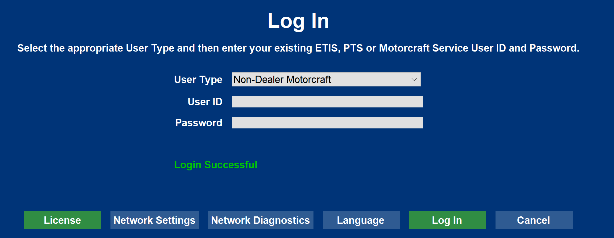

4) Download and install FDRS software from here. You will need a license to run this software and can be purchased here (2-day FDRS license cost $50)
5) Launch FDRS, you will be prompted to enter the license that you have just purchased. Login using your credentials created on Motorcraft website. Make sure you select Non-Dealer Motorcraft as User Type

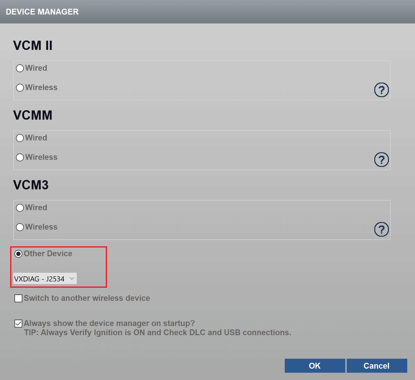

6) Connect your VXC Nano device to your truck's ODBII port and connect the USB cable to the PC running FDRS. Once FDRS Device Manager pops up, make sure you select Other Device, in the drop-down dialog select VXDIAG - J2534.

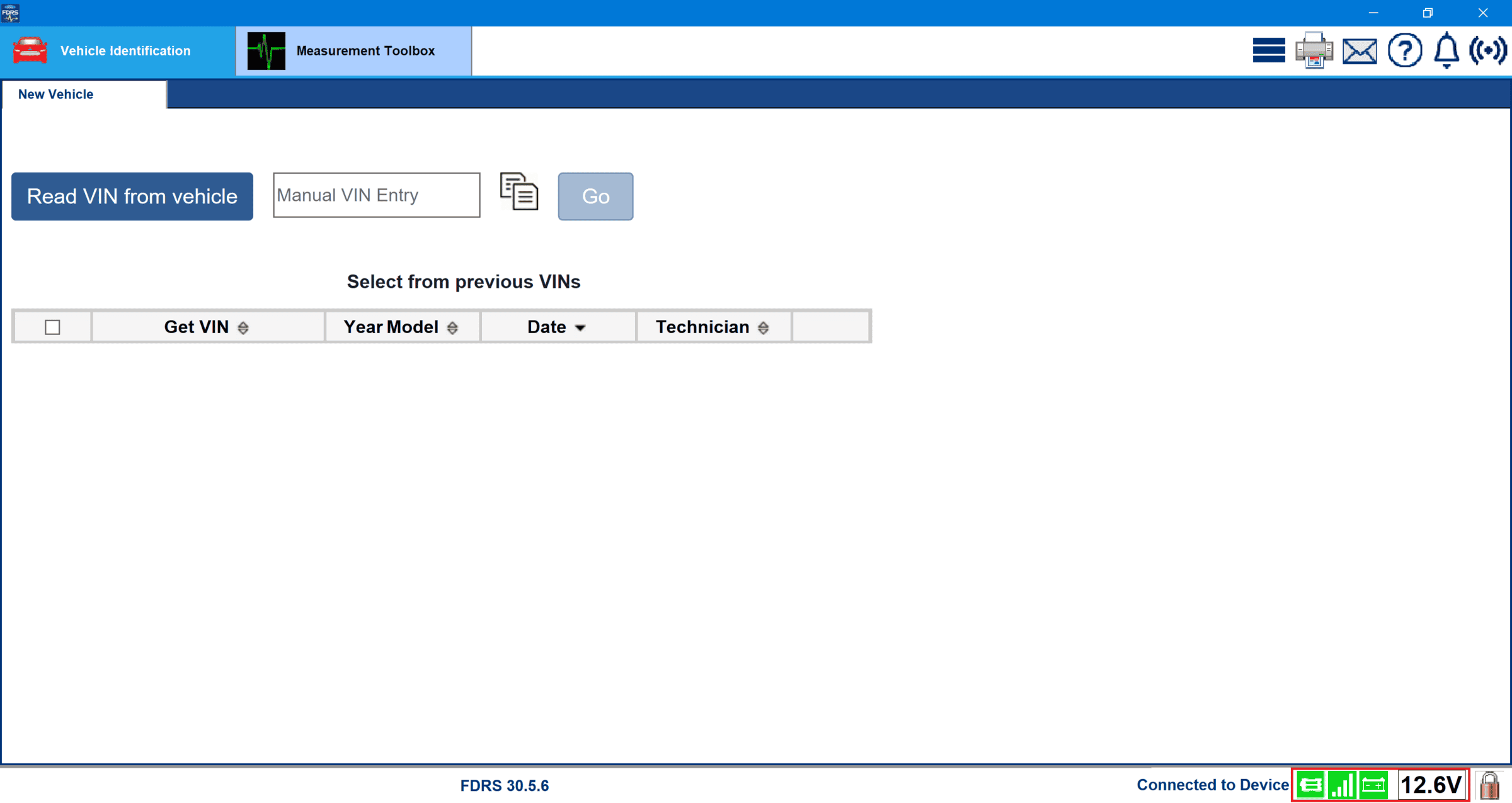

After this you should be greeted with this screen, meaning you are ready to go!
The icons at the bottom should be all green with battery voltage shown
Running Network Test (Intial Scan)
1) Turn Ignition On, Engine Off
2) Click Read VIN from vehicle
3) Click Go to initiate Network Scan
Once completed a new tab called Toolbox will appear at the top of your FDRS screen:
On the left hand side you will see all modules detected on your truck. The ones that responded positively will be marked green. On the right hand side notice the SW Updates tab. Head over here to see all available SW updates for your modules.

1) Head over to SW Updates tab in the FDRS Toolbox window.
2) If there are updates available, hit the Download button. The tool will download the necessary tools needed for the module update.
3) Once download completes the button turns green with a text "Run".

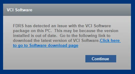

Thanks for the detailed write-up. I do have one question. When I launch FDRS, I receive this pop-up regarding an out-of-date VCI update. Do you suggest that you continue through the message or click the link to install the software from Ford's website? @iceman77
Ford F-150 Lightning ECU module programming guide using FDRS Screenshot 2022-01-24 165725
I skipped the suggestion the first attempt, but FRDS failed to work.
The second time I downloaded the VCI software and installed it. FRDS was functional and really stable afterwards.
I don't know if any typical user is going to have a computer already prepared to run FRDS without the VCI software.
